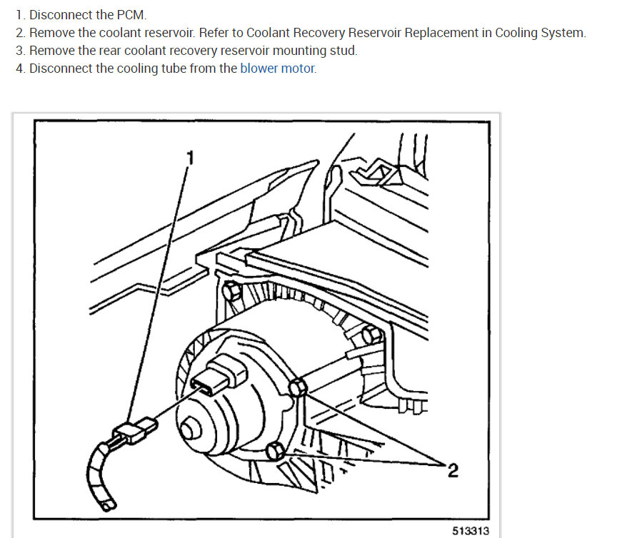

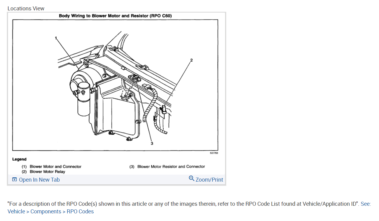

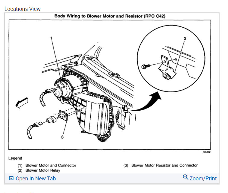

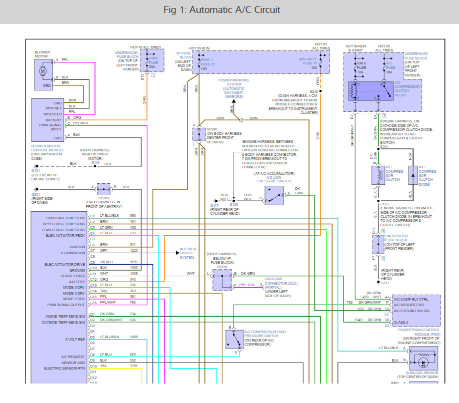

My heater blower stopped working today. I went to Auto Zone who sold me a Heater Blower Relay but there isn't a place in the fuse boxes for this relay. The relay looks like it attaches to something like maybe on the firewall but I can't figure out where. I see nothing in the box or the fire wall that resembles the relay I was sold.
If anyone has any suggestions, please let me know.Thanks
Feb 22, 2008 at 10:09 AM
BMRFIXIT
  • 19,053 POSTS

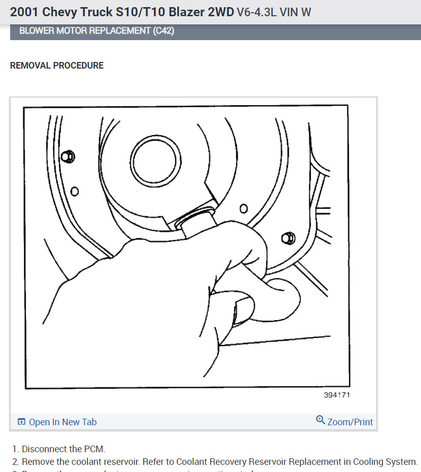

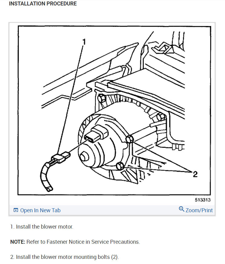

did you check the fuses also check the motor and the wires around it tap on the motor. This guide will help you test the motor here is a guide as well to check the relay with the relay location in the diagrams below.
and
https://www.2carpros.com/articles/blower-fan-motor-works-on-high-speed-only

Did you check for voltage at the blower connector, with everything turned on? Did you check hvac fuses?
The purple wire from the blower connector goes to the blower relay, according to my info. I don't have an exact location for the relay, sorry.

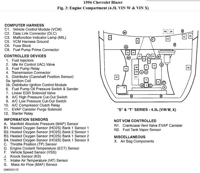

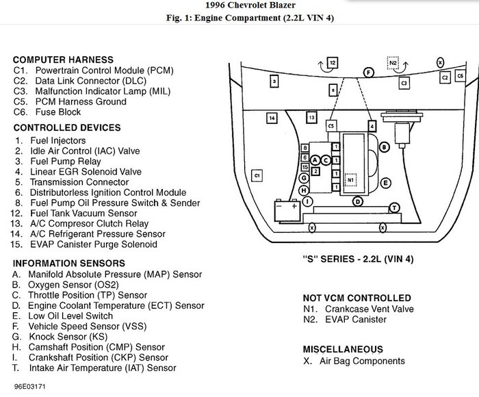

DRCRANKNWRENCH
  • 3,380 POSTS
The ralay might be bad as well. If you check the fuse and it is good, the relay may need to be replaced. It is located at the center rear of the engine compartment.
The fuse box is located on the leaft side of the dash. The cover should have a diagram on it mapping out the location with a description of the fuses in the panel. It is somethimes hard to orient this diagram, so make sure you have it right by using the spare fuses or large relays as landmarks to orient the diagram in relation the the fuse location.
I am giving you 2 diagrams. They are electrical component location diagrams and show the fuse panel, but I did not see the relay represented. One is for a 2.2L and the othe is for the 3L.
They are labeld at the top when you click on them you will be able to see this.
They both have the fuse panel in the same place, but I figured you might be able to use them for other purposes or just to have them.
If you need anything else, please don't hesitate and I will reply ASAP.

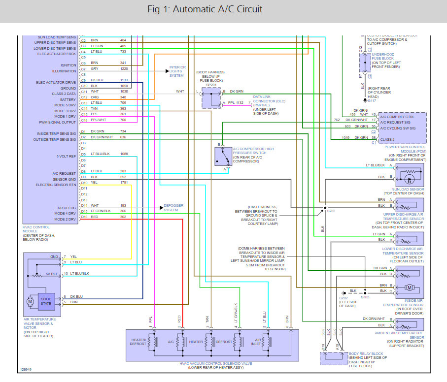

I can get the blower to run by splicing the purple wire on relay harness from positive on battery buy fan will not run without it. Replaced the resistor and nothing. Any recommendations?
Jan 8, 2023 at 6:24 AM
  • 55,423 POSTS
Can you check the HVAC fuse in the under-hood fuse panel for power?
Here is a guide to help and the blower motor wiring diagrams so you can see how the system works:
Jan 8, 2023 at 9:56 AM
