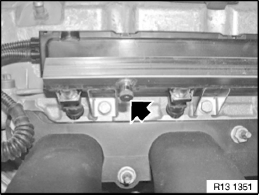

Here are the specific directions for testing fuel pressure. The attached pictures correlate with the directions.
CHECKING FUEL PUMP DELIVERY PRESSURE
13 31 029 - Checking fuel pump delivery pressure (N52)
pic 1

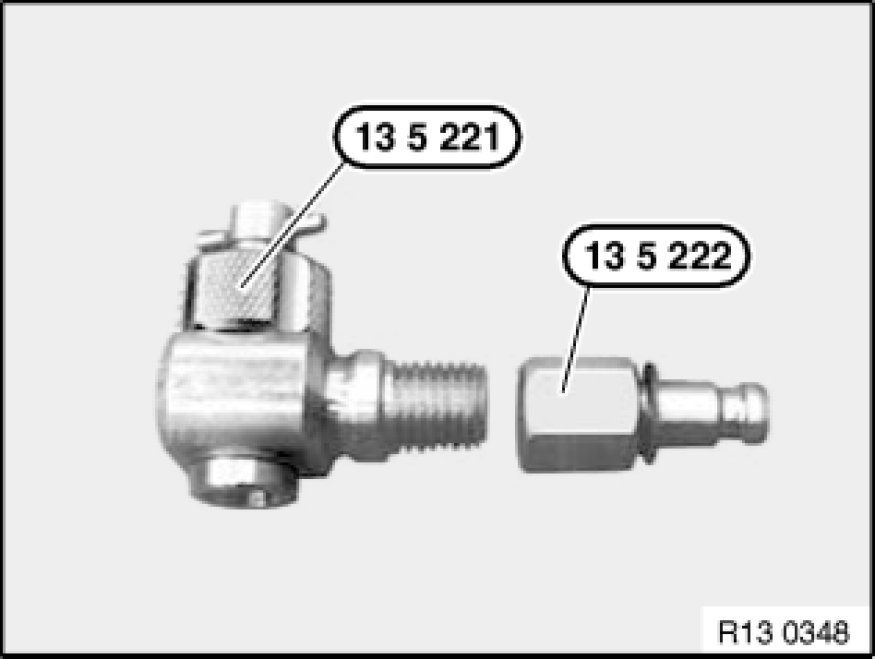

Special tools required:
- 13 5 220
- 13 5 221
- 13 5 222
pic 2

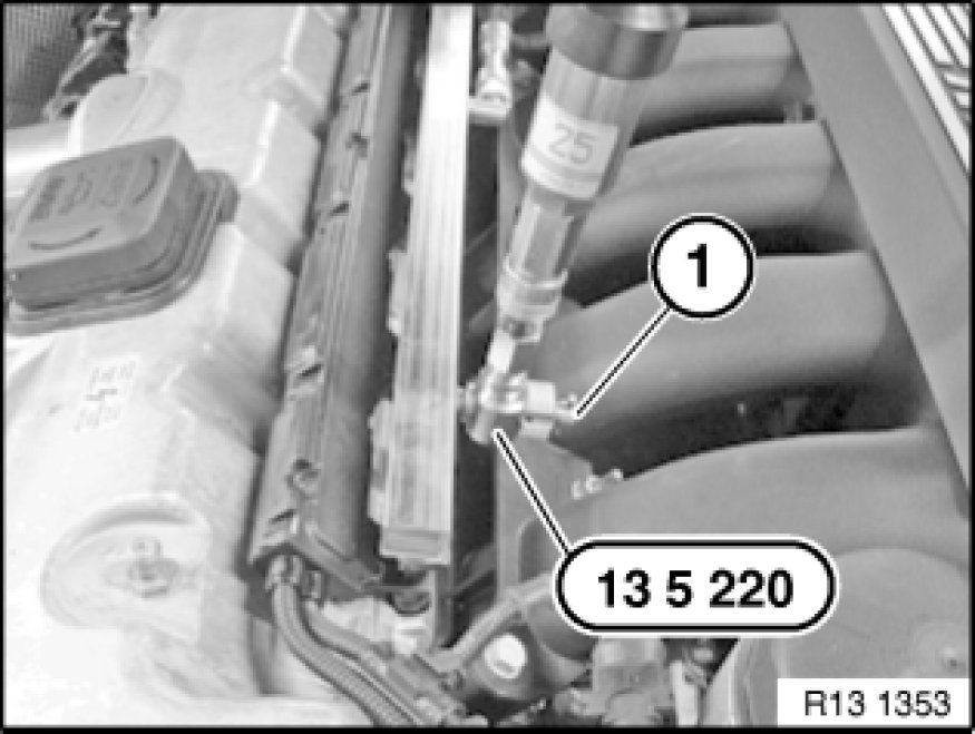

pic 3
Necessary preliminary tasks:
- Switch off ignition.
- Remove acoustic cover See: Engine > Removal and Replacement > 11 00 ... Removing and Installing/Replacing Acoustic Cover
pic 4
Remove dust cap (1).
pic 5
Connect special tool kit 13 5 220 (comprising 13 5 221 and 13 5 222) to pressure sensor of DIS Tester.
Connect pressure sensor to DIS Tester.

pic 7
Mount special tool kit 13 5 220 to injection tube and tighten knurled nut hand-tight.
Screw out check valve (1) so that valve in pressure regulator housing is closed.
Start engine.
Screw in check valve (1) until a pressure reading is indicated on DIS Tester.

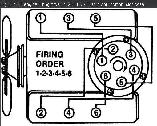

What is the correct spark wire sequence to this chevy.
Friday, May 14th, 2021 AT 12:35 PM (Merged)
BLUELIGHTNIN6
  • 16,542 POSTS
https://www.2carpros.com/forum/automotive_pictures/261618_Graphic_187.jpg

When I start the truck it started to back fires and shakes real bad and turns off I think my spark plugs wires are placed wrong. Or my have the firing order wrong some one place help
CJ MEDEVAC
  • 11,005 POSTS
Remember # one's position on the distributor cap may vary depending on how you install the distributor
Wherever #1 winds up---that is the starting point for the sequence

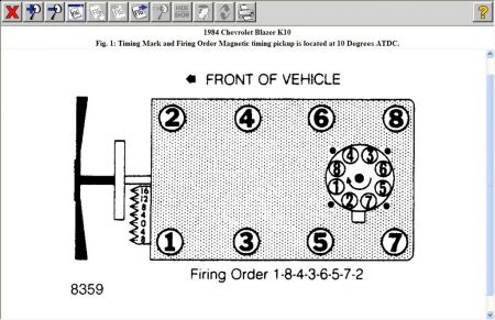

I need the spark plug wiring diagram for this blazer. Having trouble with misfire after instling new wires. Need to make sure wires are put back correctly.
  • 75,992 POSTS
Here you go
https://www.2carpros.com/forum/automotive_pictures/12900_fo_blazer_1.jpg
