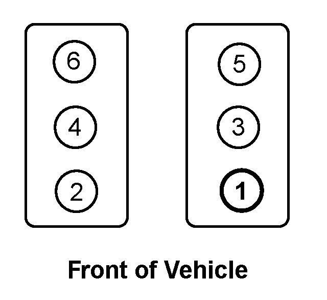

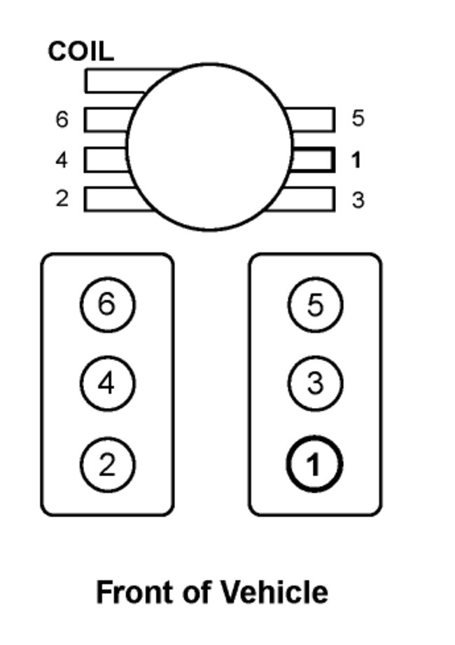

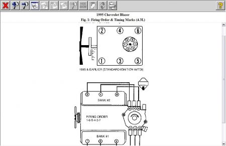

I need the spark plug wiring diagram for this vehicle. having trouble with misfire after installing new wires. need to make sure wires are put back correctly.
Feb 20, 2009 at 3:14 AM
  • 55,399 POSTS
Hello, my information showed this for the 2000-4.3-vin X and K. Firing Order 1-6-5-4-3-2
https://images.2carpros.com/forum/automotive_pictures/170934_chevy_blazer_1.jpg
Please let us know if you need anything else to get the problem fixed. Cheers, Ken

https://images.2carpros.com/forum/automotive_pictures/170934_firing_order_1.jpg
The info showed this for the 4.3.
May 14, 2021 at 5:34 AM (Merged)

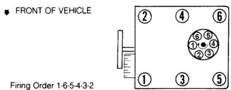

MWILDER75
what is the number 1 position on distributer cap?
  • 75,992 POSTS
At 5 O clock position-see below
WRENCHTECH
  • 20,761 POSTS
This picture might be easier to read.
MWILDER75
Thank You for your help this worked

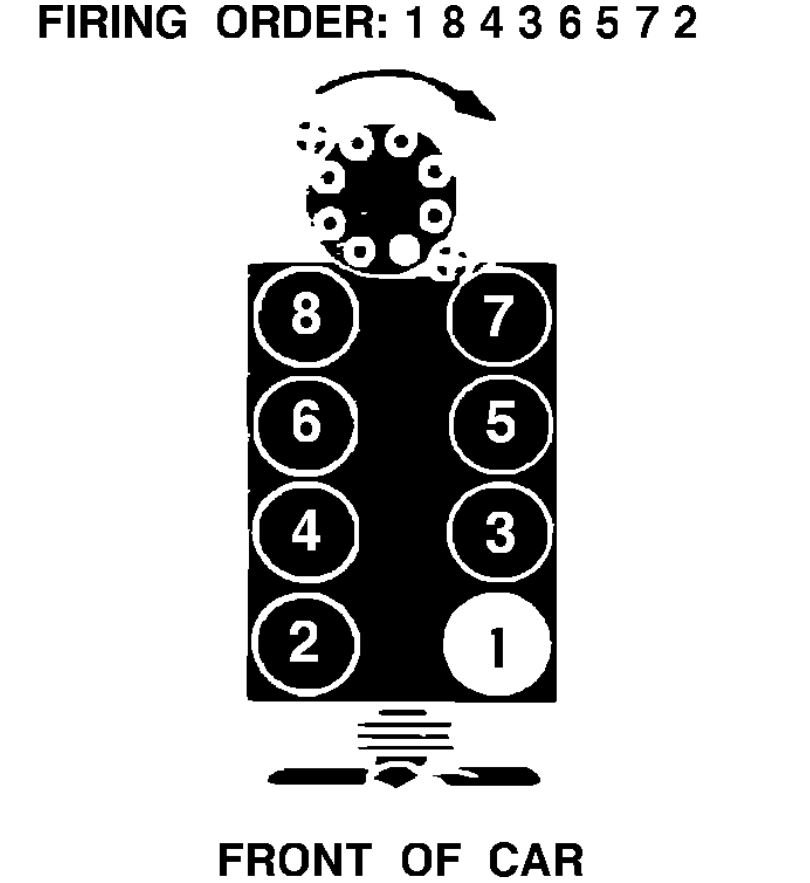

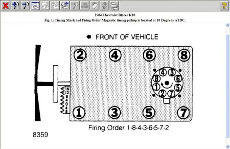

I changed spark plug cables and distributor cap and think I have them installed in the wrong order ?
HMAC300
  • 48,601 POSTS
Here is the ignition system firing order for your truck 1-8-4-3-6-5-7-2 pic included. Check out the diagrams (Below). Please let us know if you need anything else to get the problem fixed.

BRYANTD
what's the firing order for a 1992 chevy s10 blazer 4.3
  • 55,399 POSTS
Firing Order .................... 1-6-5-4-3-2 . Please let us know if you need anything else to get the problem fixed.

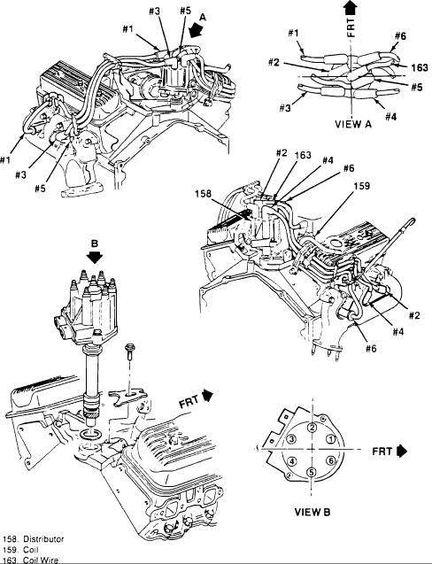

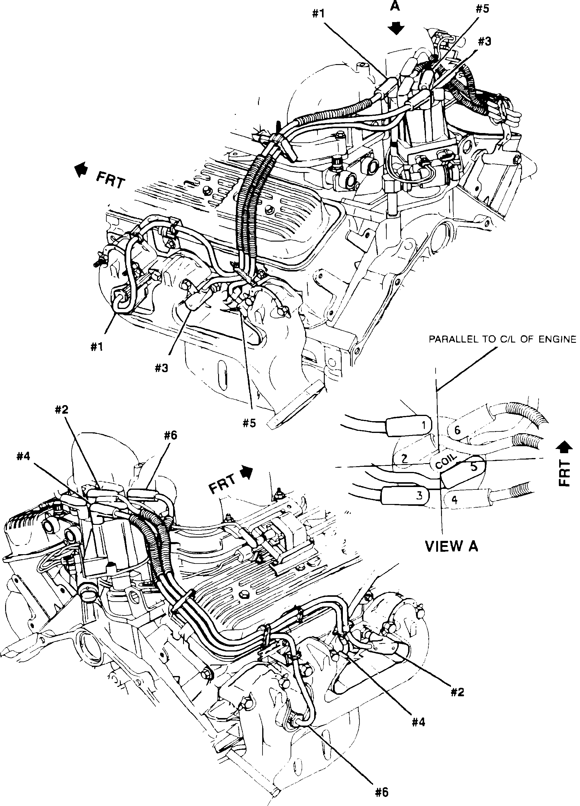

REDLOVER8
my father passed away a few years ago and left his jeep in the garage. it doesnt run. it turns over but wont start. i am getting fuel and air so my next area to look is spark. he put a 4.3L from a '93 chevy blazer into it. it has a tbi but i dont know if that came with the engine or not. i have searched the internet and found some websites for other year engines. but i would like to know for that specific year where the spark plug wires go. basically what terminal on the distributor attaches to what spark plug. thank you for your time. Josh.
May 14, 2021 at 5:35 AM (Merged)
JDL
  • 16,098 POSTS
https://images.2carpros.com/forum/automotive_pictures/170934_chevy_blazer_2.jpg
Hello, I came across the above picture. I'm not sure I trust pictures? You can put the number one cylinder on tdc of compression stroke, then whichever coil tower the rotor is pointing at or leading into, is the number 1 tower, you can see the firing order and direction of rotation on the cap. Did this vehicle run after the engine change-over?

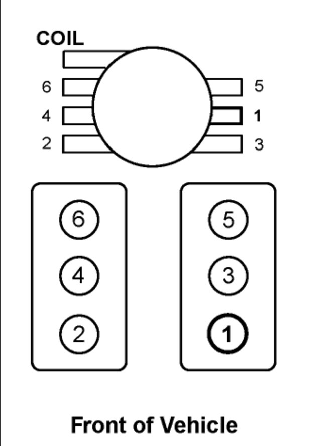

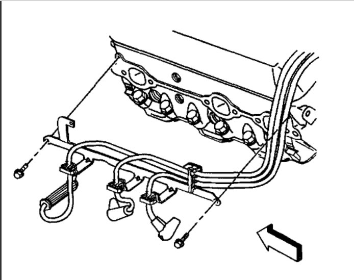

BRYANTD

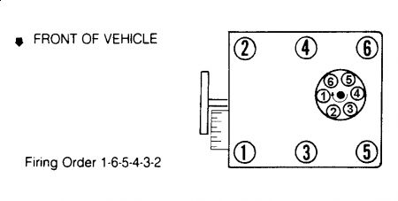

Just did a tune up and can't remember the firing order on my vehicle. any help would be much appreciated.
  • 110,240 POSTS
Welcome to 2CarPros.
Not a problem. Here is the firing order:
IGNITION FIRING ORDER
The attached picture shows cylinder location.
Picture 2 shows wire routing and if you look at the distributor, it indicates which wire goes to each cylinder.
BRYANTD
thanks for the help it worked

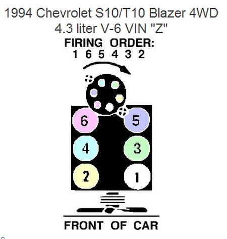

What is the correct spark wire sequence to this chevy.
BLUELIGHTNIN6
  • 16,542 POSTS
https://images.2carpros.com/forum/automotive_pictures/261618_Graphic_187.jpg

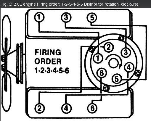

I need the spark plug wiring diagram for this blazer. having trouble with misfire after instling new wires. need to make sure wires are put back correctly.
  • 75,992 POSTS
Here you go
https://images.2carpros.com/forum/automotive_pictures/12900_fo_blazer_1.jpg
