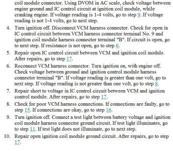

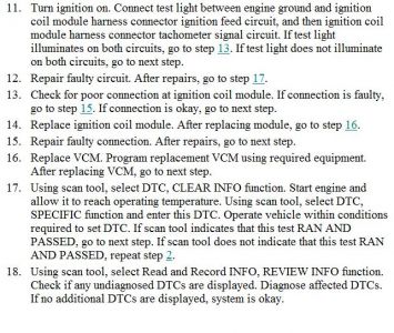

Here is the diagnostic for P1351. VCM is your computer. Prior to running the diagnostic, make sure that your crankshaft position sensor is in good order.

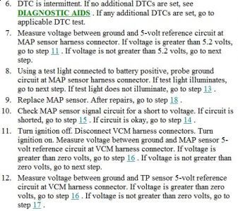

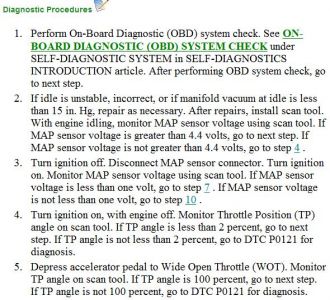

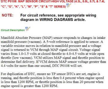

Diagnostic steps for P0108 is VERY similar to P1351. They both refer to the connection to the sensor from the VCM. Either the connection is intermittent (loose harness), poor, or no connection at all. High current means either no connection from the VCM or open circuit (broken wire). I would urge that you follow the diagnostic steps one by one. be sure that you have a good digital multimeter for the process.

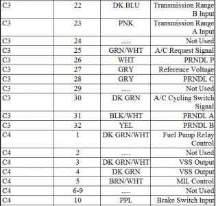

I also checked the wires from the crankshaft postion sensor. The input wire, number 31 the yellow wire is good, but the ground wire number 28 has infinite resistance. Does this mean there is a problem with that wire and could it be my problem?

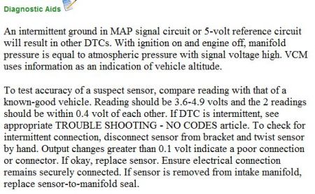

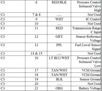

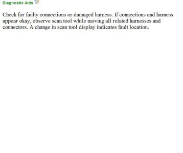

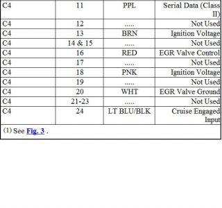

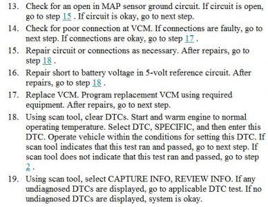

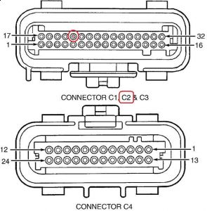

https://images.2carpros.com/forum/automotive_pictures/55316_99p1081_1.jpg
https://images.2carpros.com/forum/automotive_pictures/55316_99p1082_1.jpg
https://images.2carpros.com/forum/automotive_pictures/55316_99p1083_1.jpg
https://images.2carpros.com/forum/automotive_pictures/55316_99p1084_1.jpg
https://images.2carpros.com/forum/automotive_pictures/55316_99p1085_1.jpg
Apr 3, 2009 at 9:24 PM
JKHAMISTOS
  • 7 POSTS

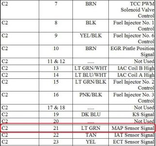

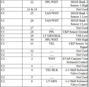

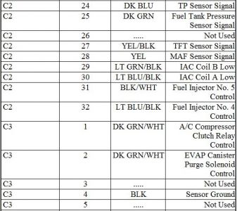

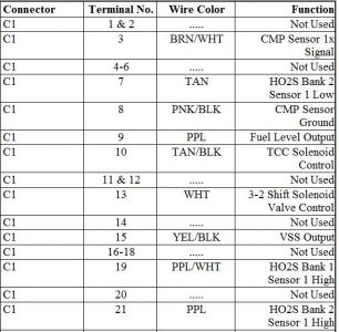

What color harness on the PCM is the MAP sensor wires located? And what number wire is it on the harness?
Apr 4, 2009 at 11:28 PM
ZACKMAN
  • 4,202 POSTS
https://images.2carpros.com/forum/automotive_pictures/55316_99blazerecm1_1.jpg
https://images.2carpros.com/forum/automotive_pictures/55316_99blazerecm2_1.jpg
https://images.2carpros.com/forum/automotive_pictures/55316_99blazerecm3_1.jpg
https://images.2carpros.com/forum/automotive_pictures/55316_99blazerecm4_1.jpg
https://images.2carpros.com/forum/automotive_pictures/55316_99blazerecm5_1.jpg
https://images.2carpros.com/forum/automotive_pictures/55316_99blazerecm6_1.jpg
https://images.2carpros.com/forum/automotive_pictures/55316_99blazerecm7_1.jpg
https://images.2carpros.com/forum/automotive_pictures/55316_99blazerecm8_1.jpg

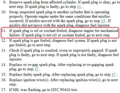

I can understand why the tech say not to replace the O2 sensor and cat. But based on the P0304 and P0306 diagnostics, if the CEL is blinking, there is a problem with the catalyst system. I cropped a part of the diagnostic.
https://images.2carpros.com/forum/automotive_pictures/55316_99blazerp0304_1.jpg
Step #11 bothers me a bit. When you replaced the head gaskets, did you do a compression test or a leak down test? Just to make sure the block isn't cracked. I had a similar problem with a Park Avenue right now. It turned out that the intake manifold is cracked.
