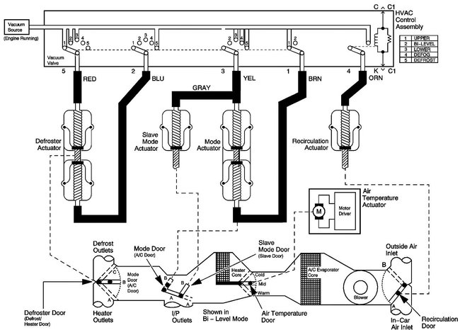

Does moving the mode control do anything? IE put it on defrost it switches to defrost or to the dash it blows out the dash? This is the vacuum line diagram, unfortunately it doesn't show the actual routing of the lines. Your description sounds like the main vacuum line is off but there are a few that can cause problems.

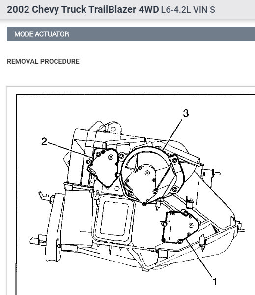

When I use my climate control switch and turn it on for the floor only I get heat coming from my vents more then the floor. Also, when I put it on defrost, very little blows to the windshield and I hear the compressor go on, which I know is good. I also replaced all of the vacuum lines under the hood, drivers side and even replaced the vacuum ball to make sure there was no leaks. I also looked under the drivers side to checked and seen that all the vacuum lines are okay and even replaced the whole climate control unit in the front dash. I am lost on this one. Many people say its the actuator by the heater box, which I know is very hard to replace. Could this be the problem?

Hello, I'm Danny.
It sounds like you are having an issue with the mode door actuator. Does your Blazer have the automatic or manual control? Get back to me when you can and I can send you instructions on how to replace. Thanks for using 2CarPros.

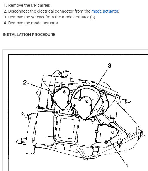

Hello again,

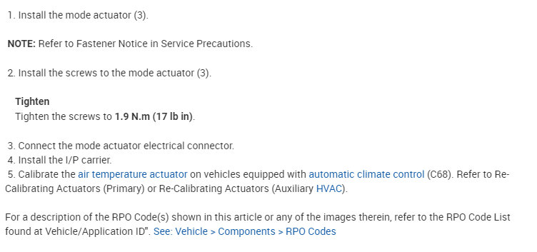

Here is a tutorial showing what is involved for the blend/mode actuator:
This is an electric motor that opens/closes to direct air flow through the proper ducts. I've attached step- by- step pictures below including the location on the HVAC box under the dash board.Hope this helps and thanks again for using 2CarPros.
Danny-

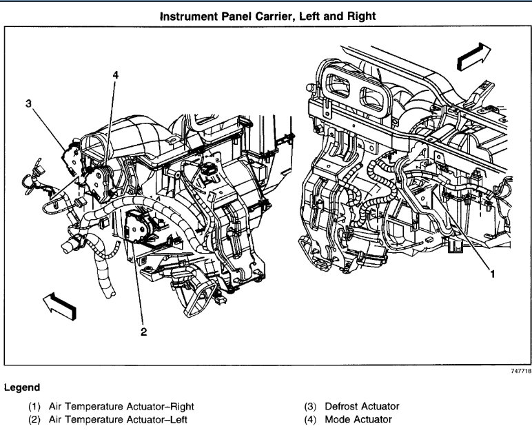

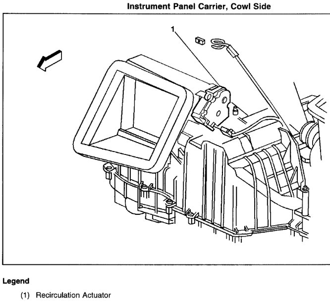

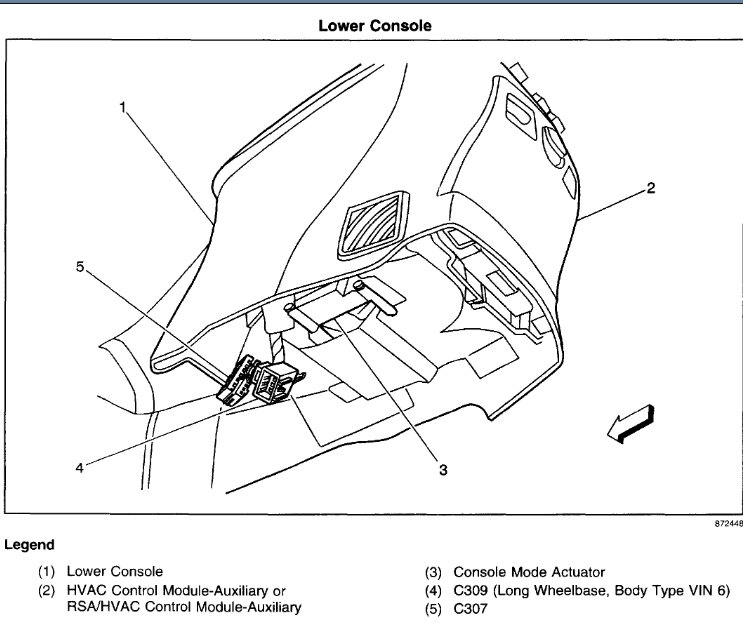

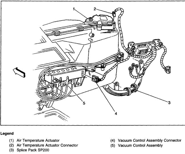

Danny, thanks for the information. Checked in the glove box area, and mind is in the back, looks like I have to pull the dash to get to it. Also, I see that it is facing up in mine, as I went to the junk yard and there was a dash already pulled out. This looks like it is going to be fun to do. The images you sent were for another vehicle not mind. Any ideas on how to get to the problem?

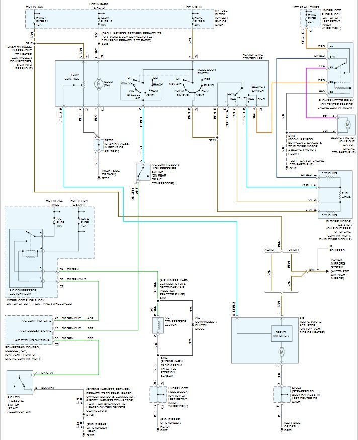

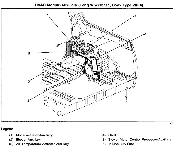

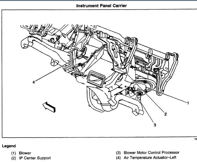

Hello again.
I attached the picture of the mode actuator prior which sounds like your problem. However, I'm attaching more pictures of your HVAC system so let me know if anything in the pictures are what you are talking about with the junkyard dash and I'll get back to you with more information. Hope this helps and thanks again for using 2CarPros.
Danny-
