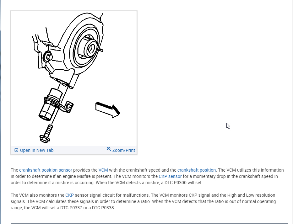

This could be a number of things. We need to check fuel and ignition. Assuming it was running well and compression is okay, fuel and ignition are the other two needed items.
Check for fuel by spraying starter fluid in the intake and see if it starts. If it still doesn't start then we most like have an ignition issue. Pull a plug and hold it against the block and crank the engine and see if it sparks.
If you have no spark then the crank sensor is the most likely cause. Let me know what you find and we can go from there. Thanks
