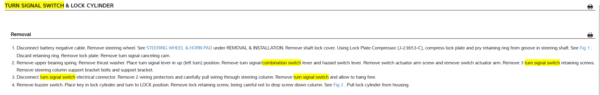

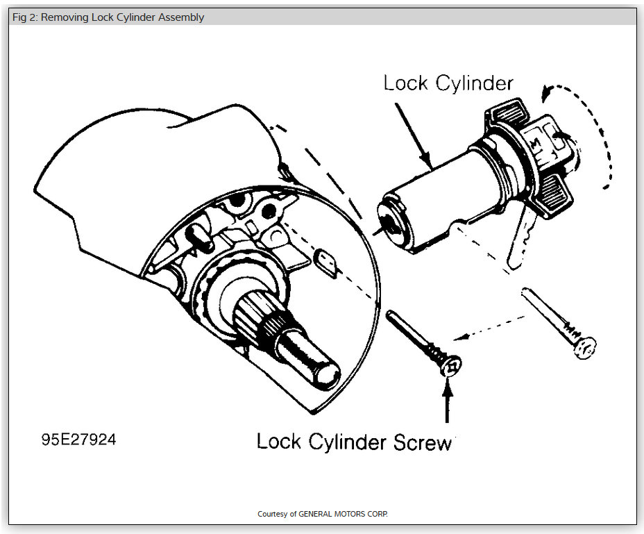

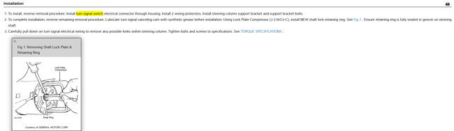

Turn signal switch is bad. How's the best way to proceed?
Jul 28, 2021 at 1:41 PM (Merged)
94 TRANSAM
  • 680 POSTS
Hi, welcome to 2CarPros.
Below you will find the steps to replace the turn signal switch. Check out the diagrams (Below). Please let us know if you need anything else to get the problem fixed.
Let me know if you need any more help.
Rich
