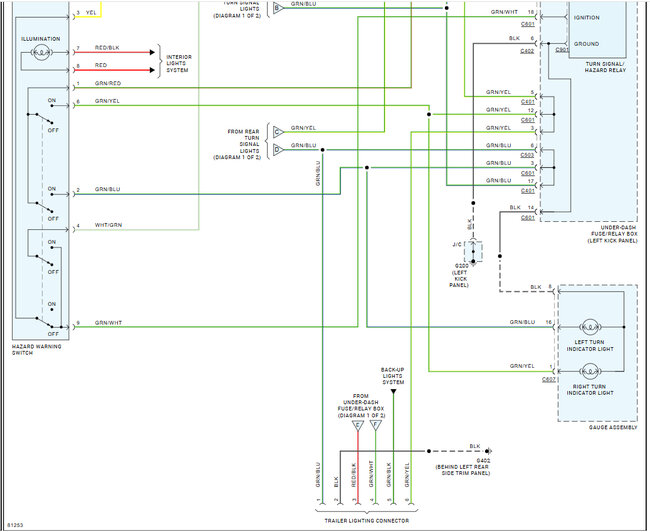

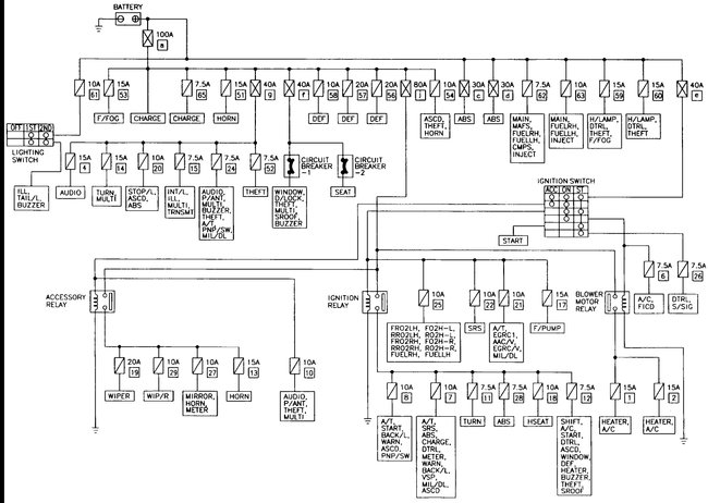

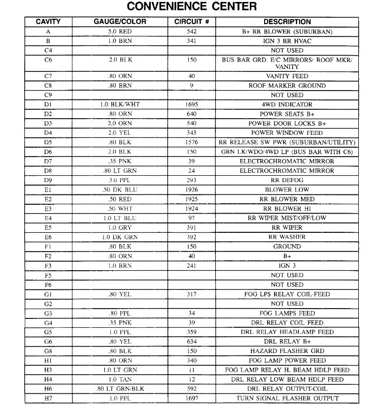

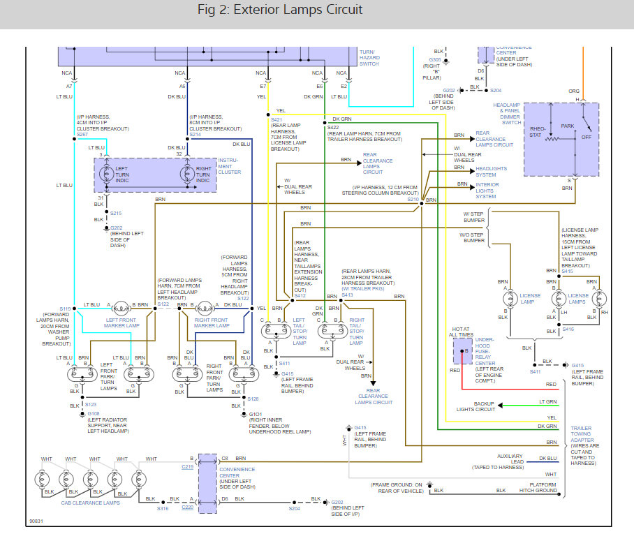

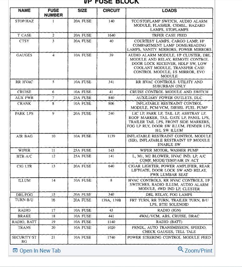

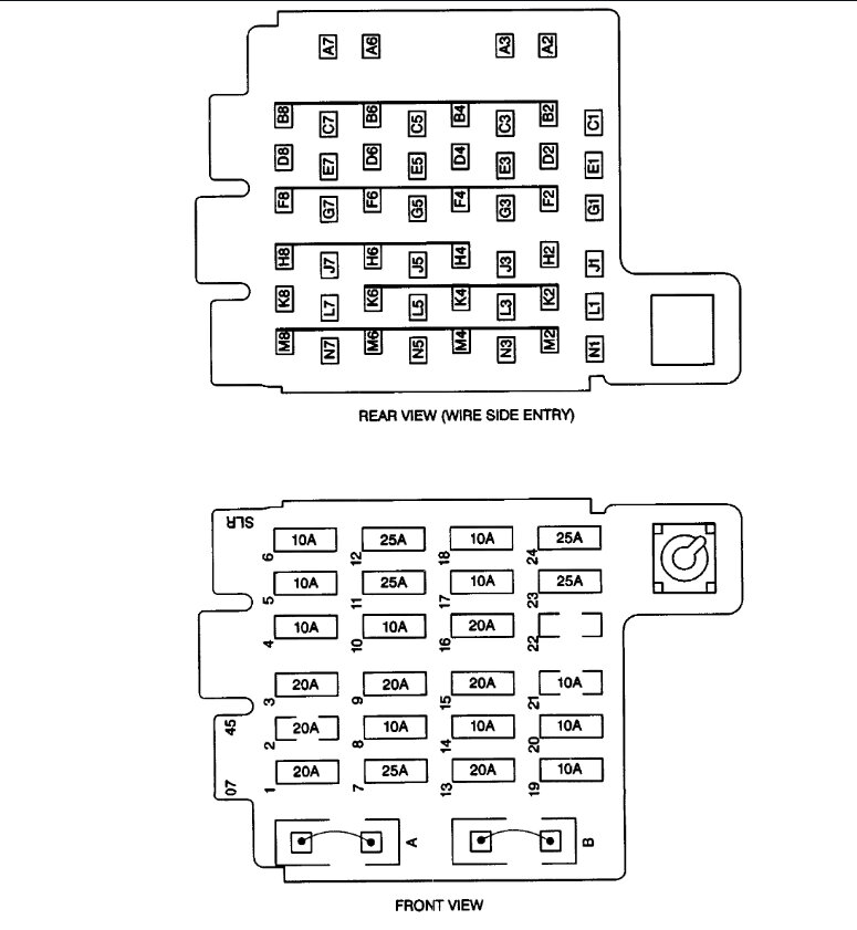

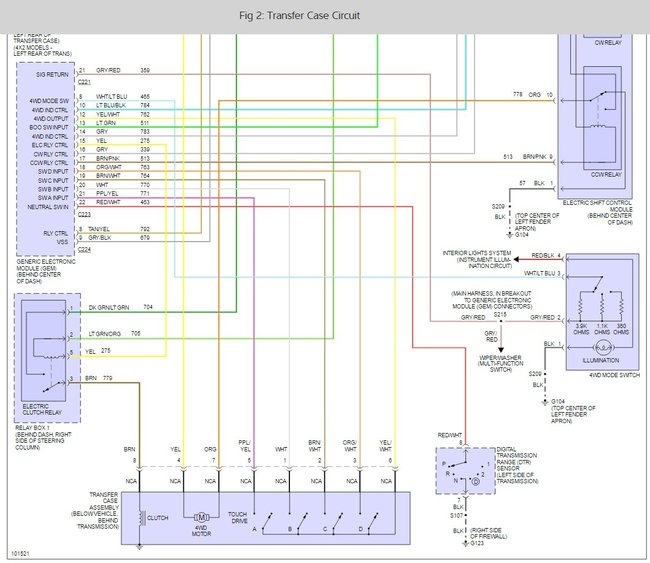

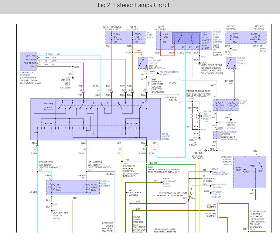

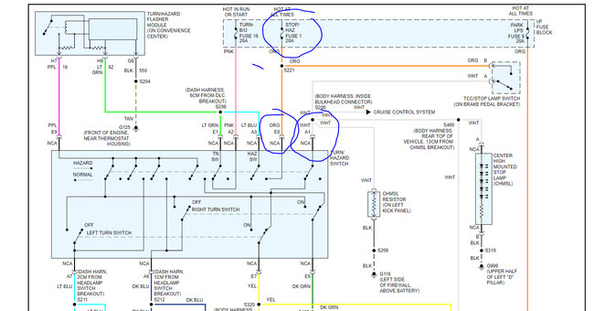

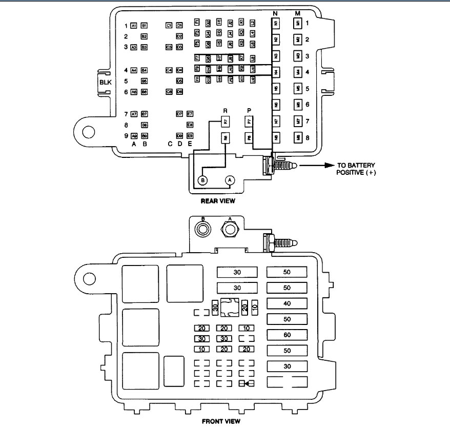

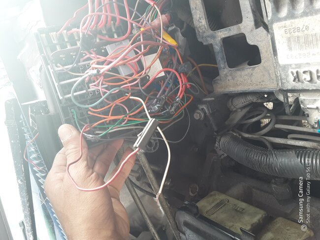

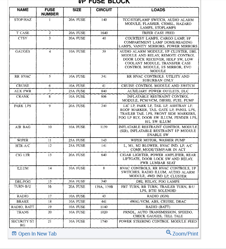

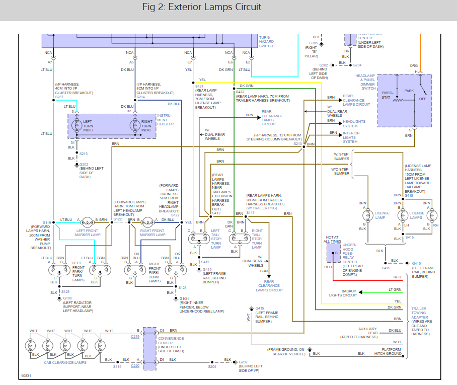

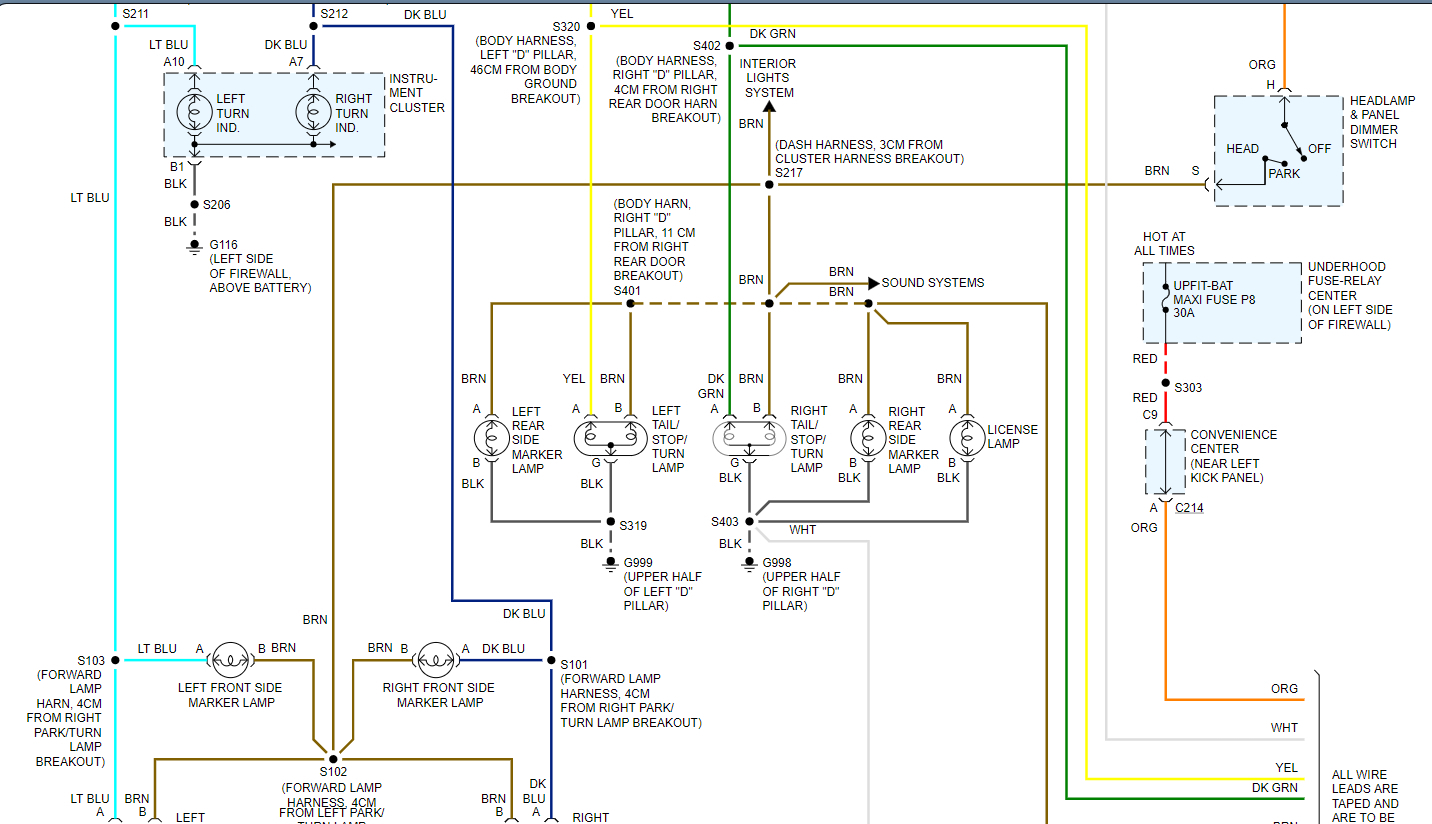

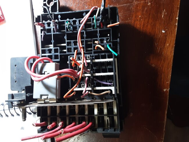

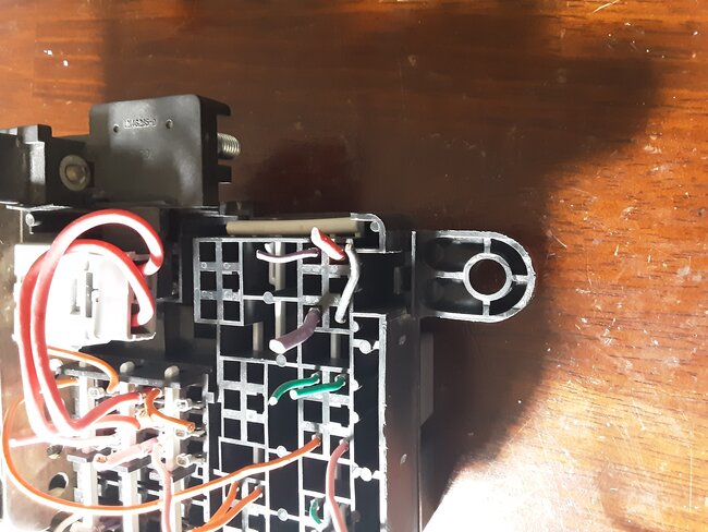

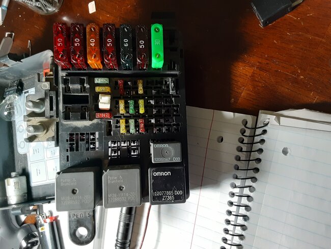

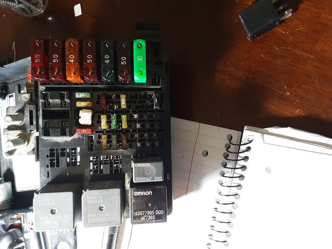

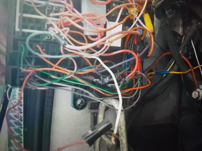

Turns signal do not work but hazards do. Wipers also do not work.
We have replaced the wiper motor and the turn signal switch on the steering column.
Jun 21, 2017 at 1:54 AM
HMAC300
  • 48,601 POSTS

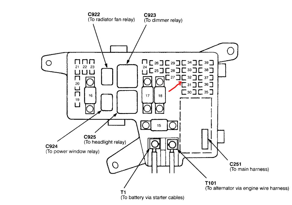

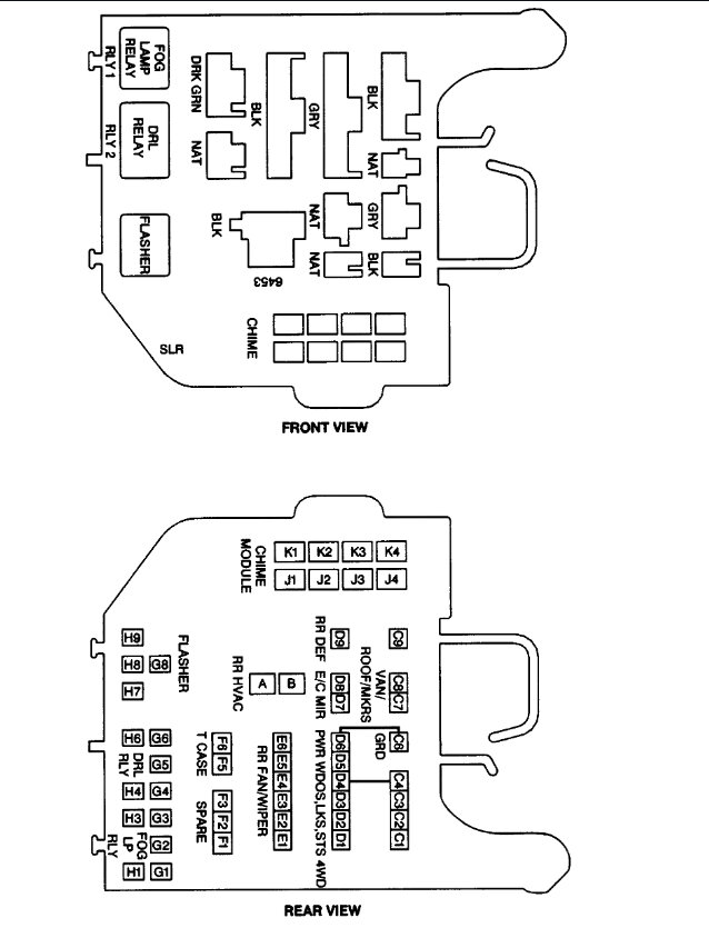

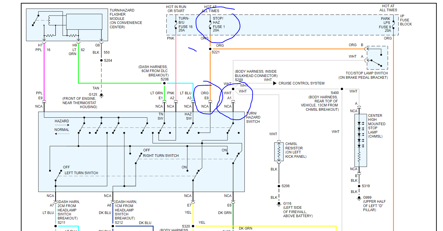

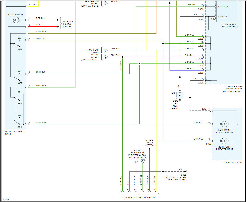

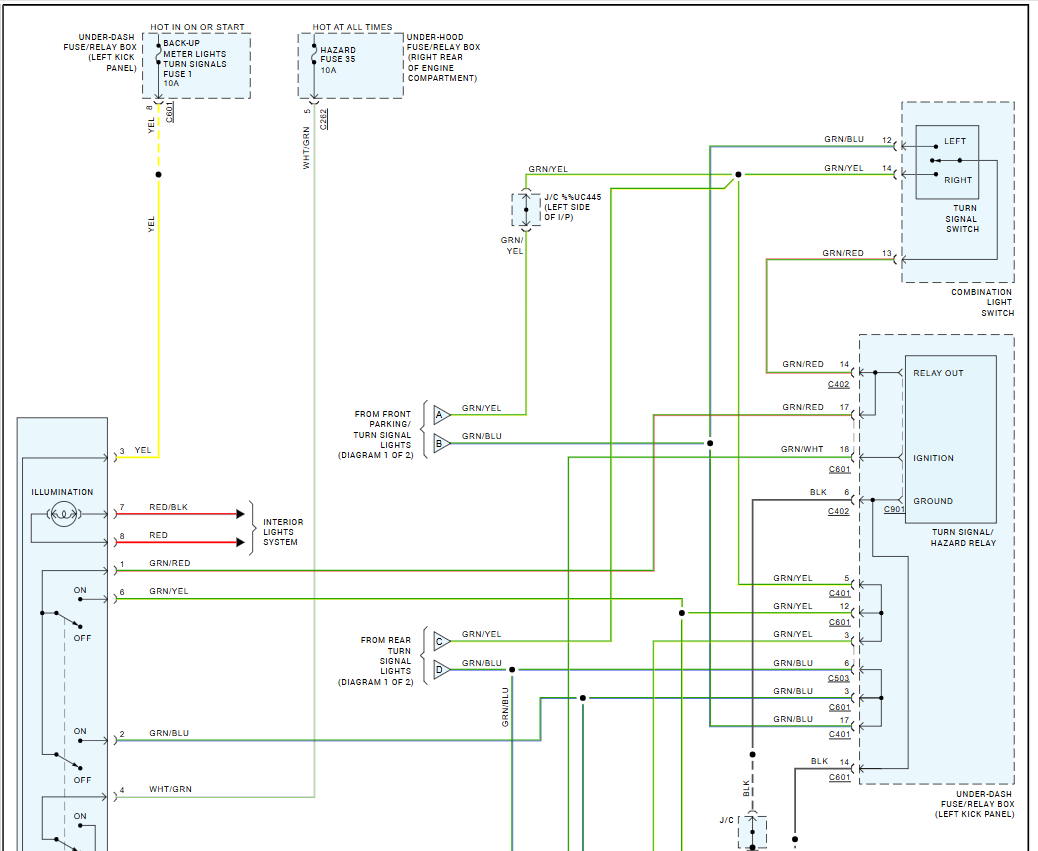

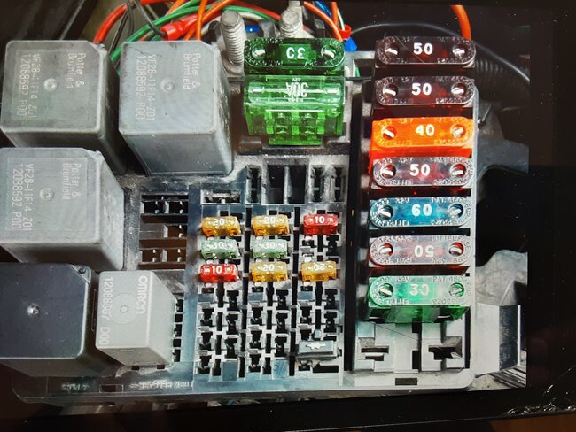

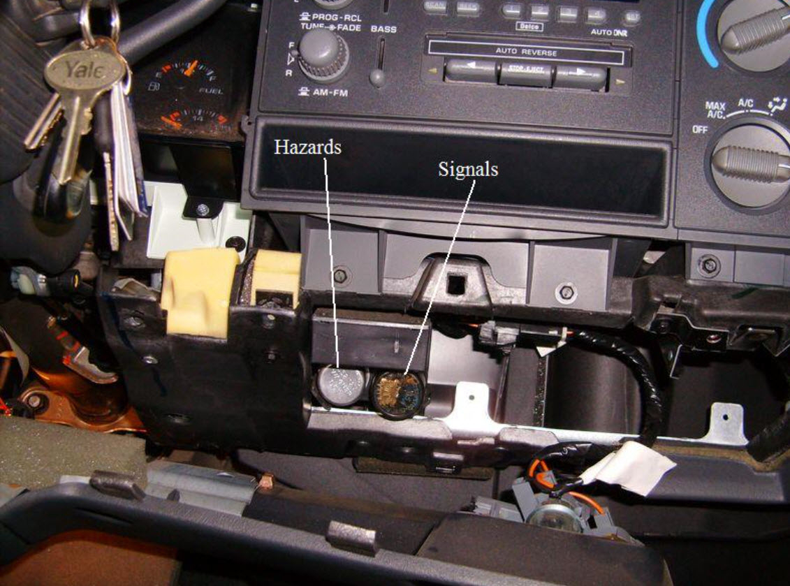

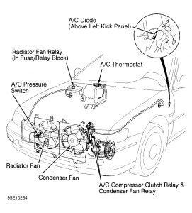

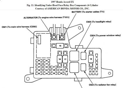

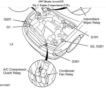

check your turn signal flasher in power distribution center behind center of dash pic shows where it is and not easy to get to......
