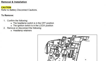

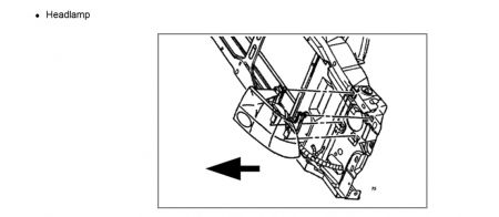

At the top of the headlight there will be two horizontal bars that are either chrome or black. The normal position for this bar is clipped into a bracket on the radiator support. To change the light bulb, pull the bar out of the clip toward the front of the vehicle. Sometimes prying with a screw driver is helpful. After removing the bar from the clip pull straight up while rotating the bar from side to side. After removing the bars the headlamp will be able to be removed from the vehicle and provide access to the turn signal bulb. Re-install in reverse order of removal. Good Luck

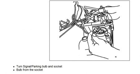

How do you change a bulb in the turn/fog light assembly on the orange lens side.

I don't know if this will help or not?
https://images.2carpros.com/forum/automotive_pictures/170934_blazer_turn_signal_1_1.jpg
https://images.2carpros.com/forum/automotive_pictures/170934_blazer_2_1.jpg
