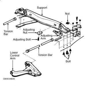

ok this a hard one to explain.
on left hand turn I can hear (not always, just most of the time) when I hit bumps on said left hand turn I can hear it better. Coming from front vassenger side tire. Shocks already replaced.
im not a huge car guys, so what should I be troubleshooting? And how?
from asking around ive gotten that it could be CV joints, ball joints, wheel bearing, or wheel hub?
any ideas?

Many things need to be checked
check lower control arm bushings and upper too
do u hear it at the tire or a bit back under passenger side !!
place a floor jack under lower control arm and check ball joints
place a bar under the tire and push up check for ball joint movement
if under passenger check cross mount
