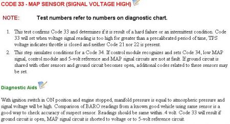

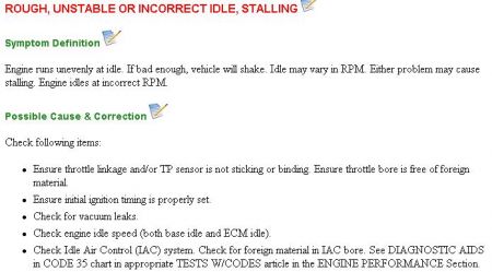

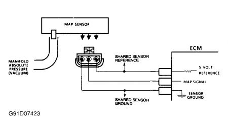

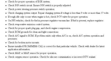

I have a 93 beretta with the 3.1 V6 just bought it ... it has a rough idle when braking for a stop light and while in gear sounds like maybe its missing a little bit. Also i just have replaced the MAP sensor with very little difference in it. IF any at all. and the tester codes come back to the MAP sensor. even though i just replaced it .. also another question. The Air cleaner sensor.. i think thats what its called.. it plugs into the air filter box to read back air flow i would imagine. now this seems to be plugged in but doesnt seem to make a difference. and also wondering if its supposed to have power going to that plug at all times? or is it an intermittent type plug that only applies power during like accel. or climbing hills? ... would i be able to use a light tester to make find out if it was getting power? and if so ... what would be reason if it wasnt getting any power?

[quote]and the tester codes come back to the MAP sensor. even though i just replaced it .. [quote]
It is quite possible that the problem lies in the wiring. You may want to check your wires to the MAP sensor. You may have loose, frayed, broken, or disconnected wire along the way from the sensor to the ECM.

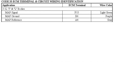

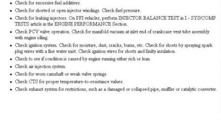

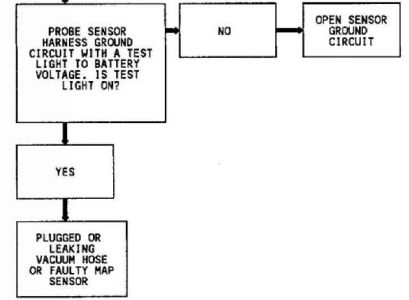

alright ... i can check over wires but the check engine light isn't on ... indicating that its not working matter of fact it is working but .. what i plug into the computer i am getting code 33..... which is an indication that the signal voltage is to high? .... i am pretty sure thats it and as for the air filter plug i will have to check that out ... also with code 33 ... notes also say it can be reading 33 because of another problem ... which also i think rough idling like missing at idle when in drive with the brake on.? .. i just bought into this thing so far i have done quite a bit of work .. just trying to come up with some sort of reasoning for the rough idle... it rough idles when it warms up but while cold it isnt no where near so bad.

https://images.2carpros.com/forum/automotive_pictures/55316_93beretta33_1_1.jpg
https://images.2carpros.com/forum/automotive_pictures/55316_93beretta33_2_1.jpg

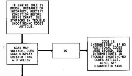

Code 33 Schematic
https://images.2carpros.com/forum/automotive_pictures/55316_93beretta33_27_1.jpg

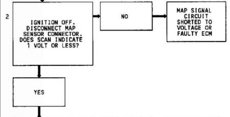

Code 33 Flow Chart
https://images.2carpros.com/forum/automotive_pictures/55316_93berettaflow1_1.jpg
https://images.2carpros.com/forum/automotive_pictures/55316_93berettaflow2_1.jpg
https://images.2carpros.com/forum/automotive_pictures/55316_93berettaflow3_1.jpg
https://images.2carpros.com/forum/automotive_pictures/55316_93berettarough_1.jpg
https://images.2carpros.com/forum/automotive_pictures/55316_93berettarough2_1.jpg
https://images.2carpros.com/forum/automotive_pictures/55316_93berettarough3_2.jpg
