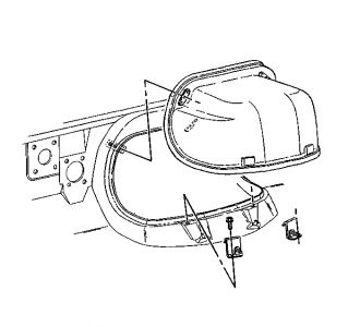

How do you remove the engine cover on a 1999 Chevy Astro?

The are 4 bolts that you can acsses through the inside of the van. You have to remove the center cup holder/glove box trim aswell. I attatched an iage to show the location of the bolts...
