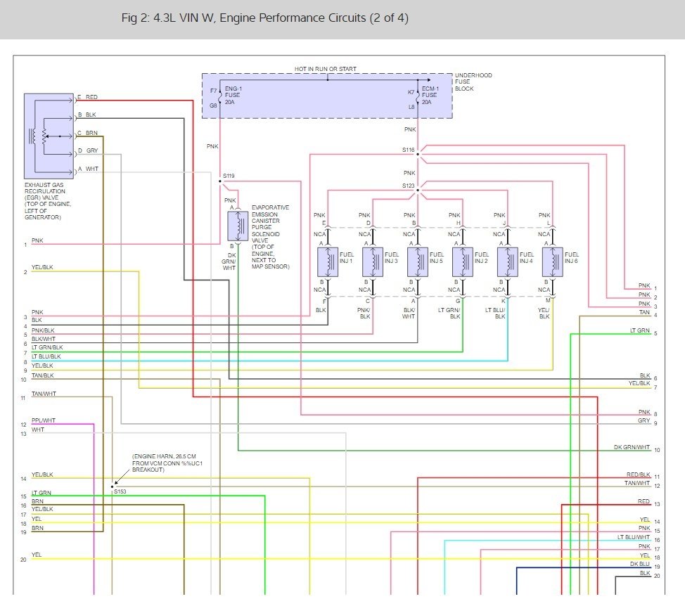

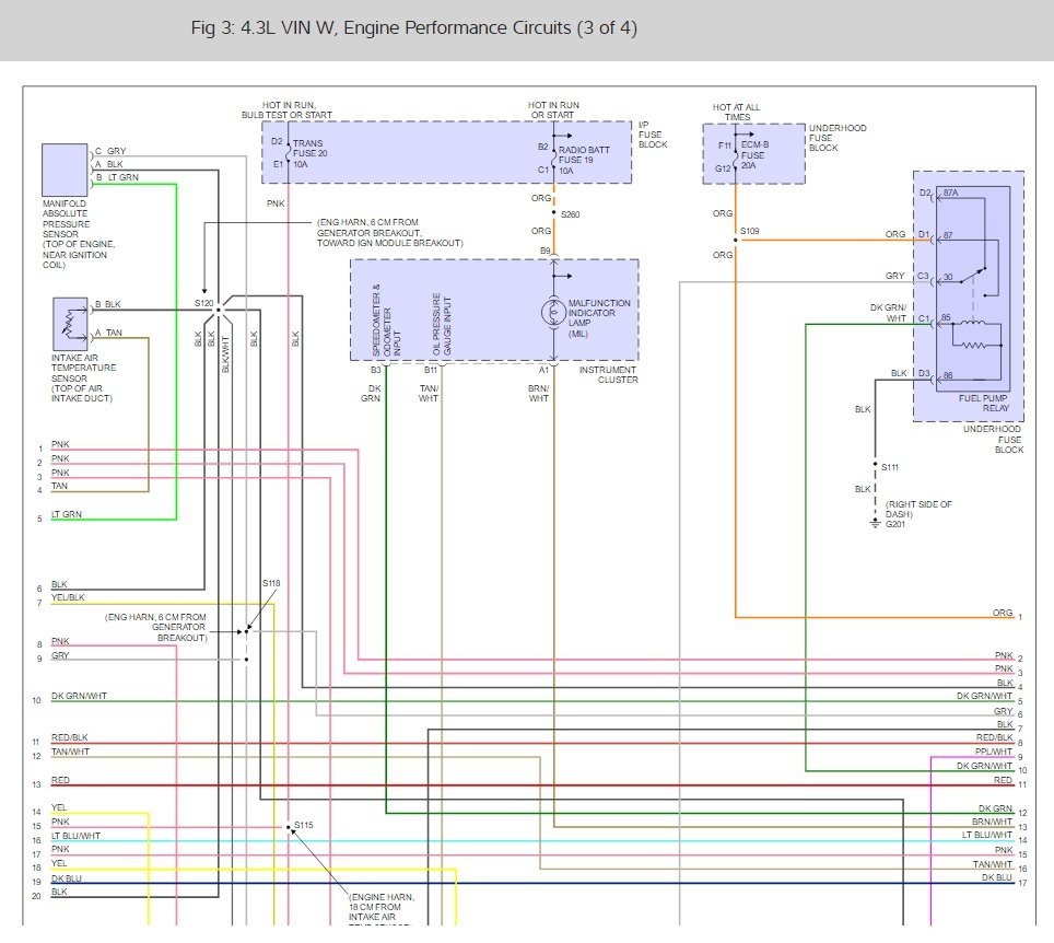

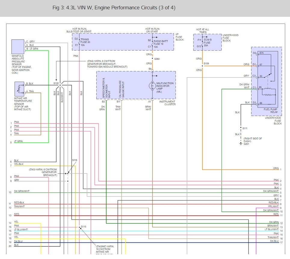

My fuel pump is not charging the system, (pulled the fuel filter and turned the ignition) I switched the relay switch with the A/C relay (they are the same) and got no change. Is there another electrical component in that system that could be faulty, maybe the inertia switch, but I do not know where it is?
Feb 23, 2008 at 9:03 AM
  • 55,423 POSTS

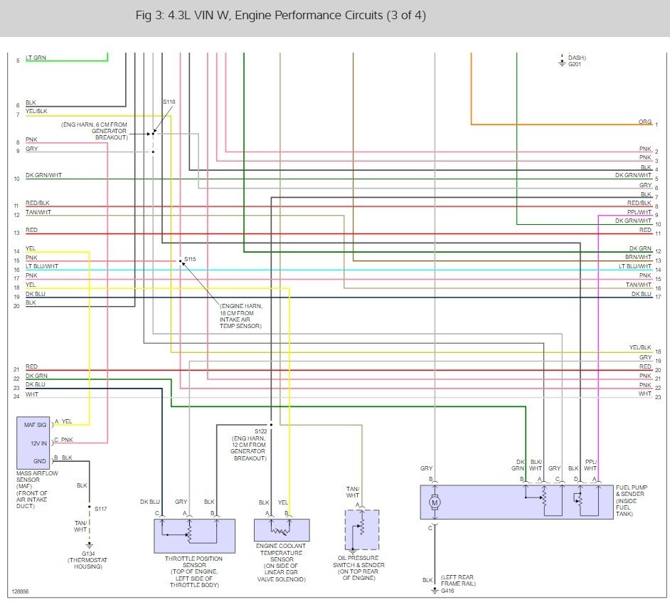

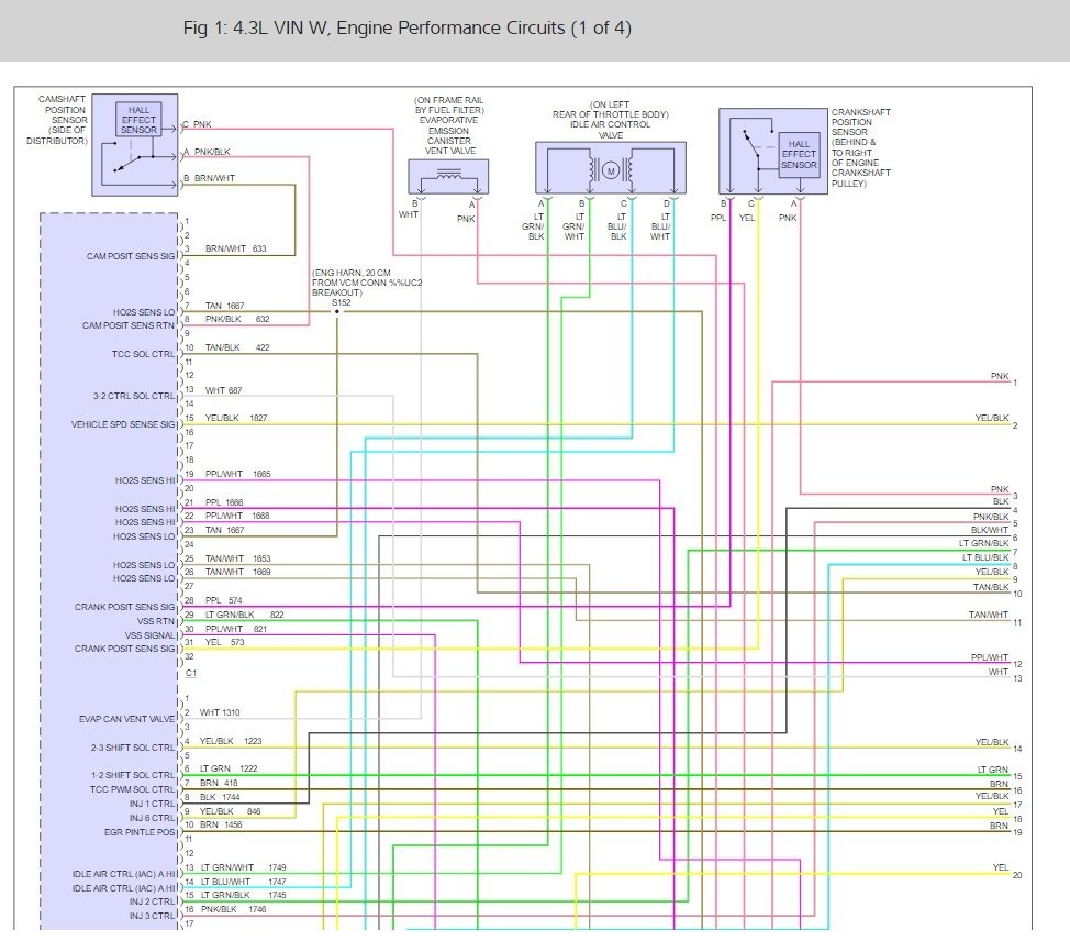

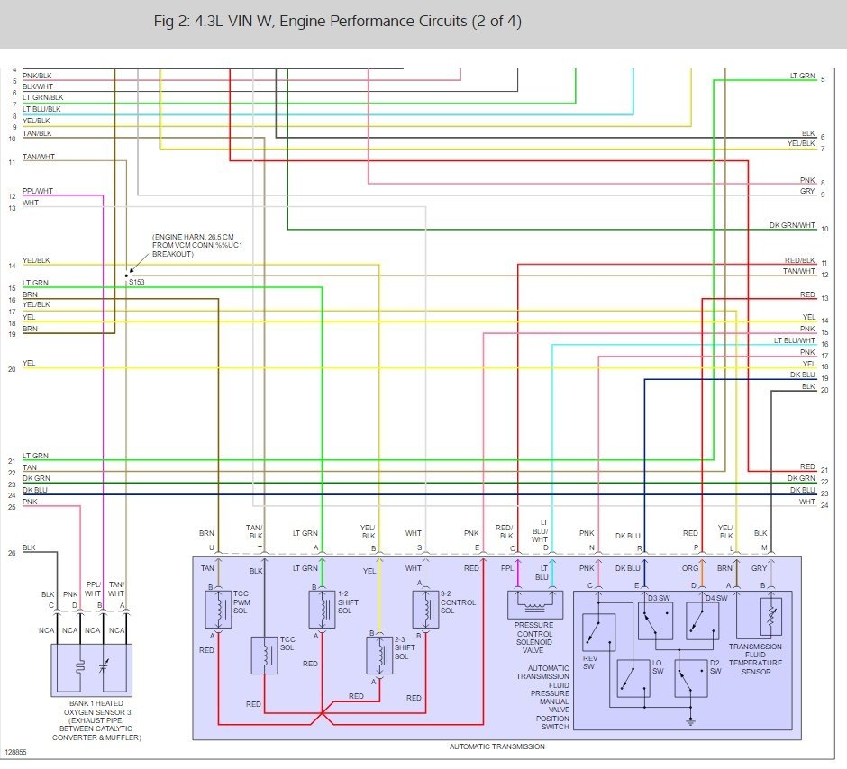

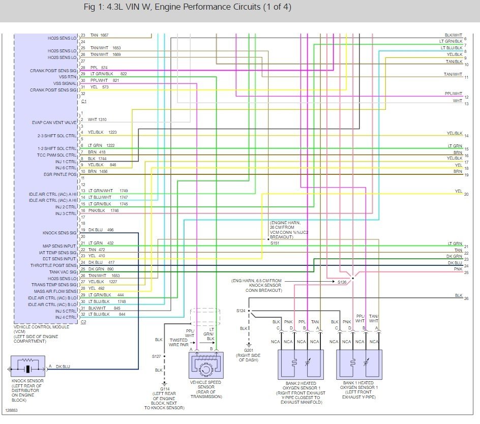

There is no inertia switch for the fuel pump in this car like there is in a ford. Here is a wiring diagram and a guide to help you do some testing so you can get the problem fixed.
You can see that the ECM-B fuse must be good for the fuel pump to work.
Here is a guide to help you test the fuse:
and
Wring diagrams below!
Please run some tests and get back to us so we can continue helping you.
