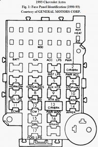

https://images.2carpros.com/forum/automotive_pictures/62217_Astroa_1.jpg
FUSE & CIRCUIT PANEL IDENTIFICATION 1 - 10 Amp Instrument Panel Lights 2 - 30 Amp Circuit Breaker Power Accessories 3 - 30 Amp Horn/Dome Lights, Digital Clock, Cigarette Lighter, Radio Memory, Glove Box Light 4 - 20 Amp Ignition/Gauges, Cruise Control, Headlight Switch, Ashtray Light, Brake Switch, Audio Alarm (1993) 5 - 25 Amp Auxiliary Heater (If Equipped) 6 - 20 Amp Stoplights, Hazard Flasher, Digital Instrument Cluster 7 - 20 Amp Tail & Parking Lights, Headlight Switch 8 - 20 Amp Turn/Back-Up Lights 9 - 20 Amp Heater/A/C 10 - 10 Amp Radio 11 - 10 Amp ECM B 12 - 10 Amp ECM I 13 - 30 Amp Circuit Breaker Power Windows 14 - 25 Amp Windshield Wiper 15 - 10 Amp Daytime Running Lights (Canada Only) 16 - 15 Amp ABS Brake, Speedometer (1993) 17 - 15 Amp Foglights Page 1 of 1 FUSES & CIRCUIT BREAKERS -1993 Chevrolet Astro 4/13/2009 Check #'s 4, 11, 12, ok? No fuse links are just that, fuse links, forget the cigar fuse for now!

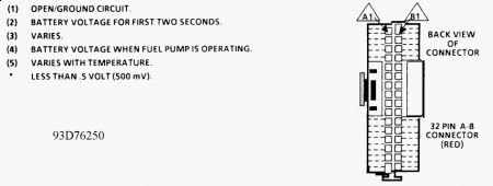

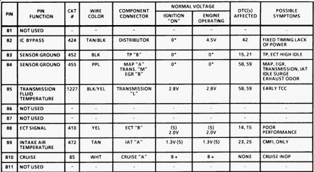

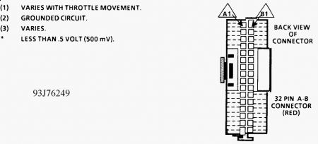

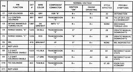

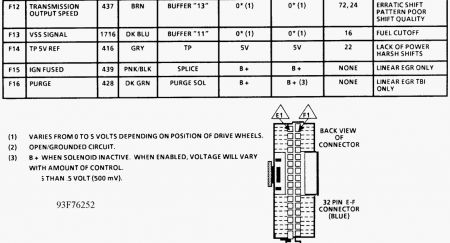

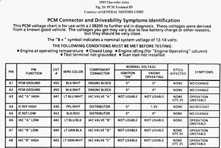

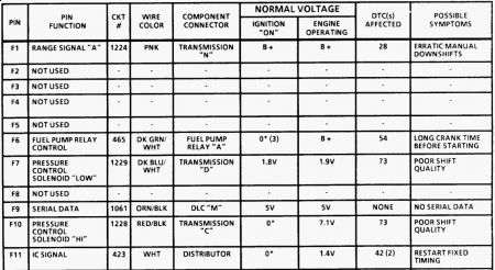

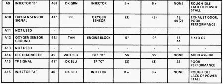

SERVICE ENGINE SOON (CHECK ENGINE) If a problem occurs in engine control system, ECM grounds light. Light should come on when ignition is turned on, then go out when engine starts if no problems exist in engine control system. Page 1 of 1 INSTRUMENT PANEL -1993 Chevrolet Astro 4/14/2009 If it does not come on check the connection at the ECM, may be loose, or bent / misaligned pins, bad ground, or bad ECM.
https://images.2carpros.com/forum/automotive_pictures/62217_Pina_1.jpg
https://images.2carpros.com/forum/automotive_pictures/62217_pinb_1.jpg
https://images.2carpros.com/forum/automotive_pictures/62217_pinc_1.jpg
https://images.2carpros.com/forum/automotive_pictures/62217_pind_1.jpg
https://images.2carpros.com/forum/automotive_pictures/62217_pind_2.jpg
https://images.2carpros.com/forum/automotive_pictures/62217_pine_1.jpg
https://images.2carpros.com/forum/automotive_pictures/62217_pinf_1.jpg
https://images.2carpros.com/forum/automotive_pictures/62217_ping_1.jpg
https://images.2carpros.com/forum/automotive_pictures/62217_pini_1.jpg
https://images.2carpros.com/forum/automotive_pictures/62217_pinj_1.jpg
Check the power and grounds for the PCM at shown connectors and wire colors, also check power to fuel pump relay.
