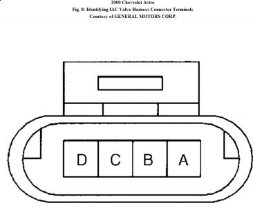

You may have a vacuum leak, get a can of spray Throttle body cleaner, spray the vac lines and maniflod area, when the idle changes, youve found the leak! You want the engine running and spray on the outside but do direct the stream onto the hoses, if it is a vacuum leak, the engine idle will change speed, then you have detected a leak, repair the vacuum leak and see how it runs! Idle control diagnostics: IDLE AIR CONTROL SYSTEM DIAGNOSIS 1. Perform On-Board Diagnostic (OBD) system check. See ON-BOARD DIAGNOSTIC (OBD) SYSTEM CHECK in appropriate SELF-DIAGNOSTICS article. Go to next step. 2. Set parking brake and block wheels. Turn A/C off. Start engine and let idle. Install scan tool and select SPECIAL FUNCTIONS. Select IAC SYSTEM TEST, and then RPM CONTROL. Using scan tool, command engine speed to 500 RPM. If actual engine RPM is within 100 RPM of scan tool display, go to next step. If actual engine RPM is not within 100 RPM of scan tool display, go to step 4. 3. Using scan tool, command engine speed to 1200 RPM. If actual engine RPM is within 100 RPM of scan tool display, check for a non-IAC system problem (i.e., vacuum leak, sticking throttle cable, fuel system lean or rich, throttle body, poor electrical connections, faulty PCV valve, A/C compressor circuits). If actual engine RPM is not within 100 RPM of scan tool display, go to step 5. 4. Check for vacuum leaks, sticking throttle plates, faulty PCV valve, or restriction in air induction system. If problem exists, go to step 20. If problem does not exist, go to step 6. 5. Check for obstruction or excessive carbon deposit in throttle body IAC passages. If problem exists, go to step 21. If problem does not exist, go to next step. 6. Turn ignition off. Disconnect IAC valve harness connector. Check for poor connection at IAC valve. If problem exists, go to step 19. If problem does not exist, go to next step. 7. Connect IAC Driver (J-37027-A) to IAC valve. Set parking brake and block wheels. Turn A/C off. Start engine and let idle. Install scan tool and monitor engine RPM. Using IAC driver, extend and retract IAC valve. If engine RPM decreases and increases as IAC valve is cycled, go to next step. If engine RPM does not decrease and increase as IAC valve is cycled, go to step 22. 8. If RPM changes smoothly with each flash of IAC valve cycle, go to next step. If RPM does not change smoothly with each flash of IAC valve cycle, go to step 22. 9. Install appropriate IAC node light onto IAC valve harness connector. Cycle IAC driver and observe lights. Both lights should cycle Green to Red, but never off as RPM changed over its range. If lights flash as specified, go to next step. If lights do not flash as specified, go to step 12. 10. Remove IAC driver from IAC valve. Using DVOM, measure resistance between IAC valve terminals "A" and "B". See Fig. 8 . Also, measure resistance between IAC valve terminals "C" and "D". If resistance is 40-80 ohms on both measurements, go to next step. If resistance is not 40-80 ohms on both measurements, go to step 22. 11. Using DVOM, measure resistance between IAC valve terminals "B" and "C". See Fig. 8 . Also, measure resistance between IAC valve terminals "A" and "D". If resistance is infinite on both measurements, check for a non-IAC system problem (i.e., vacuum leak, sticking throttle cable, fuel system lean or rich, throttle body, poor electrical connections, faulty PCV valve, A/C compressor circuits). If resistance is not infinite on both measurements, go to step 22. 12. Turn ignition off. Disconnect PCM harness connectors. Check for poor connections at PCM. If problem exists, go to step 19. If problem does not exist, go to next step. 13. Remove IAC node light. Check for an open in IAC driver circuits between IAC valve harness connector and PCM harness connector. If problem exists, go to step 19. If problem does not exist, go to next step. 14. Using a test light connected to battery voltage, probe IAC valve harness connector terminals. If test light illuminates at any terminal, go to step 17. If test light does not illuminate at any terminal, go to next step. 15. Turn ignition on with engine off. Using a test light connected to ground, probe IAC valve harness connector terminals. If test light illuminates at any terminal, go to step 18. If test light does not illuminate at any terminal, go to next step. 16. Check for a short between IAC valve circuits. If problem exists, go to step 19. If problem does not exist, go to step 23. 17. Repair short to ground in IAC circuit. After repairs, go to step 24. 18. Repair short to voltage in IAC circuit. After repairs, go to step 24. 19. Repair circuit as necessary. After repairs, go to step 24. 20. Repair condition as necessary. After repairs, go to step 24. 21. Clean IAC passages. After repairs, go to step 24. 22. Replace IAC valve. After repairs, go to step 24. 23. Replace PCM. Program PCM. Perform VTD password relearn procedure and crankshaft variation learn procedure. See COMPUTER RELEARN PROCEDURES article in GENERAL INFORMATION. After repairs, go to next step. 24. Install scan tool. Start engine and let idle. Turn off all accessories. Using scan tool, command engine speed to 1200 RPM, and then down to 500 RPM. Again, using scan tool, command engine speed as specified. If actual RPM is close to commanded RPM, system is okay. If actual RPM is not close to commanded RPM, go to step 2. 4/15/2010 ...
https://images.2carpros.com/forum/automotive_pictures/62217_IAC_Connector_1.jpg

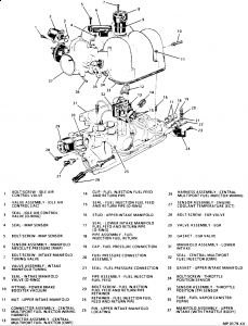

GOD54901
hi i have a 95 astro van that is really making me mad it idles rough even while driving.i have put my scanner on it also auto zones scanner on an both say no codes,i have replaced plugs wires cap and rotor,cleaned the iac ,checked vacuum lines,and checked fuel pressure,and still runs rough, now im tinking ing module?crank sensor or the computer all together????????? any help would be great next step is i stick of TNT and a match lol
Dec 16, 2020 at 8:08 AM (Merged)
OBXAUTOMEDIC
  • 3,711 POSTS
Hello, Ok, with that year most fuel related problems won't set a code. I have come across this to many times and the people have checked and double check and still crossed wires. If firing order is correct then next step would be to check or just replace the Injector Assembly. I say replace cause it is located under the intake.
https://www.2carpros.com/images/question_images/199386/original.jpg
https://www.2carpros.com/images/question_images/199387/original.jpg

KOBRA000
  • 14 POSTS
is there any way you can send me that exploded view or the link to it? i desperately need it.
OBXAUTOMEDIC
  • 3,711 POSTS
Here is the exploded veiw.....

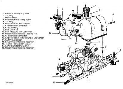

KOBRA000
  • 14 POSTS
well i got the new injection in but i have thus ran into two problems..one i think being huge.
1: i have no information telling me where each injector plug/poppet valve goes where no numbers or letters nothing...i dont want to blindly start plugging them into the wrong port. i was wondering if anyone has a detailed diagram/layout showing where each injector plugs into its proper port
2 on the electrical connector that attaches to the top of this assembly i found some black sticky goop that almost completely coats the entire connector...is this some means of protection/insulation for the connector? and if so can anyone tell me what it is and where to find it and if it is critical to the correct re installation of the new injection system?
any and all answers or help is greatly greatly appreciated.

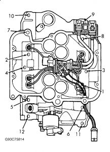

OBXAUTOMEDIC
  • 3,711 POSTS
Hey Keith,
It is simple once the assembly is installed there should be 3 lines on each side. And they go as they are, the one one either side toward front of engine go in socket at front of engine the ones in middle go to middle socket and of course the ones toward rear go the the rear sockets.
And I believe the tar like coating is a factory thing and doesn't have to be placed on new assembly.

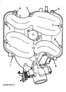

OBXAUTOMEDIC
  • 3,711 POSTS
Hey Keith, Guess I should have posted the specs also before you had to ask for them. Anyway, here they are.... Lower Intake Torq is 35 foot pounds
https://images.2carpros.com/forum/automotive_pictures/188069_4_3lowerintaketorqseq_1.jpg
Upper Intake Torq Is 10 foot pounds
https://images.2carpros.com/forum/automotive_pictures/188069_4_3upperintaketorqseq_1.jpg
