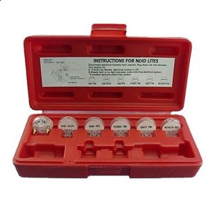

Welcome to 2CarPros, Need a little more info, is the check engine light on? If so, knowing what code or codes are stored would be helpful. On the days when the engine turns over but will not start, check for spark and fuel delivery. With the dog house, (engine cover), removed, You will need to disconnect a fuel injector electrical connector and install a noid light to check for injector pulse.
https://images.2carpros.com/forum/automotive_pictures/436605_noid_1.jpg
