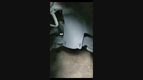

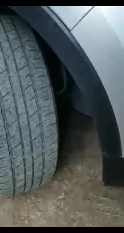

Went to premier oil July 16th for a oil change. Noticed a week ago last week in September car was running rough,check engine light came on and I took my car into local mechanic and there was no oil in my car, not even on the oil stick. The local mechanic did a oil change, but now there a ticking sound coming from the front right passenger side of my car.

The ticking may be a valve lifter that may be stuck. There are additives for this at a parts store.
What was the code that was set fr the check engine light? That will be the clue as to why it is running rough.
https://www.2carpros.com/articles/engine-noises

This is the ticking sound from my car. How can my car go through five quarts in two months? I went to a Premier oil drive through for a oil change July 16 and by the last week of September there is no oil in my car? And no leaks?

That is a major engine issue. It sounds like the lower end of the engine such as a failed bearing.
The only one who can answer this question is the second mechanic. Did he tell you there was no oil in the car? Just because it is not on the stick does not mean it has no oil. The stick will not show below one and half quarts.
Did you check the oil level now? The second guy changed the oil as well.
No, if they did not put oil in the car, it would not have lasted more than five minutes without locking up.
