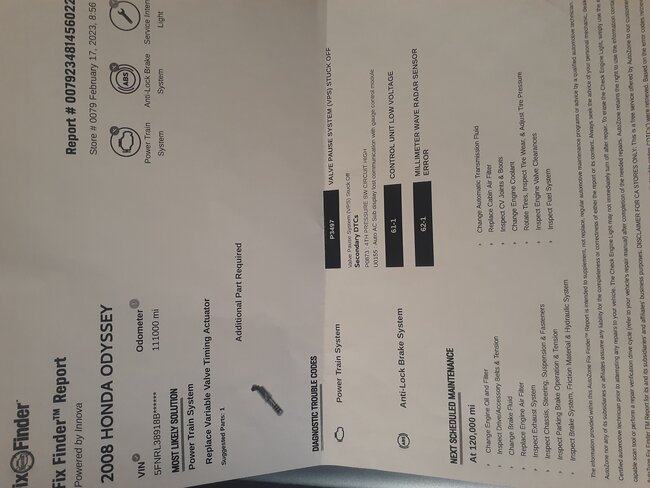

Our check engine light came on and we had to replace the variable valve timing actuator. It was fixed and they reset the check engine light. This morning it came back on, but we realized the gas cap was not on, but we took it to run the code anyway and it came up with the same code. They told us the gas cap probably triggered the check engine light but it's coming up with the same code because there is a 50-to-100-mile drive cycle before that code goes away even though it's fixed. Is this right? Should we drive it for a while, and see? We don't want it to cause more issues if not but the car is driving fine now as well...

These are the codes provided and the part that was replaced.
Feb 17, 2023 at 3:49 AM
STEVE W.
  • 15,413 POSTS
Okay, so I see a P3497, a P0673 and a U0155 along with the ABS issue and the radar error.

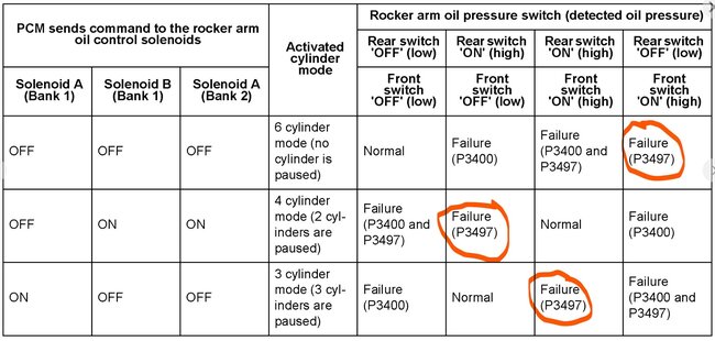

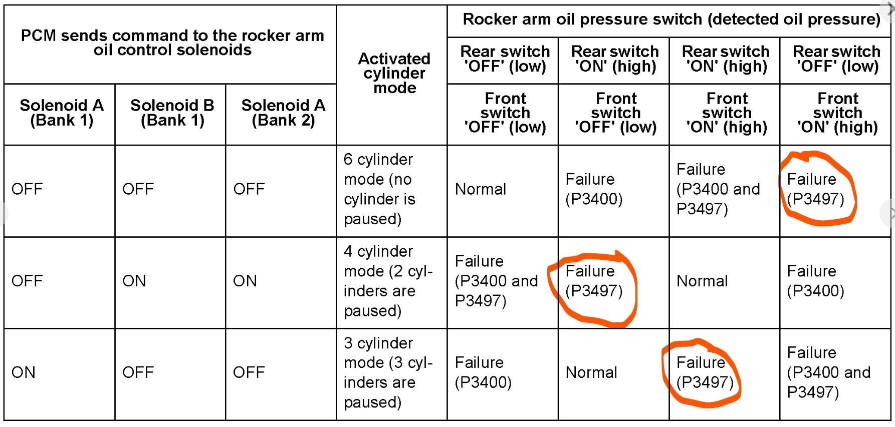

For the P3497 VPS Stuck Off Bank 2 I'll attach a chart showing the different items that can trigger that code. Note that it is set when one of the oil pressure switches doesn't change.

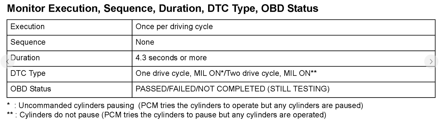

It is also a 2-trip code, so the system has to see the same failure twice withing a certain time for it to turn the light on.
The fastest way to test for the problem would be to use a scan tool and use the bi-directional testing to turn on one oil control solenoid and see what the switches do. If you see one turn on and the other, doesn't you know it's a bad switch. Doing the testing without a scan tool would be very difficult as you would need to know when the system was activating the solenoids and then have a way to watch the switch outputs. Not really something you can do without the scan tool to read the data.
