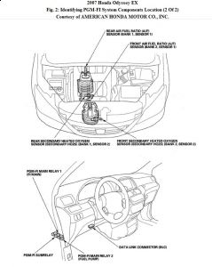

Where do I plug in my computer code reader and will I be able to reset the oil change milage sensor there?

Hi Haybale, The diagram shows the location of the DLC for the scanner.
https://images.2carpros.com/forum/automotive_pictures/192750_SystemComp07OdysseyFig02_1.jpg
No, you cannot and need not use the scanner to reset the maintenence mileage. Here are the reset procedures. Press reset button to get to oil life. Press and hold reset and turn key off. Turn key back on while continuing to hold reset button. When oil life begins to flash release button then press again until oil life displays 100%.
