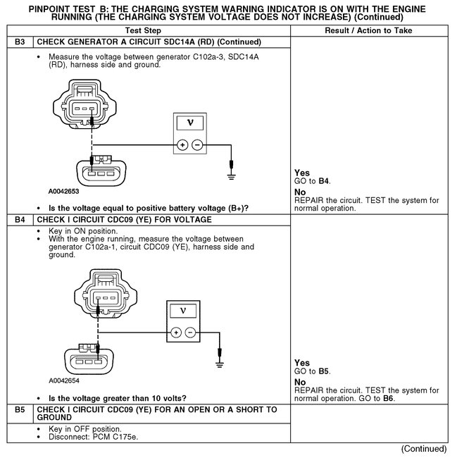

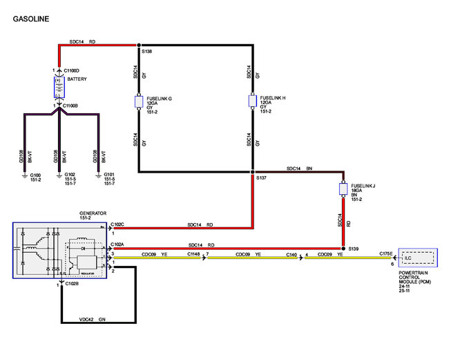

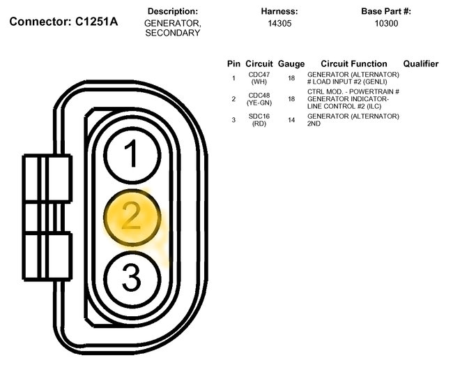

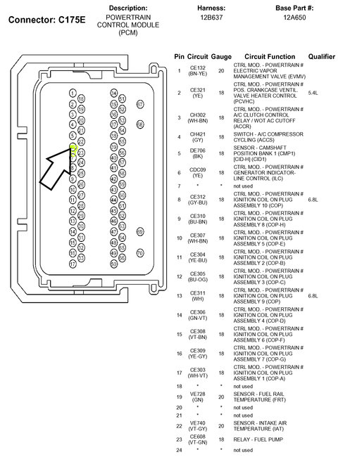

BMDOUBLE
  • 1,139 POSTS
First I would say do not replace the PCM for this concern. I have never replace a PCM for charging concerns in my 27 years at a Ford dealer and I have seen many many many other techs do it without success! Not saying that it isn't possible, just very rare. What brand of alternator are you using also, I have had customers bring me certain aftermarket alternators without success and one time we replace 8 before we got a good one, just saying. And if you are getting voltage across the fusible link then it is good. I've included a diagram of the system for you as well as the connector views for the PCM and the alternator for the monitor circuit so you can verify continuity on that circuit. I warn you once again about that alternator! I can't endorse any particular brand,but all I can say is get the most updated version, who ever makes that I'll leave it up to your imagination. Let us know how it goes!

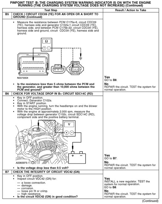

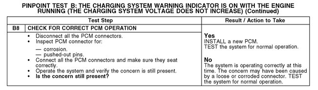

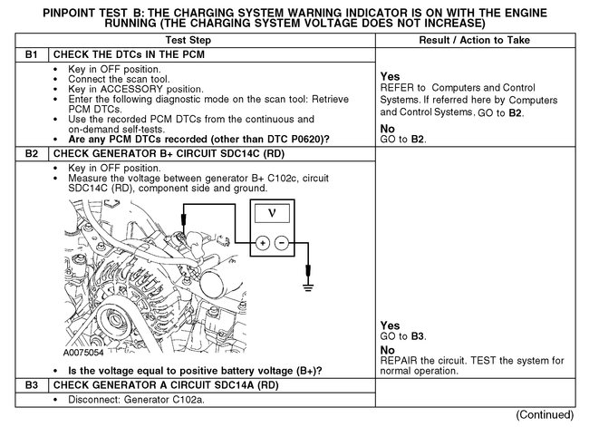

BMDOUBLE
  • 1,139 POSTS
Yes, you should be getting 12 volts on the yellow wire with the engine running. If not you will need to verify the circuit integrity or overlay the circuit. I'll attach the actual pinpoint test from the manual.

CHANCESADLER
  • 8 POSTS
I ran an ignition hot to drive truck on highway and think choice was wrong on my picture. Thinking caused trouble codes. Unplugged middle pigtail on PCM and wasn't showing anything until showed 3 volts only at PCM pin for my yellow wire. So now trying to find a better ignition hot, until we throw a PCM at it is seeming to be the case. I think this is a trip personally and was a driving truck around March first and now it has its share of issues.

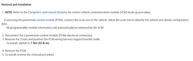

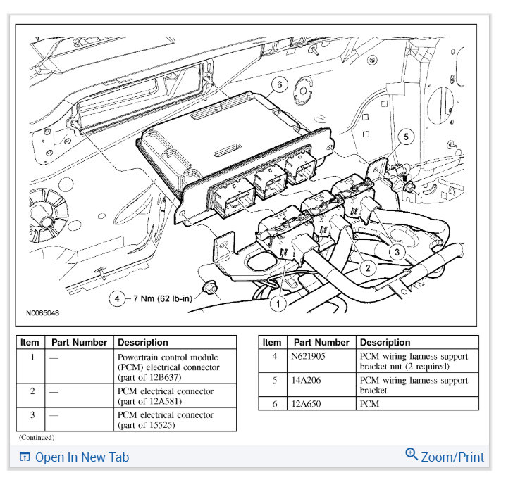

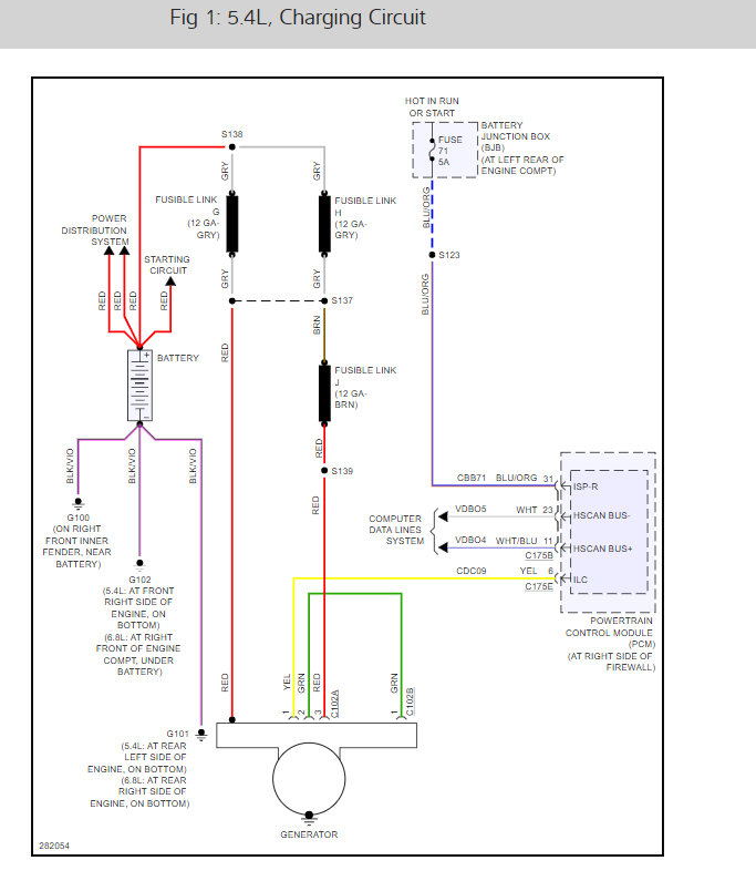

  • 55,381 POSTS
The system looks straight forward. here is a guide to help you test connection and the alternator wiring diagrams so you can see how the system works and what to test. Also make sure the ground from the battery to the frame and engine are good.
If you have a Motorcraft alternator and the wiring and grounds are good here is how to change out the PCM as well.
