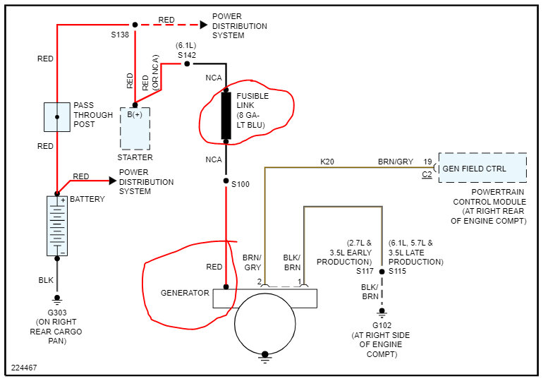

car will not charge! new battery new alternator and new PCM. any ideas?

There is a red wire on the alternator that should have 12v at all times. Can you check that for me? That wire comes from the starter motor and has a fusible link built into it. If the link failed, you won't have power at the wire and the battery won't charge. (See pic below)
Check this and let me know the results.
See pic below.

Yes, the red wire has 12 volts, which is the only wire coming off the alternator that has any juice.

If you have power, confirm there is continuity to ground via the brown wire with a black tracer. If there is power and ground, either the alternator is no good or the PCM you got is no good. Other than those two things, an open between the alt and PCM or poor connection can cause it. However, that should be visible.

so, i do have continuity in the brown with black wire. how do i test the PCM?

We need to check the voltage at the battery with the engine off and the engine running. If we have power and ground for the alternator and the alternator is good, the PCM is the next suspect. If it isn't changing (charging), the PCM is the likely cause.
