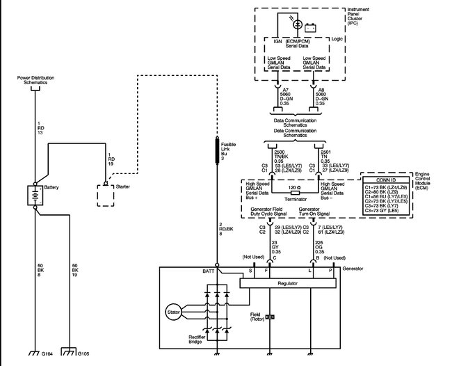

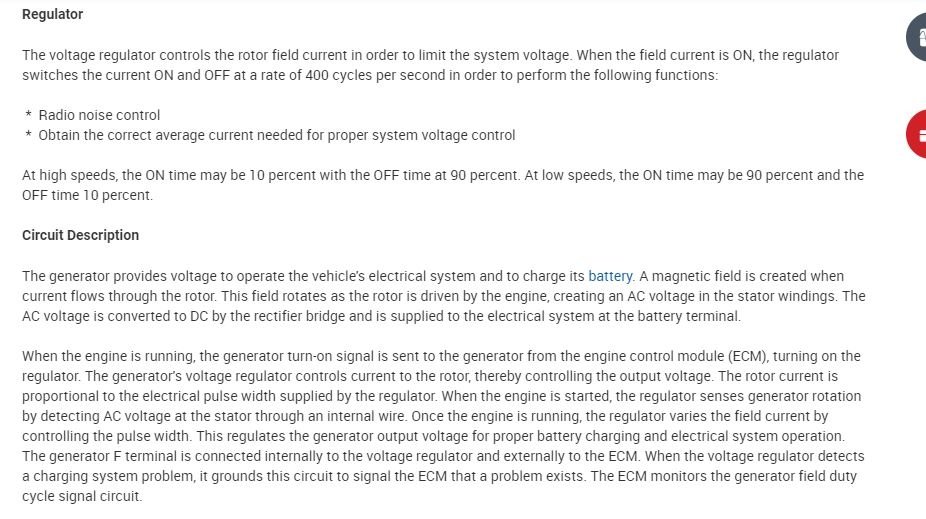

I do not have any information on this system's operation, but if the generator works as the diagram suggests, you can try taking some readings on the two smaller wires plugged into the generator. The orange wire is the turn-on signal that tells the voltage regulator to start running the generator. In the past, you would find about two volts on that wire with the ignition switch on and the engine not running. The other ten volts was dropped across the "battery" light on the dash, so that light was on. Once the engine is started and the generator is producing output, the regulator puts fourteen volts back out on that wire to turn the "battery" light off. If you find zero volts on that wire, suspect the engine computer or a break in that wire.
The gray wire is a duty-cycled feed for the generator's field winding. In the past that just had full battery voltage applied to it all the time. It is where the voltage regulator sensed system voltage and it was the supply for the field winding. There is no description to indicate how much this signal affects the generator's performance. To add to the misery, being a duty-cycle signal, it is a stream of voltage pulses that vary between zero and some maximum voltage, typically twelve volts, so it cannot be measured with a digital voltmeter.

To add to what Doc posted. This is the charging circuit. Because of the way it operates you really need a scope to tell if the charge signal is getting to the alternator from the computer. The OEM tests use a scan tool, battery load tester and the charts below.
A shortcut I use to find if the problem is wiring or ECM is to remove the ECM connector and test the wiring from it to the alternator with a continuity tester, While it is on the circuit I will go along the harness and move the wires/connectors just to be sure there are no breaks.
If the wires are good and you have tested the alternator for actual output then the issue is likely in the ECM itself.

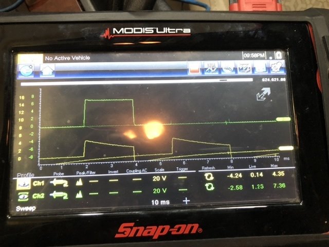

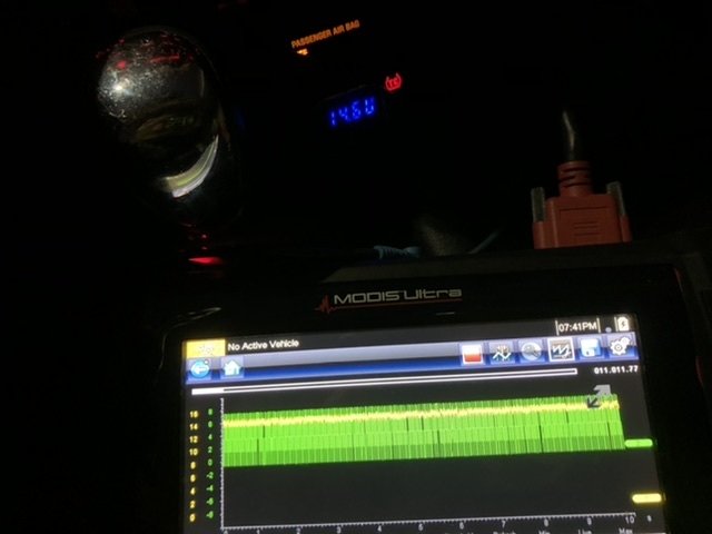

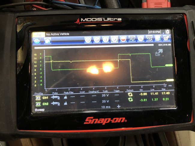

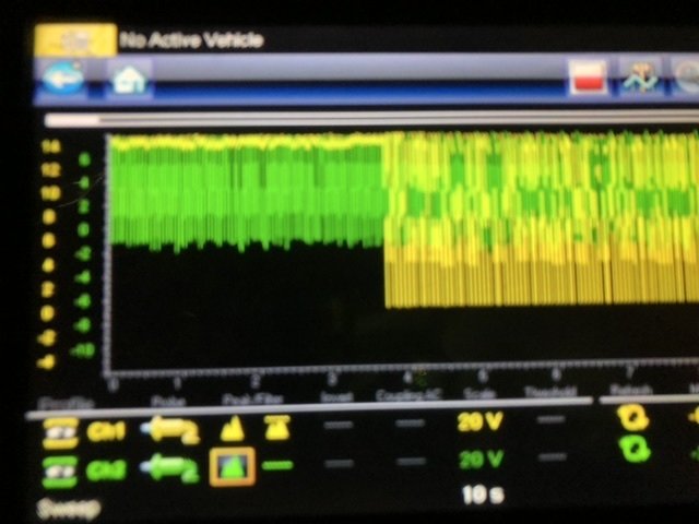

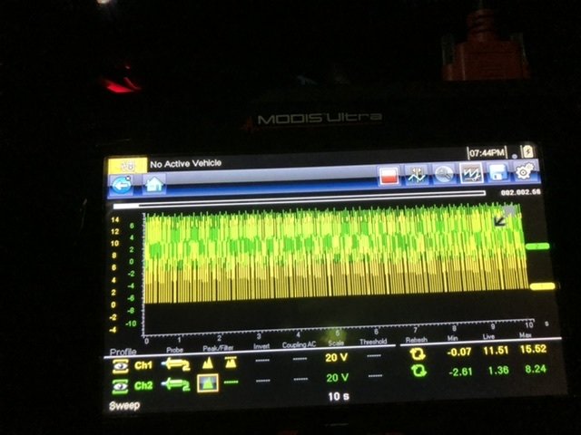

Okay Roy, I got home and set up the scope watching the orange wire (green trace) and the grey wire (yellow trace). The first image is cold start, normal charging. The second image with the yellow drop is the moment it stops charging, and the third pattern is not charging at all. Also, I cleared the codes and picked up a P0621 when the car was restarted.
Mar 6, 2020 at 8:40 AM
What is your car information?
Mar 6, 2020 at 8:57 AM
JAYJAY3
  • 24 POSTS
2008 Pontiac G6 4cyl. It has the early production charging system.

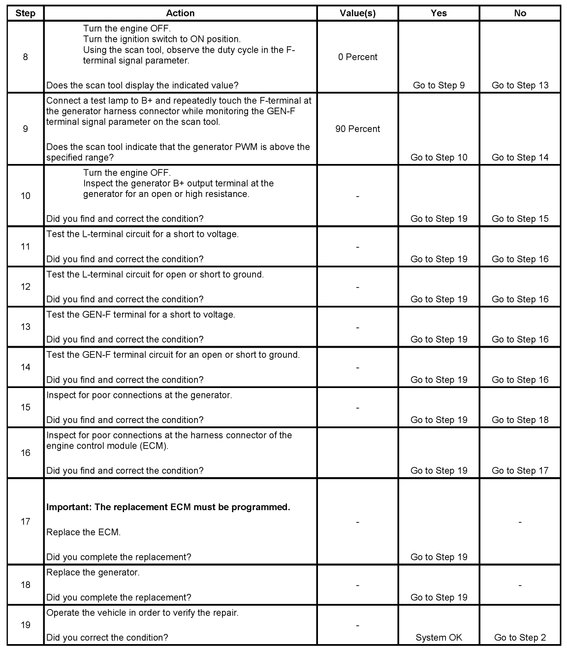

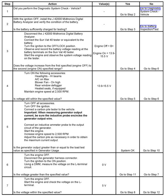

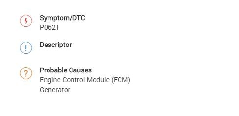

I attached the flow chart for the 621.
Were all the ECM flashed to the VIN?
Charging System Test
Diagnostic Instructions
Perform the Diagnostic System Check - Vehicle prior to using this diagnostic procedure. See: Vehicle > Initial Inspection and Diagnostic Overview
Review Strategy Based Diagnosis for an overview of the diagnostic approach.
Diagnostic Procedure Instructions provides an overview of each diagnostic category.
Circuit/System Verification
Engine ON, observe the charge indicator on the instrument panel cluster (IPC) or message in the driver information center (DIC). The charge indicator on the IPC should be turned OFF and the DIC should not display any charging system message.
If the charge indicator is not on the IPC and a charging system message is not displayed on the DIC, Refer to Testing for Intermittent Conditions and Poor Connections in Diagnostic Aids. See: Vehicle > Component Tests and General Diagnostics
If the charge indicator is ON on the IPC or a charging system message is displayed on the DIC, refer to Circuit/System Testing.
1. Ignition ON, verify that no generator or battery current sensor DTCs are set that would cause a charging system concern.
If DTCs are set, refer to Diagnostic Trouble Code (DTC) List - Vehicle. See: A L L Diagnostic Trouble Codes ( DTC ) > Diagnostic Trouble Code Descriptions
2. Ignition OFF, measure the voltage across the battery terminals. The voltage should read 12.0 volts or greater at room temperature.
If not within the specified value, refer to Battery Inspection/Test. See: Starting and Charging > Component Tests and General Diagnostics > Battery Inspection/Test
3. Connect a carbon pile tester to the battery.
4. Start the engine and increase the engine speed to 2,500 RPM. Observe the voltage reading on the tester. The voltage should read between 12.6-15.0 volts.
If not within specified range, replace the generator.
5. Adjust the carbon pile tester to the specified load test output value, refer to Generator Usage.
If not within specified value, replace the generator.
Repair Instructions
Perform the Diagnostic Repair Verification after completing the diagnostic procedure. See: A L L Diagnostic Trouble Codes ( DTC ) > Verification Tests
Generator Replacement (LZ4) Generator Replacement (LZ9) Generator Replacement (LY7) Generator Replacement (LE5)
621
DTC P0621
DTC Descriptor
DTC P0621
Generator L-Terminal Circuit
Circuit/System Description
The engine control module (ECM) uses the generator turn ON signal circuit to control the load of the generator on the engine. A high side driver in the ECM applies a voltage to the voltage regulator. This signals the voltage regulator to turn the field circuit ON and OFF. The ECM monitors the state of the generator turn ON signal circuit. The ECM should detect low voltage on generator turn on signal circuit when the ignition is ON and the engine is OFF, or when the charging system malfunctions. With the engine running, the ECM should detect high voltage on the generator turn on signal circuit. The ECM performs key ON and RUN tests to determine the status of the generator turn on signal circuit.
Conditions for Running the DTC
Key ON Test
No generator, crankshaft position (CKP) sensors, or camshaft position (CMP) sensor DTCs are set.
The ignition is in RUN position.
The engine is not running.
RUN Test
No generator, CKP sensors, CMP sensor DTCs are set.
The engine is running.
Conditions for Setting the DTC
During the key ON test, the ECM detects high voltage on the generator turn on signal circuit for 5 seconds.
During the RUN test, the ECM detects low voltage on the generator turn on signal circuit for 15 seconds.
Action Taken When the DTC Sets
The ECM will command the charge indicator and or warning message to be illuminated on the instrument panel cluster (IPC) and the driver information center (DIC), if equipped.
The ECM will not illuminate the malfunction indicator lamp (MIL).
The ECM will store conditions, which were present when the DTC set as Fail Records data only.
Conditions for Clearing the DTC
A current DTC will clear when the conditions for setting the DTC are no longer met.
A history DTC will clear after 40 consecutive warm-up cycles have occurred without a malfunction.
1. Ignition OFF, disconnect the harness connector at the generator.
2. Ignition ON, test for less than 1 volt between the generator turn on signal and ground.
If greater than the specified range, test the generator turn on signal circuit for a short to voltage. If the circuit tests normal, replace the ECM.
3. Engine running, test for greater than 3.5 volts between the generator turn on signal and ground.
If less than the specified range, test the generator turn on signal circuit for a short to ground, an open or a high resistance. If the circuit tests normal, replace the ECM.
4. If the circuit tests normal during the ignition ON/RUN tests, replace the generator.
Repair Instructions

Hi Roy. I solved the p0621. engine running - the t pin i used to check voltage at the ecm on the orange wire must have shorted to a pin next to it. I had B+ on the orange wire KOEO with the alt unplugged - at the alternator. After the t pin was removed I get 4.01volts. I read that as correct for step 3 in circuit testing. Step 2 was 0.01 volts, I also read that as good. What I have left to figure out is low charging. I reran the lab scope test orange wire + yellow pattern, and it looks more like I would expect. I still drive the battery voltage down below 11 volts at Idle. I get to about 12.3Volts if I turn ALL accesories off. loads on I slowly drive the voltage down even at 2000 RPM. I will add the patterns from cell in a minute.
Mar 6, 2020 at 10:23 AM
JAYJAY3
  • 24 POSTS

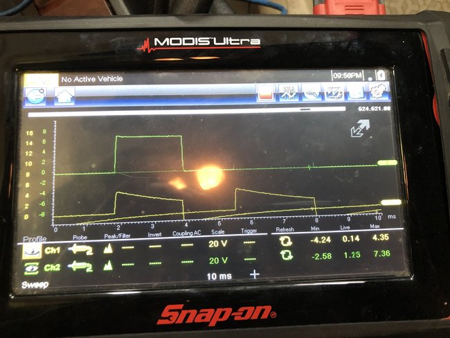

Scope pattern engine running, idle, orange = yellow.
Mar 6, 2020 at 10:39 AM
Good find. I am concerned that the short you found may have damaged the alternator.

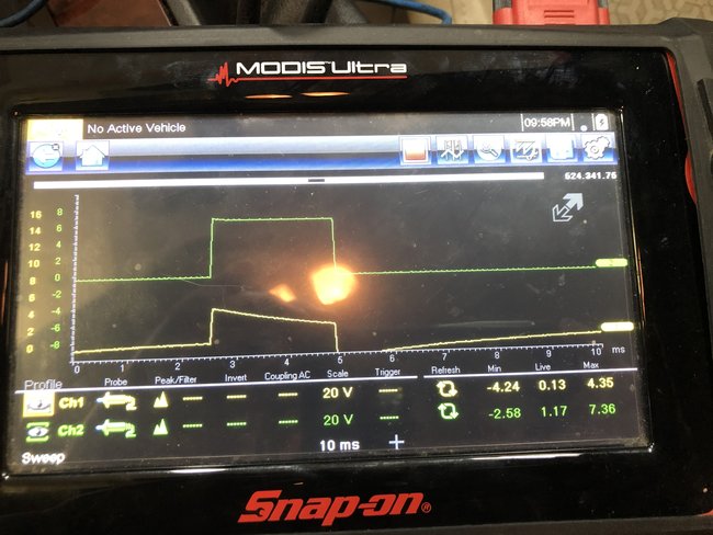

JAYJAY3
  • 24 POSTS
Yellow trace is orange wire.
Mar 7, 2020 at 9:03 AM
Yes, that is better. Looks good.
You only need a 194 bulb as it is 5 ohms. That is enough to load a circuit.
