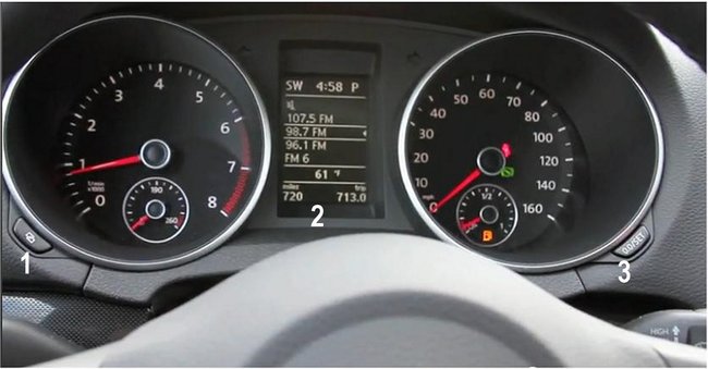

It’s not a code that mileage it showing. I can’t reset or view anything. I used my code reader to see if it had codes it has none.

I know it’s on the arm but can’t get to where I need to to reset anything.

I thought that was mileage. LOL
If you are still unable to reset the oil reset light, try disconnecting the battery for about ten minutes. See if that allows the system to reset.
After thought. Maybe it is still the older style set up. It may be an early production 2012. See if you have these buttons and if they work:
Using the buttons in the instrument cluster.
See Picture 1
- With the ignition switched off, hold the -3- button pressed.
- Switch ignition on.
- Release the button -3- and briefly press the button for setting the clock -1- one time.
The Service Interval Display is now in the Reset mode.
After a brief period, the display switches back to the normal display.
Note: You will lose your presets on the radio if you disconnect the battery.
