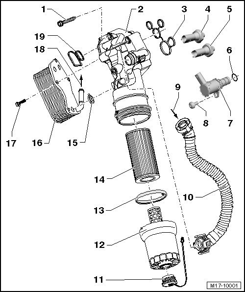

The filter housing has two o rings. One is for the drain at the bottom of the housing and the other goes on the threaded part that attaches to the engine. If you didn't remove the drain, there is no need to replace it. I attached a picture of the drain so you can see what I'm talking about. It is there to drain the housing before you remove it to help eliminate a mess.
Now, if you have a leak at one point, chances are you nicked the o ring when you installed it or you didn't lubricate the o ring with oil prior to installing. That can lead to the o ring binding when you screw the filter housing back on.
I hate to say it, but you need to remove the housing again. Inspect the o ring for any damage. Clean the housing as well as where it attaches. Lubricate the o ring with oil before you install it on the housing and installing it back on to the engine.

So I got a new gasket replaced it nothing was pinched or tore so don’t know what is going on I cleaned everything real good I managed to turn it little more not leaking as bad but still is housing and stuff is not cracked that I can see but I believe might need tightening more idk I can’t find the right oil filter cap to fit post to be 74mm but slips 73mm won’t fit
Jan 28, 2019 at 10:22 AM
  • 110,241 POSTS
Welcome back:
If it is not tight enough, it can leak. However, the canister can break if over tightened. The actual torque specs for the cap is as follows:
newton meter [N*m]:
25
foot-pound [ft*lbf]:
18.439053733
As far as the tool, are you using a standard oil filter tool designed for this vehicle?
I attached an exploded view of the filter housing. When you install the new o ring, make sure it is all the way up the threaded portion of the cap.
Jan 28, 2019 at 10:34 AM

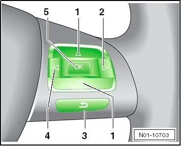

Here is what is listed in the manual:
RESETTING WITHOUT VEHICLE DIAGNOSIS TESTER
Service Interval Display, Resetting Without Vehicle Diagnosis Tester

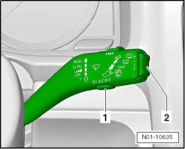

Using the rocker switch on the windshield wiper lever or the button in the multifunction steering wheel

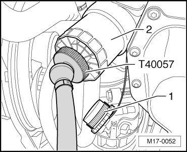

See picture 1
- Using the rocker switch, select the "settings" menu, or
See picture 2
- Using the button on the multifunction steering wheel, select the "settings" menu.
- Once in the "Service" submenu, select "Reset" and then press the OK button -1- either in the windshield wiper lever or in the multifunction steering wheel -5- to reset the service interval display.
- Press the OK button one more to confirm.

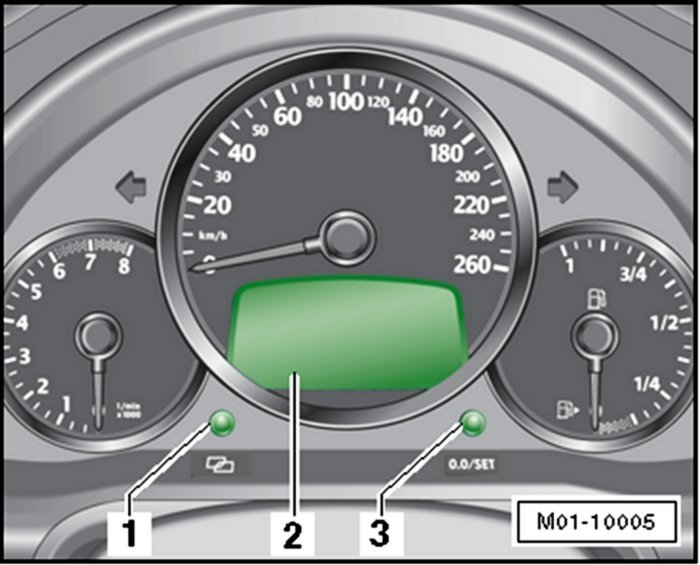

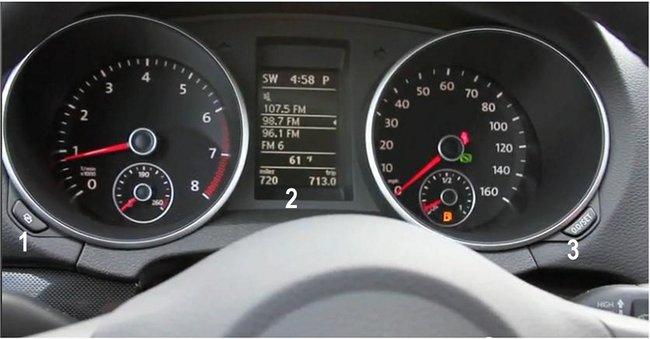

Using the buttons in the instrument cluster.
See picture 3
- With the ignition switched off, hold the -3- button pressed.
- Switch ignition on.
- Release the button -3- and briefly press the button for setting the clock -1- one time.
The Service Interval Display is now in the Reset mode.
After a brief period, the display switches back to the normal display.

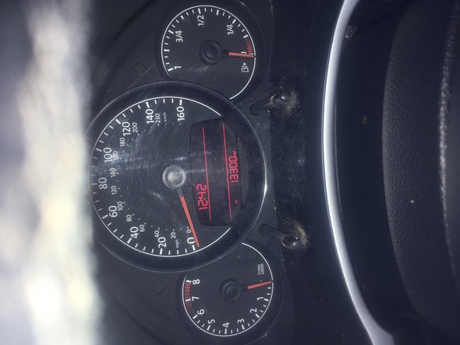

Yea, I tried I can’t get in settings. when I get to one thing it flashes that 1330 something. couldn’t reset it still shows thing I do not know.

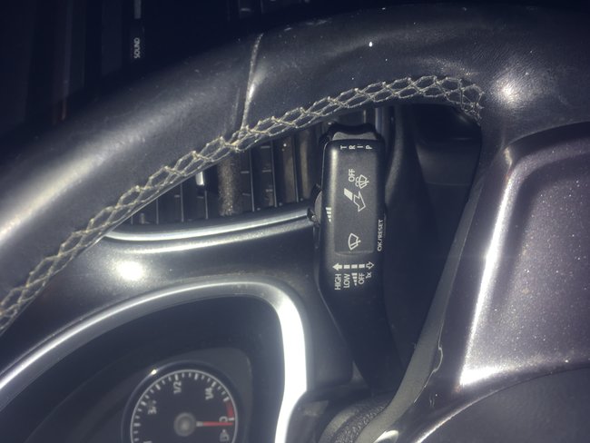

Mine doesn’t have anything on steering wheel or a menu thing.
Feb 1, 2019 at 1:44 PM
  • 110,241 POSTS
If it's flashing 1330, that is a diagnostic trouble code for a knock sensor. You should be able to get to menu to reset the oil maintenance light. All of the 2012 models have the reset menu. Yours is on the wiper arm.
Feb 1, 2019 at 1:54 PM
CORY2427
  • 293 POSTS
It’s not a code that mileage it showing. I can’t reset or view anything. I used my code reader to see if it had codes it has none.
Feb 1, 2019 at 2:15 PM
CORY2427
  • 293 POSTS
I know it’s on the arm but can’t get to where I need to to reset anything.
Feb 1, 2019 at 2:17 PM
  • 110,241 POSTS
I thought that was mileage. LOL
If you are still unable to reset the oil reset light, try disconnecting the battery for about ten minutes. See if that allows the system to reset.
After thought. Maybe it is still the older style set up. It may be an early production 2012. See if you have these buttons and if they work:
See Picture 1
Note: You will lose your presets on the radio if you disconnect the battery.
