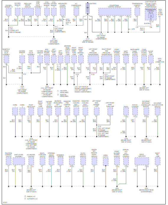

blower motor, read outs, radio, clock, and "always on" power port have all gone dead. then suddenly they came for a day but now have gone dark again. i have checkes fuses and graounds under the hood but have not been able to solve the problem. im good with cars but this one has me stumped.

Hi TCmann1969, my name is Alex and I will be helping you. Yes, this does sound like a loose ground. Here is a ground distribution chart for your vehicle. Look and see which ground is being used by all your affected circuits. Thanks, and let us know if you need any additional help.
