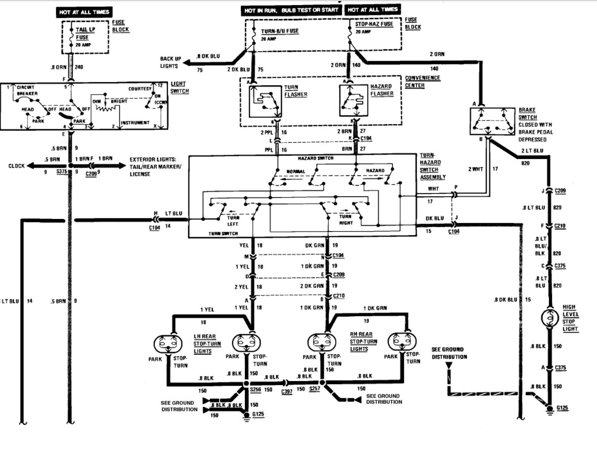

I have the SS model.
My center brake light does not work. There is power when the brake is pressed. I checked the socket offline and the bulb lights when power is applied. When I install a bulb into the socket the voltage goes to zero. The lower break lights work as they should.

It is just a straight wiring coming from the brake light switch to the top mounted brake light. Here is a wiring diagram (below) and a guide to help you do some testing and get the problem fixed.
Please run some tests and get back to us we are interested to see what it is.

Thank you, I'm going to try running a separate ground wire. I'll reply in a couple of days.

Problem solved. Using a multi meter to measure voltage can give misleading readings because the meter does NOT apply a load to the circuit. When I used a test light to measure the voltage at the light socket, I did not have any power at the light. A friend of mine who is an electrician told me the proper way to measure voltage is with a test light because it applies a load to the circuit. Using the wiring diagram from Ken, my friend noticed that the light switch has two contacts, one for normal brake lights and one for the center light. He snapped the switch several times and contact was made to the center light. All is well that ends well. Light now functioning correctly. Thanks for the help.
