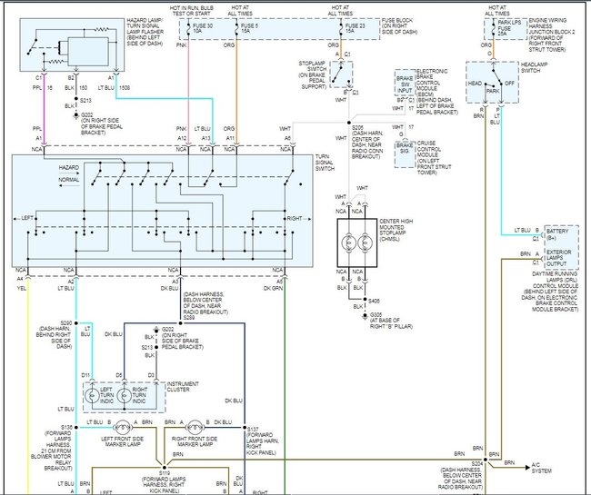

The brake lights stopped working. I checked the fuses and I replaced the brake light switch on the column, still no brake lights. Bulbs are ok as 4-way flashers, turn signals, and tail lights work. What's up? Why couldn't they have just left things easier to work on like the 55' chevy?

Sounds like you may have a bad turn signal switch.
Read the guide below on testing wiring first, it will help
The wiring diagrams for your exterior lights is are attached below

BMRFIXIT
  • 19,053 POSTS
Step on the brake and check the WHT wire connector A6 on the turn signal switch (should have power with brake on if not repair a short circuit between the two switches )
if have power then check for power at A4 YEL and A5 DK GRN
if no power suspect and replace the turn signal switch

  • 75,992 POSTS
The bottom brake lights circuit goes thru the turn/hazard switch you need to test this switch or replace it-

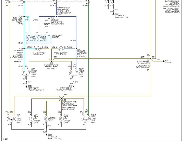

  • 75,992 POSTS
Did you check for power at the stop lamp socket when you removed it. If there's power you lost the ground point at rear body harness behind center of rear fascia-7cm from license lamp break out.
Recommend you check it -you probably wondering why the 3rd lite is coming oN it is bcuz the brake lites on the bottom has an open ground wire from S402 to S405 ground point.
In other words it has an open between the socket ground to chassis ground
Good Luck
