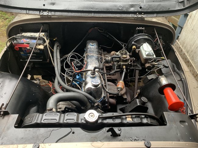

Hi all,
Rebuilt my 1979 Carter bbd on the 258 but have had endless issues trying to get it to run right. first it was warm-ups (fixed) then it was power.. which i seem to have a bit now. But i cant get it to idle consistently and there is a bad hesitation when trying to pull out in first gear along with any low rpm shifts. I need to floor it to get it to not die out. Any thoughts? I just did the wires and plugs and the dizzy ( which is running manifold vacuum) and just recently put in new PCV hose. Getting good fuel to carburetor so i am quite sure its just a carburetor issue. Trying to get the Jeep running before work on Monday lol.
Thanks for any replies!!

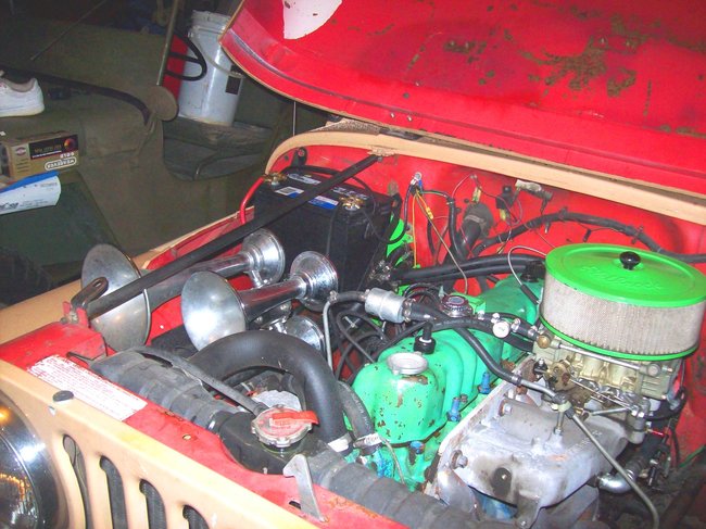

Think you could post good pictures of the left and right sides of your engine with the breather removed?
Also, lets lay the hood back on the windshield frame and remove the breather for a few good overhead shots.
The better the light the better!
Sometimes I can spot problems in the pictures, There's been 40 years that people could have monkeyed with stuff!

Hi CJ, thanks for the help. Hope these photos are what your looking for.
I got it to idle okay today redid the gaskets under the carburetor. The weird thing is the mixture screws are both backed way out. Completely maxed out. Wasn't like this prior to rebuild.

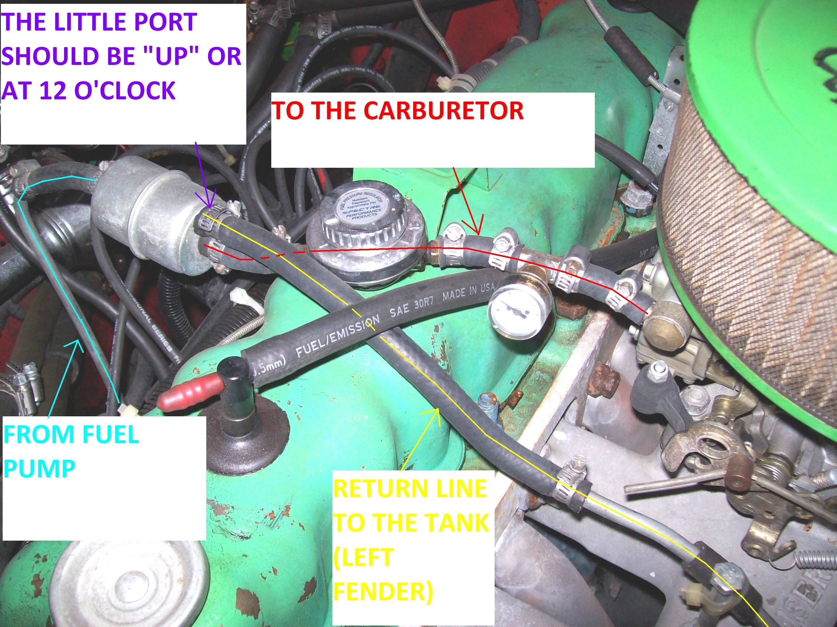

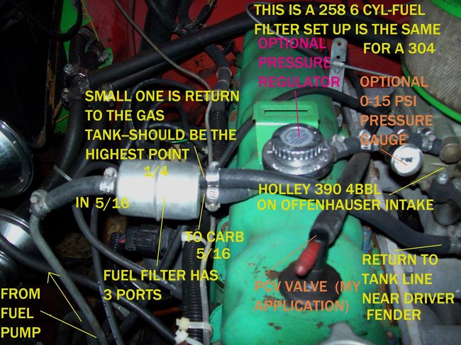

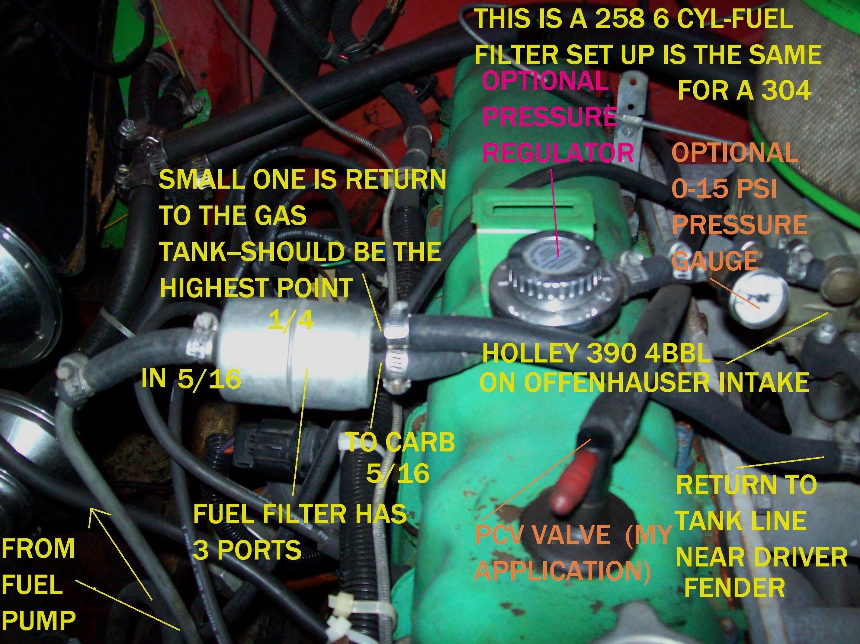

I'm going to give it to you as straight as I can.

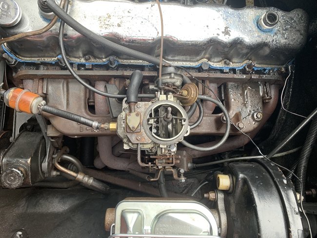

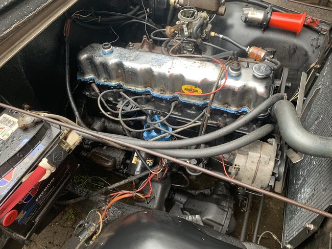

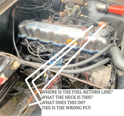

Pic 1) Obvious things I see. There are reasons why they should be like 2, 3, 4
Pic 2 and 3) Return line (with a few bells and whistles)

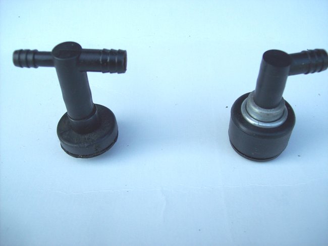

Pic 4) 1979 PCV is on the left.

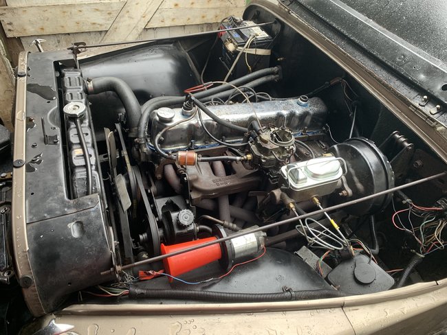

Pic 5) My 390
I've since replaced my intake manifold and installed a 390 Holley on mine. Doing so was very expensive, I do get 18 MPG (I had made up my mind I would make a MPG improvement no matter what it costs!)

Also the red line you see is for the breather hot air intake just wasn't hooked up with breather removed. The PO never had a fuel return line connected i see where they cut it though i will try to hook it back up.

The return line and correct fuel filter prevent the needle and seat from being overpowered with fuel pressure. Meaning fuel could be forced into the carburetor (overfilled) when the floats should have stopped it at the proper height and any overage being recycled to the tank.

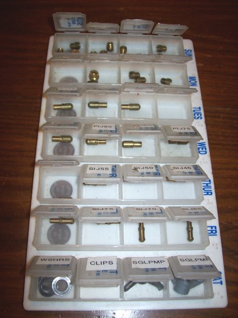

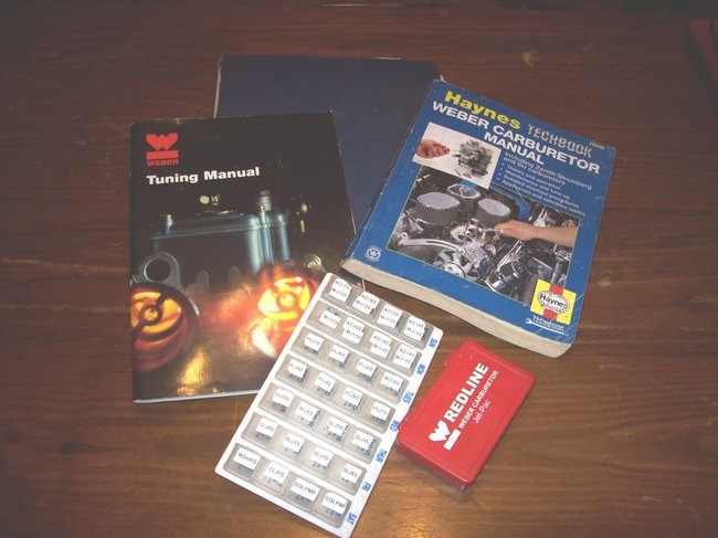

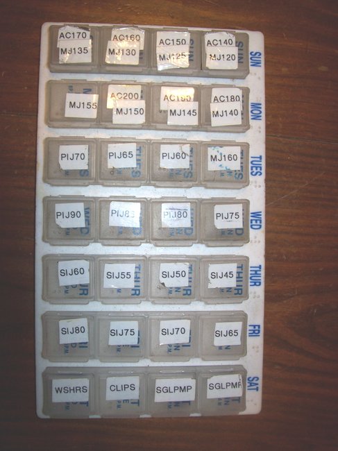

I ran a Weber 32/36 progressive for maybe a year. I never could tweak it to gain more MPGs (it's literature promised a 20% betterment).
After a few books (manuals) and pill organizer full of different sized jets, squirters, and various other tuning parts I threw in the towel and began investigating a 390 Holley.
This may help, I need to re-write it specifically for a 258, so let's disregard the 304 translation! I answered that one a long while back.
https://www.2carpros.com/questions/jeep-cj7-1985-jeep-cj7-stalls-when-hot
With the Weber, you are going to find that the "ported" vacuum to the distributor's vacuum advance will work the best.
I also prefer manual chokes, there's normally less to go wrong and "stick". I'm the one in charge of when it's on, off, cracked open!
Pics below were my records as to how I tried to tune the ole Weber and did other Jeep maintenance along the way.
As you can gather I'm not the one to give Weber advise!
The Medic
