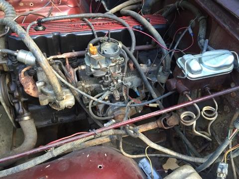

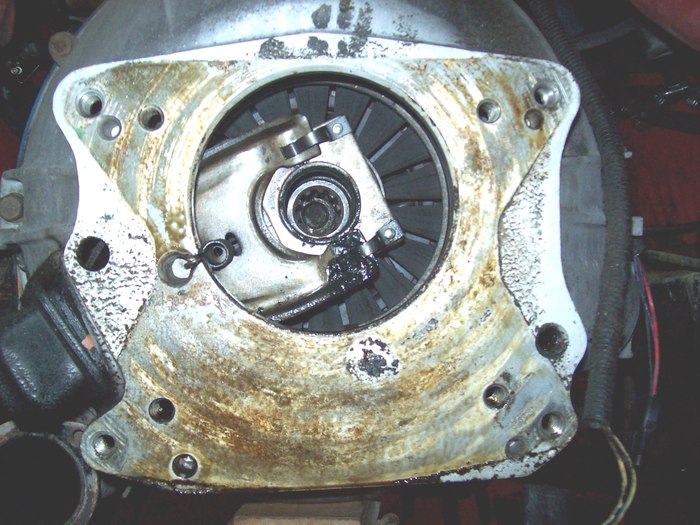

Took to repair shop they said it was the rear main seal. They replaced it next day got it back drove 14 miles lost 3 qt put 3qt back drove back to shop they were stunned,Left it with them another day they said they must have nicked it or it came from the factory that way so they replaced it .Day two call me up and said bad news that the rear main barring was worn and they had to replace it to .Do you think they should have know this the first time? The Mechanic said the first time they had to pull the transmission to do the job. i fell some think is wrong. please your opinion. Thank You Scott. p.s.They charged 690.00 then 390.00 total : 1080 :(

....................AND MR. BEARING'S "TOP HALF" COULDA BEEN INSTALLED BY DROPPING THE CRANK, EVER SO SLIGHTLY, BY LOOSENING THE OTHER MAIN BEARING CAPS
..........YES, THIS IS A 2 PIECE SEAL
I CANNOT SEE THAT MUCH OIL LOSS......OTHER THAN THE WRENCH'S OPERATOR ERROR.........THE DARN CRANK WOULDA BEEN-A-FLOPPIN' FOR THAT TO HAPPEN
MAYBE THEY DROVE THE TOP HALF IN BACKWARDS?

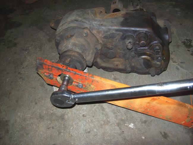

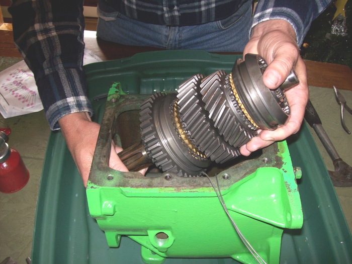

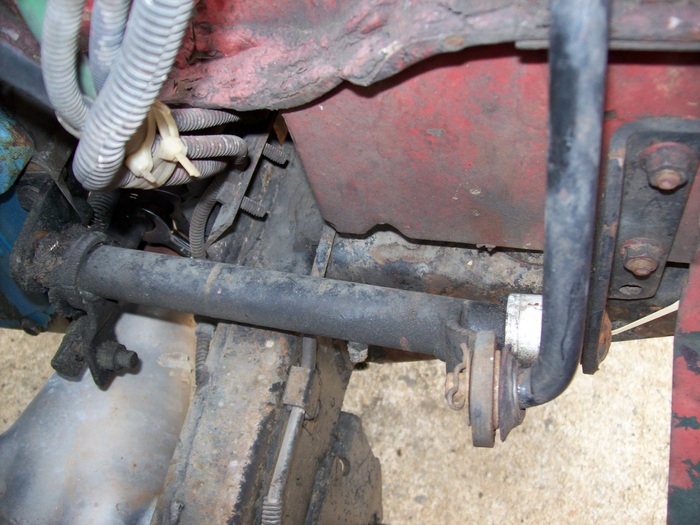

YOU CAN SEE IN THIS PIC THAT THE REAR MAIN IS NOT THE "THRUST BEARING"-----DROPPING THE CRANK "A WEE BIT" WOULDA GAINED ENOUGH CLEARANCE TO INSTALL THE BEARING
IF THEY WERE NOT SEASONED FOLKS W/ A CJ
............I'D WORRY ABOUT THE CONDITION OF THE OTHER BEARINGS

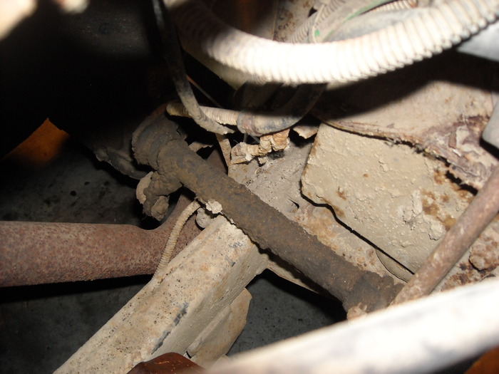

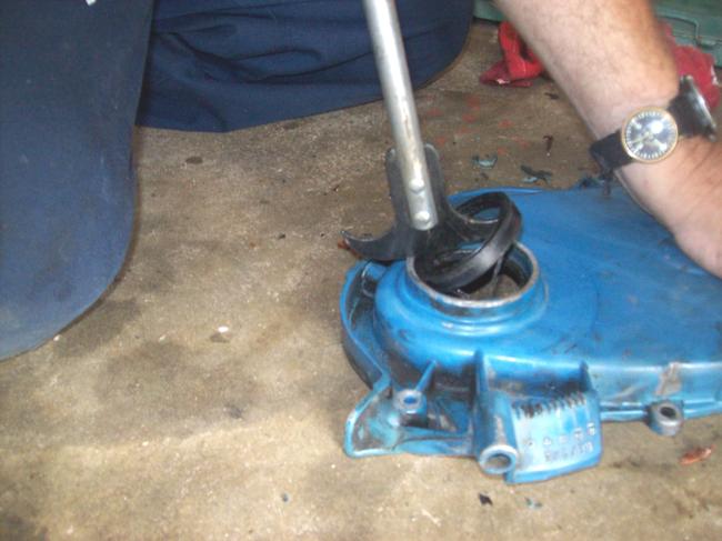

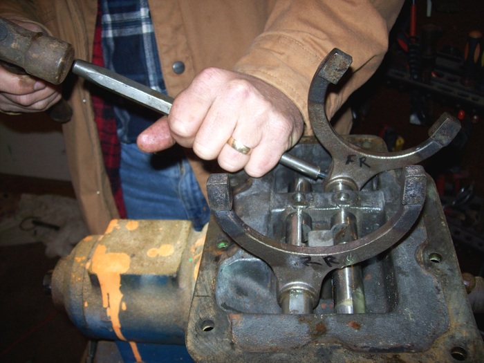

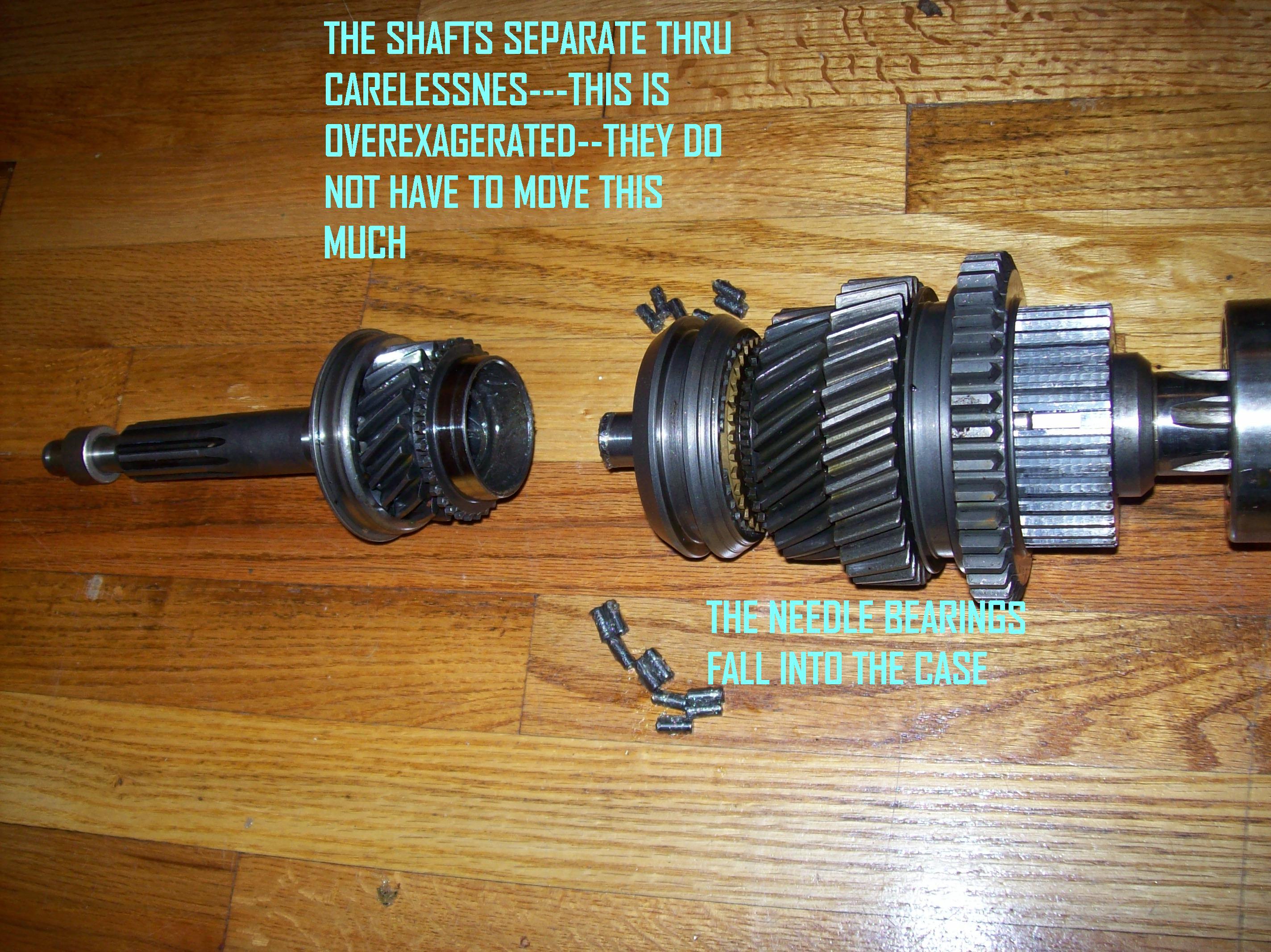

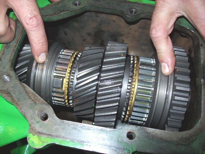

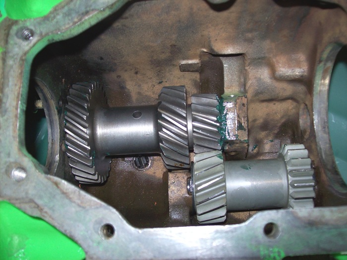

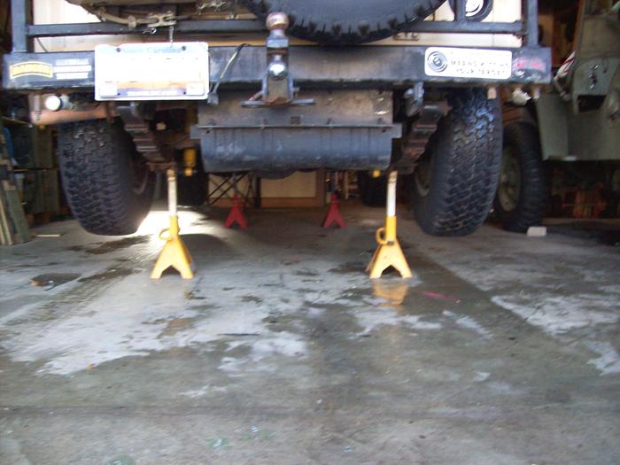

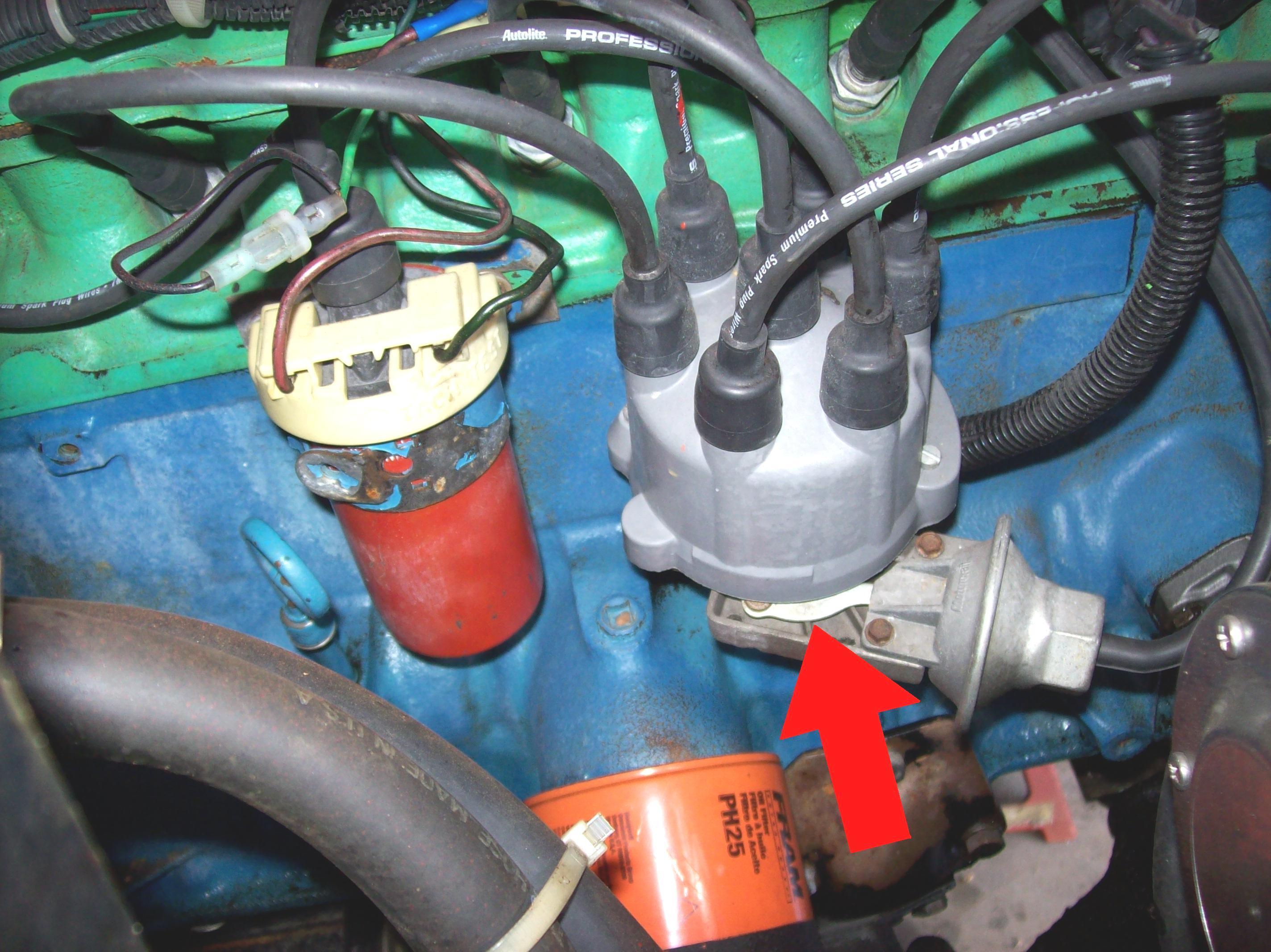

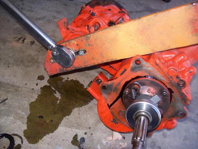

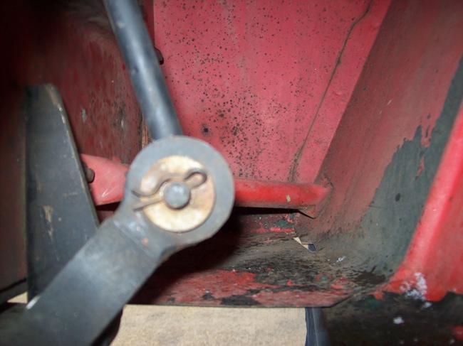

............IF THEY TOOK THE TRANSFER CASE OFF OF THE TRANNY (WITHOUT SAFEGUARDS)......I'D WORRY ABOUT PICS 2-4
