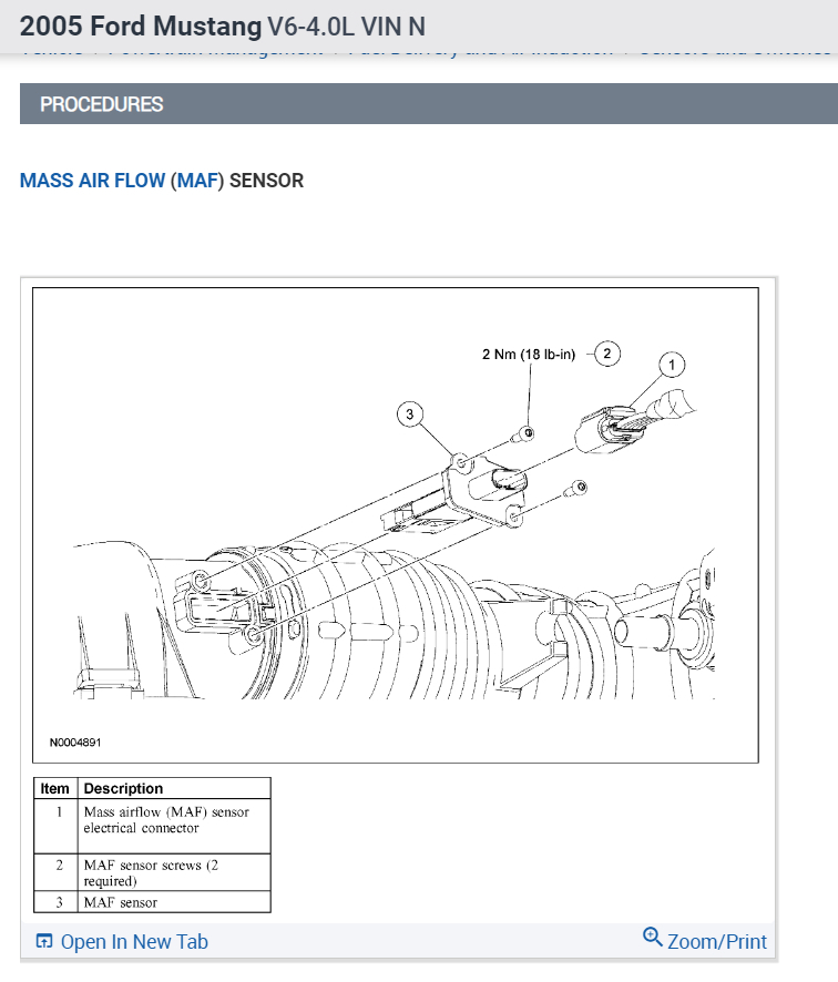

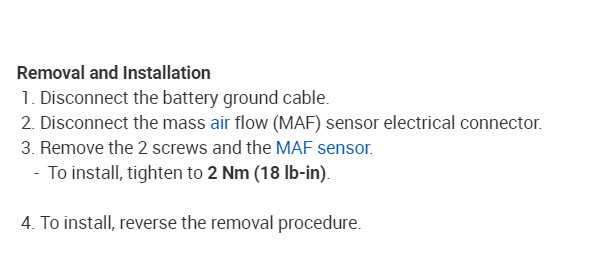

Is the MAF sensor plugged in? I have seen this sensor go bad and cause this issue. Check out the images (below). Please let us know how it goes.
