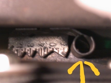

I have had to adjust timing all the way to picture shown to get it to idle this low right in the middle of that circle piece of the timing bracket piece.

First, on the picture you posted, the timing is retarded,not advanced as it should be. It should be up on the scale at about 10 degrees. Can you set the timing there?
I think a lot of your issue starting has to do with the timing. When you get the timing correct, it should start much better.

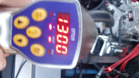

So I adjusted the timing to 10 degrees and she starts and runs pretty decent so the starting issue is solved, but now my high idle is back as shown in the video without vacuum advance it's around 1200 1300-ish when on the EGR controlled advance it goes up a bit and when I'm on the non EGR side it shoots up to 1600-ish the car no longer has any EGR equipment on it I believe. There is some weird vacuum valve piece on the passenger side manifold that hooked to the EGR on the intake before I swapped the intake though and I just have it unhooked and the hole on it is plugged.

The choke is partially closed which means the high idle cam is holding the idle up.
If you open the choke and then then the idle should come down to around 650. Make sure you hook up the vacuum advance as well.
Then when it is lowered to that, adjust the idle mixture screws for the smoothest idle.
