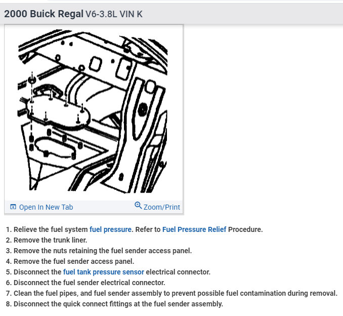

fuel guage not working properly. Heater is also blowing fuse when turned on.
Feb 20, 2015 at 8:58 AM
SQM
  • 6,383 POSTS

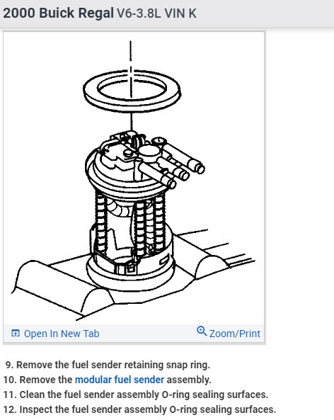

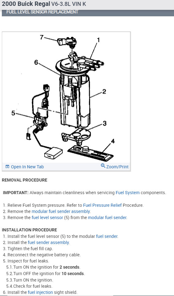

The fuel level sensor is located on the fuel pump assembly in the fuel tank.
In order to replace that part, you will have to access the fuel pump.
On this vehicle there is an access port in the trunk above the fuel pump. Remove the carpet lining in the trunk and that will uncover the access port.
Simply remove cover to have access to the pump.
https://www.2carpros.com/articles/how-to-replace-an-electric-fuel-pump
