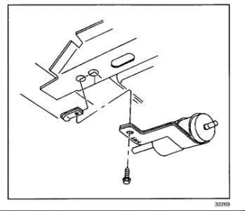

Does my 2001 Buick Regal have a fuel filter?
A month ago it showed an EVAP Emissions code {& the local Auto Parts store employee could not tell me what that meant specifically} in the last week it has started to intermittently hesitate. Would replacing the EVAP Canister Purge Solenoid Valve be a solution?

Yes the Regal does have a filter.
What is the code for the evap?

I would check the fuel pressure before and then after the filter replacement regardless of the code.
https://images.2carpros.com/forum/automotive_pictures/30961_ff_5.jpg
Look along the frame rail on thr rear driver's side.
