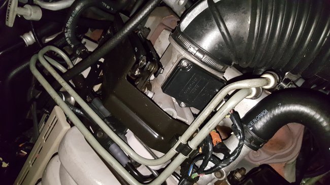

When I drive my car for a long period of time. Then instantly when I come to a stop light the car dies. Then I started back up it startles and putt, putt and I smell gas. So I let it sit for a bout 1 minute and then it runs smooth again.

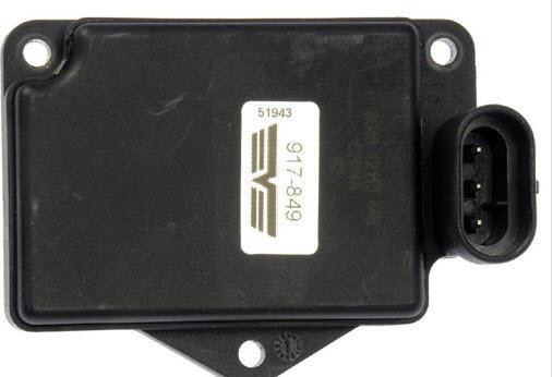

I got a diagnostic and they said it's the mass flow sensor. They said 282.00 dollars to fix it is it possible to do it myself.

Yes that is the part between the air filter and engine, two clamps to remove it and unplug it. Pic is what it looks like It may be in air cleaner this is for a 3.1L engine

I change it. My car is still doing the same thing when I turn the car on and unplug the mass airflow sensor connector the car immediately shuts off and won't start. I read in another post that if it does that than its not the mass airflow sensor it's something else. Any help please
