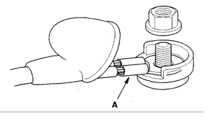

Drove in to class today and when I came out it would not start. When I turned the switch nothing happened, lights came on including dash. When I turn the key there is one faint click but no attempt for the starter to turn over.
Battery terminals look good. Was wondering if this is a loose wire or if it is the coil?

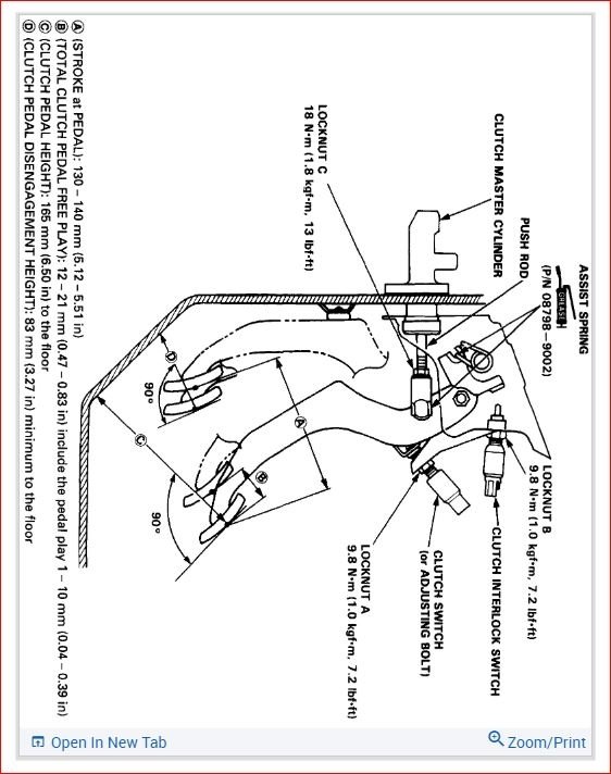

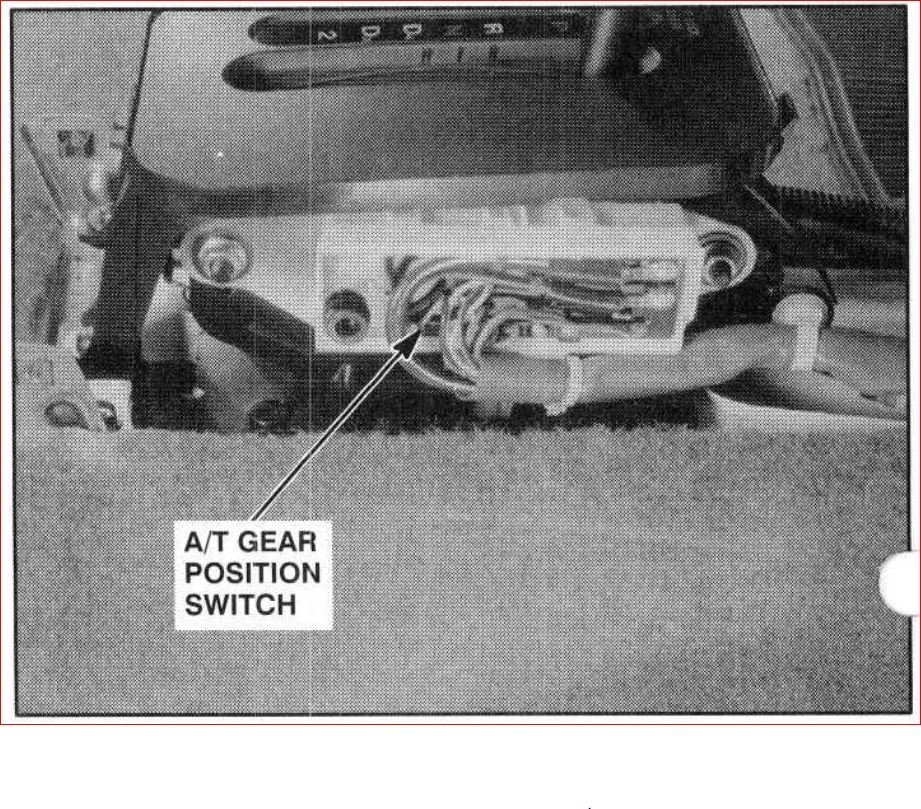

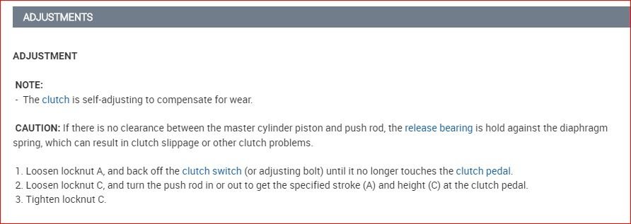

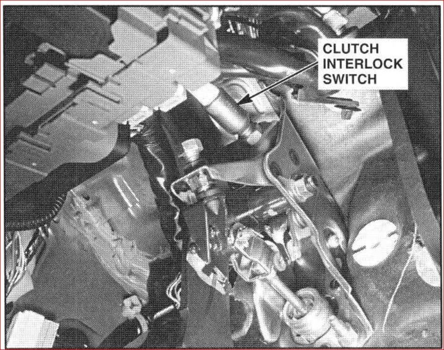

Is this car a manual transmission? If so, I have seen where the clutch safety switch (located at the end of the clutch pedal) goes bad on Civics. When that switch goes, the car will not start. You can unplug it and use a piece of wire to jump the two terminals down there and the car will start. That is the first thing that I would check because it is really easy to do.
If it is an automatic, then try putting it in neutral and cranking it. If it starts then, then the problem is either that the shifter was not perfectly seated in 'P' or the range switch (aka: park/neutral switch) is out of adjustment or failing. Its job is to only let the car start in P or N.
If that does not solve the problem, then we get into checking to see that power is getting to the starter and so forth. Let us know.

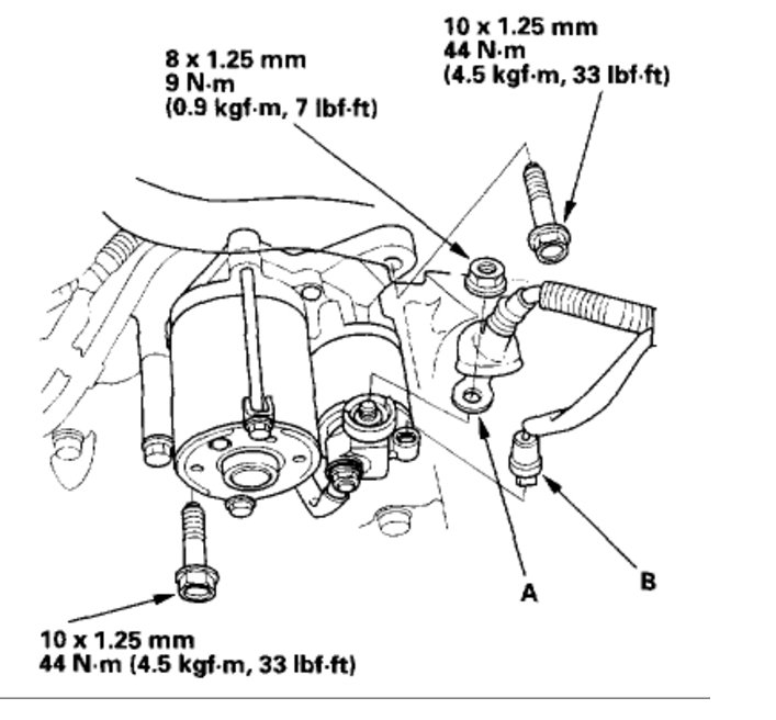

It sounds like you have a starter motor that is going out when it gets hot which is a sign the starter is going bad. But to be sure please follow this guide which will show you how to use a test light and check the trigger signal at the starter to confirm the failure.
and
https://www.2carpros.com/articles/how-a-starter-and-solenoid-works
Here is how to change the starter on your car (below):

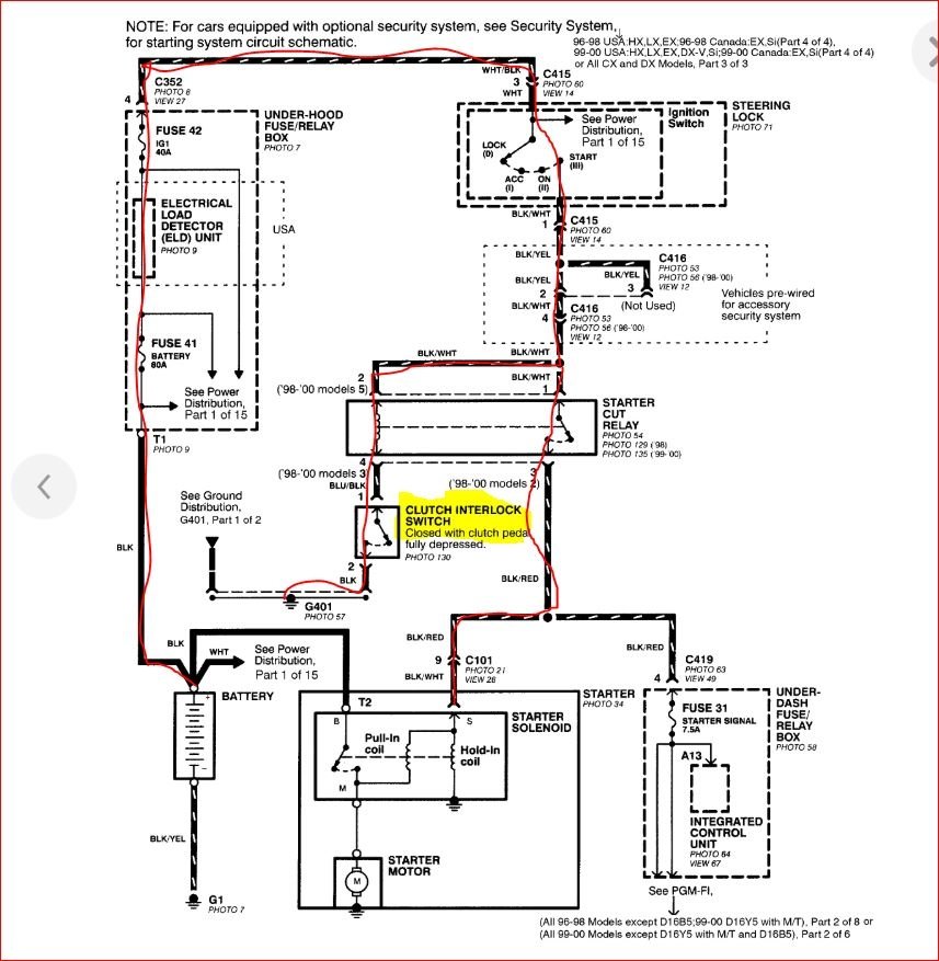

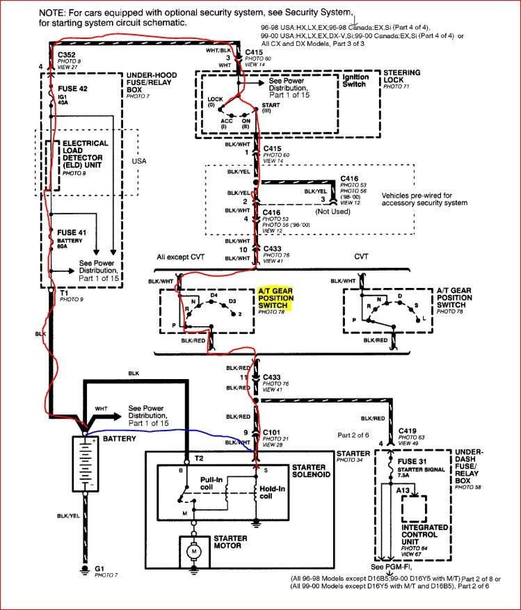

Battery good, turn key, nothing. Shorted out the solenoid and held the key to start and the car started. When turned off the car it would not start again until shorted solenoid.
Any ideas where I should diagnosis next?
Jan 4, 2021 at 3:33 AM (Merged)
Hi Yonex,
I suspect you park/neutral position switch is the issue. Basically you are applying power to the solenoid and it bypasses all the wiring and fuses including the P/N switch. I attached a wiring diagram that I traced in red the normal flow of power. In blue is what you are doing when you jump to the solenoid.
If the vehicle doesn't think it is in park or neutral then it will not allow the start. Try shifting to Neutral and see if it starts. Sometimes it is just the park position on the switch itself that gets worn out and so the PCM doesn't see park but it does see Neutral.
Let me know if this makes sense or if you have any other questions.

No problem at all. It is basically the same principal except the switch is called the clutch interlock. This tells the PCM that the clutch is depressed which says it is okay to start the vehicle. If you look under the dash on the driver side on the clutch pedal arm, you will see the switch. There is a chance that it is just out of adjustment so I included that procedure. It is worth trying before replacing the sensor.

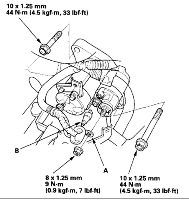

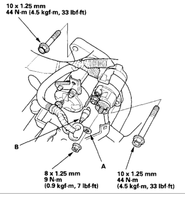

Try a voltage drop test to starter. Place leads of volt meter one on batt positive the other on starter pos. terminal. Start what does meter read?
Let me know

The positive terminal is the bolt on cable. The plugin is the solenoid wire.
If the voltage is similar to battery voltage, disconnect the solenoid connector and attach a remote wire. Apply voltage to wire and see if starter can be cranked.

Is the car equipped with neutral start switch? Switch on clutch pedal, similar to brake switch.
