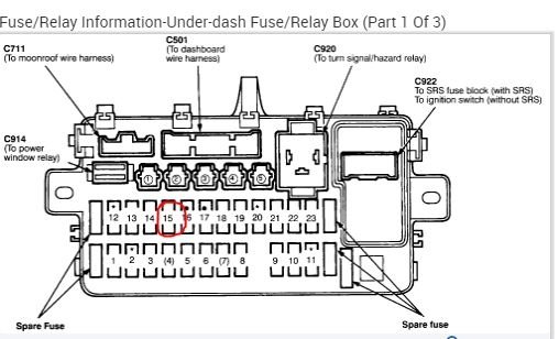

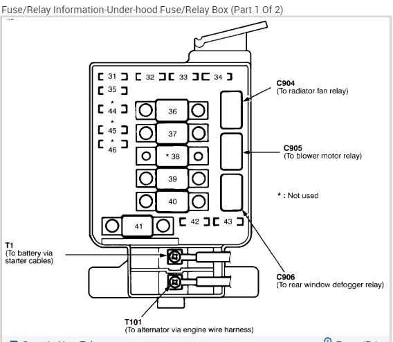

The car wouldn’t turn back on after being turned off. At first I thought it was the battery because it had no power, has a voltage of 13.16. Then with a screwdriver on the starter and the car turned on. Fuse 15 is blown from the hood fuse box. Not sure if that means anything. Any suggestion? Not my car it’s my dad's.
Jun 4, 2019 at 10:20 AM
  • 110,248 POSTS
Welcome to 2CarPros.

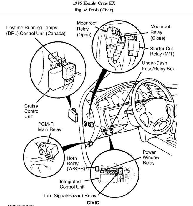

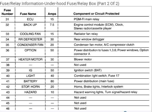

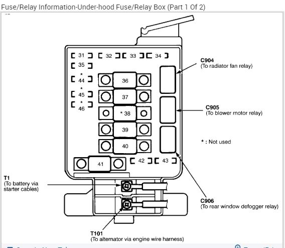

I attached a picture and the legend for the under hood fuse box. There is no fuse 15. Do you mean it's a 15 amp fuse? Take a look at the picture and the legend. It will indicate what the fuse is for. Let me know if you are seeing something different or have questions. Also, if you look at picture 3, it shows the fuse box in the vehicle and I circled fuse 15.
Let me know what you are dealing with.

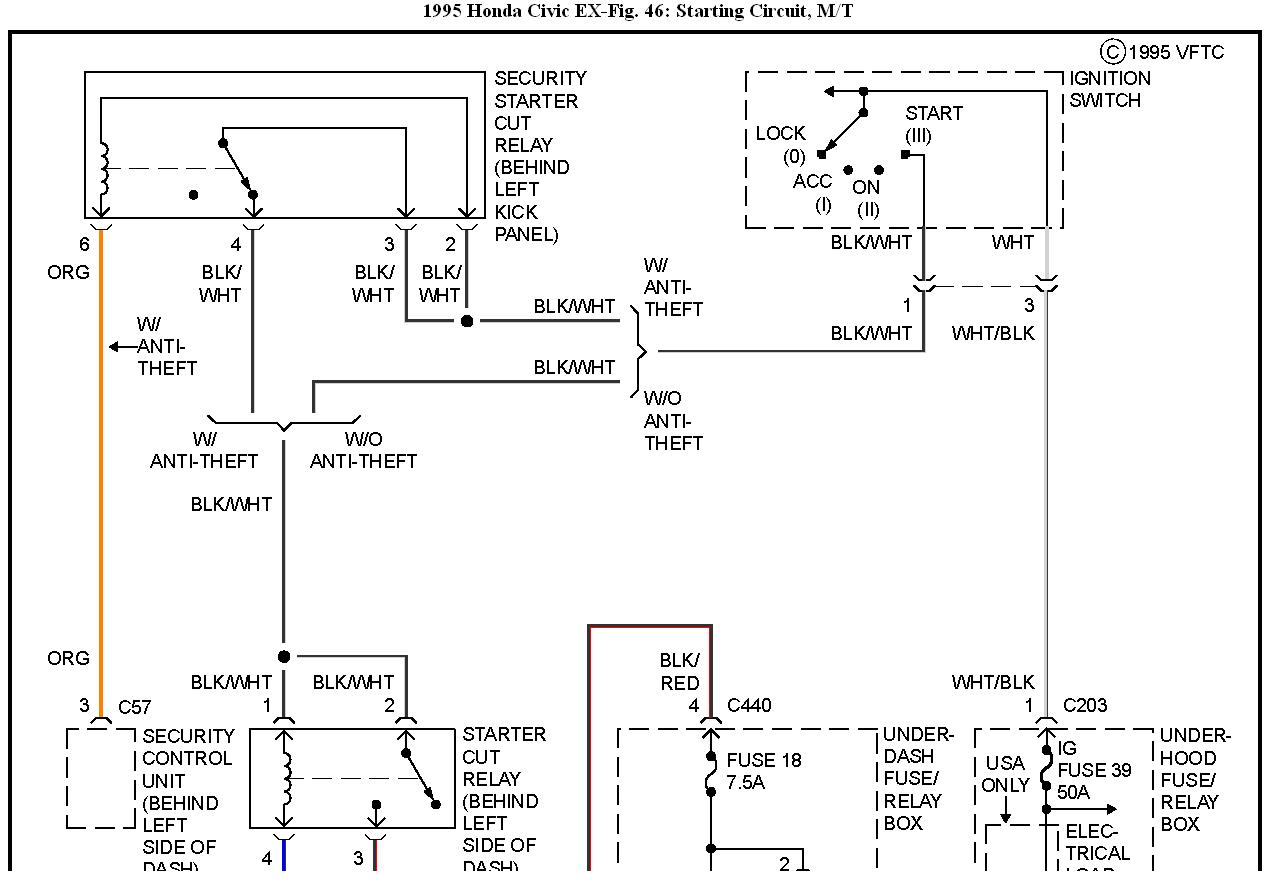

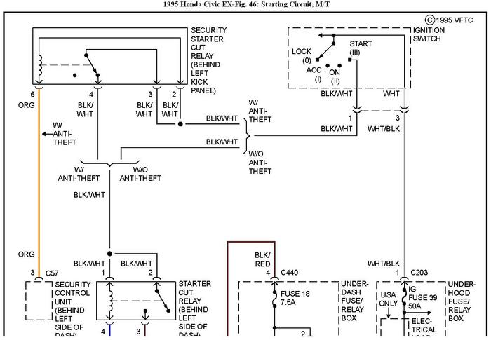

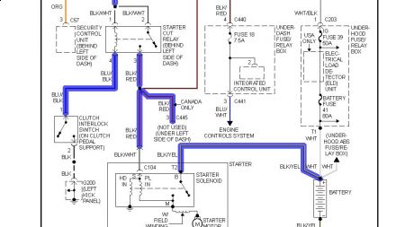

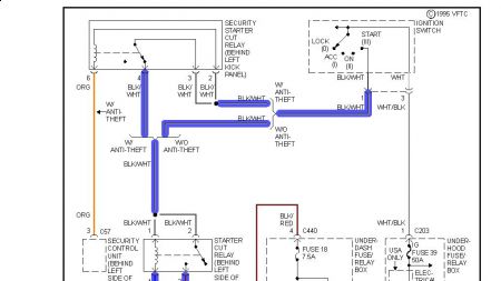

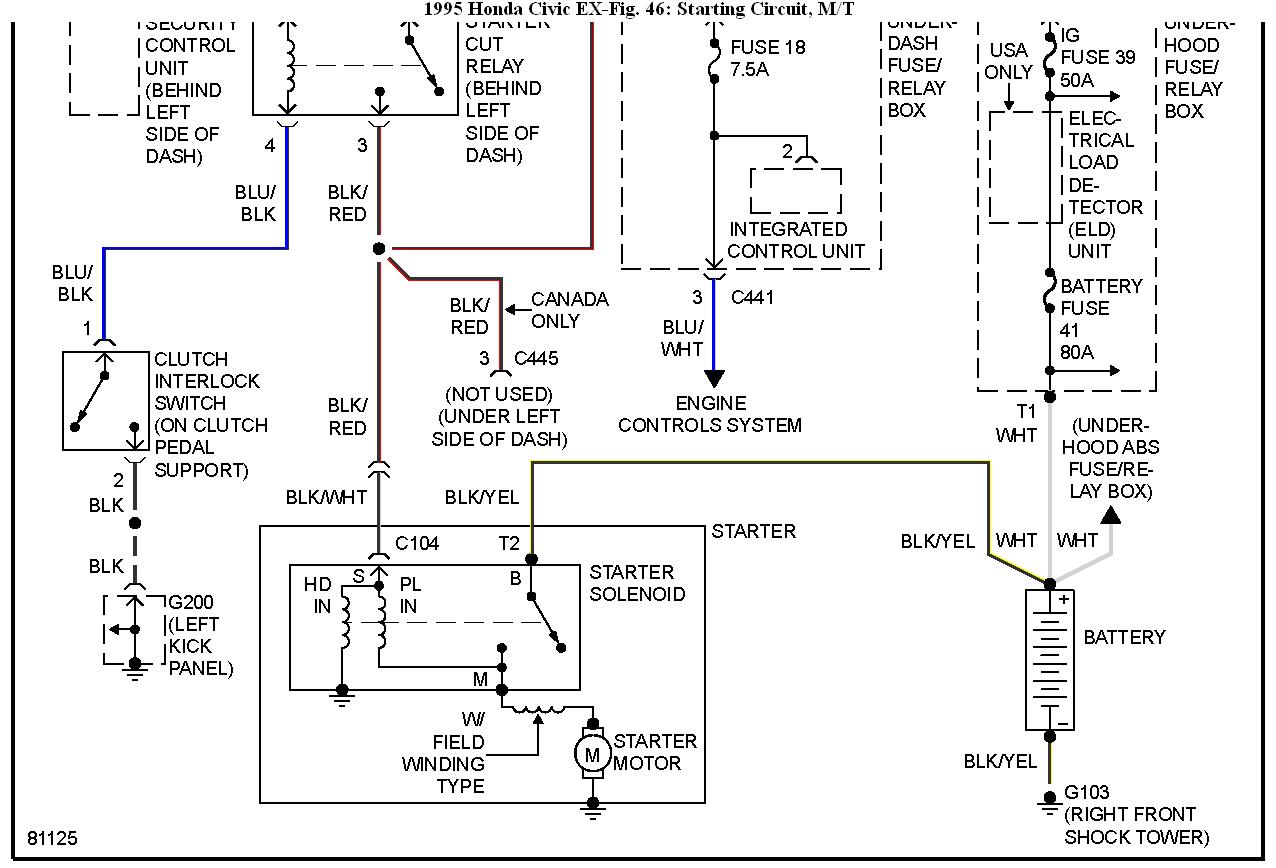

Attached are the starting schematics. Is vehicle equipped with anti-theft system?
Use a test lamp to check for battery voltage at the starter solenoid wire when key is turned to start.
Swap the starter relay and see if it works.

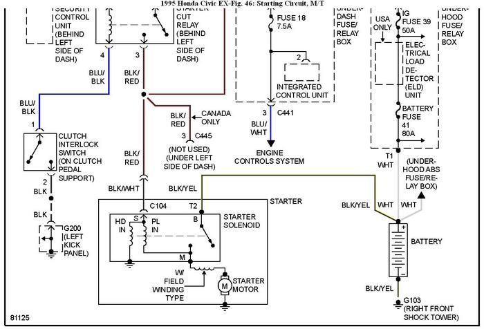

There is a possibility the rebuilt starter is at fault. disconnect the starter solnoid wire and use a fused wire to apply battery voltage to the solenoid terminal to test if the starter works.

Main relay is not connected to the starting circuit. Is vehicle equipped with anti-theft system?
Check the starter relay.

Starter relay is the component that you are hearing clicking when the key is turned.
Electrical faults can occur anytime so it is not surprising.
If there is an anti-theft system, ensure it has not been triggerred. It might not have been used but many people tends to forget about them until it starts to give trouble. It has a another relay for the system, behind left kick panel.

If the starter has power to it and is not cranking, it could be the wires are weak inbetween and this is not sufficnet to crnk the starter. Did you try the method of applying direct battery voltage to the starter solenoid to test if it works?

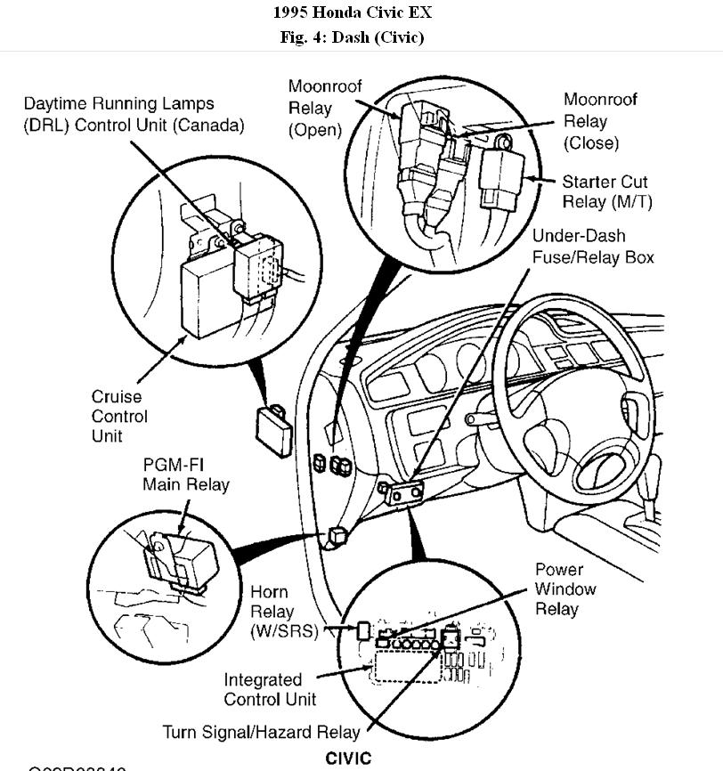

Check and test the starter cut relay and other relays involved, clutch switch in the circuit to inlcude all the fuses-See below
https://images.2carpros.com/forum/automotive_pictures/12900_s1_38.jpg
https://images.2carpros.com/forum/automotive_pictures/12900_s2_35.jpg

the only way you can find out if it is starter relay is to test to see if power is going to it.check items in pick as well as security starter cut relay behind lh kick panel
