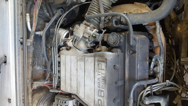

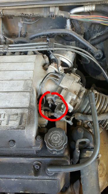

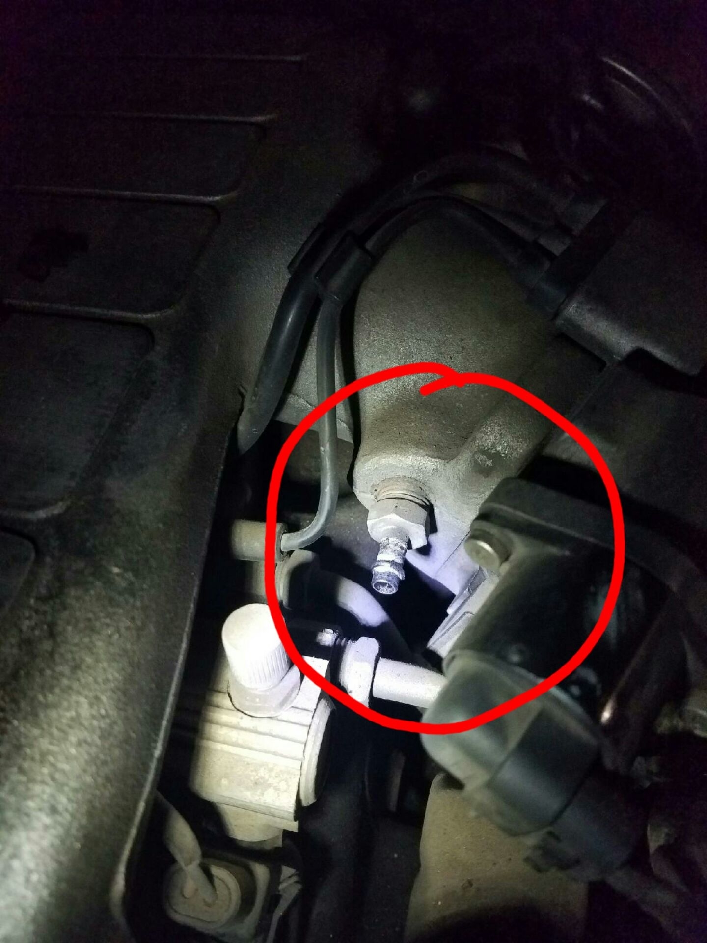

Car started giving me trouble about a week and a half ago, that is when I noticed the missing vacuum line. I can fix it is just cannot seem to figure out what the other side connects to. When I try to start my car it starts to smell a lot like gasoline and the part with the missing line starts to leak gas. Please help! thank you.

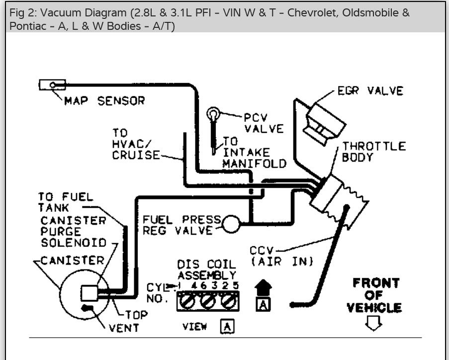

see picture for vacuum routing. it may go to canister purge valve which is on right side of engine compartment by radiator.
