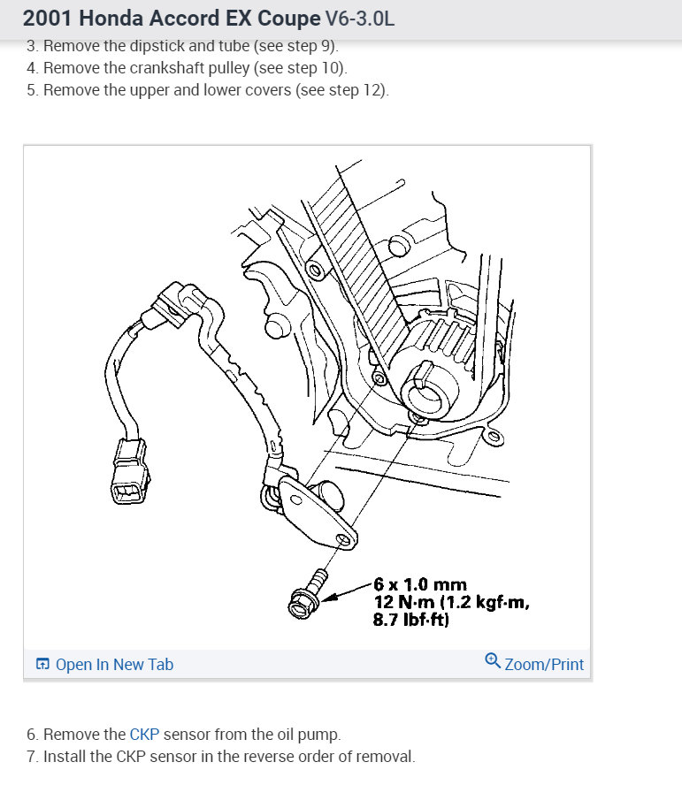

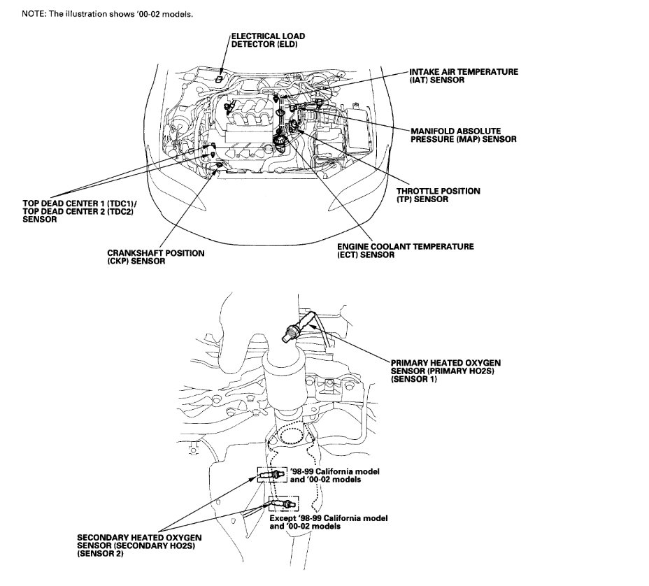

I have seen the crankshaft angle sensor go out and cause this issue, the difficult part is when the sensor goes out it does not throw a trouble code. Here is the location so you can check the connection/sensor. Check out the diagrams (below). Please let us know what happens.
Jul 5, 2022 at 5:31 AM
