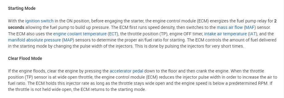

I want you to do a test drive for me and return to your house so that if this doesn't work, you are not strained somewhere. However, I want you to get it so it doesn't start again and then hold the accelerator down to the floor again. If this works then you more than likely have leaking injectors or some other fuel issue causing too much fuel to get into the cylinders.
What you are doing when you press the accelerator to the floor during cranking is called "Clear Flood Mode." What this means is when the pedal is on the floor during cranking the PCM cuts the injector pulses so that it doesn't add more fuel. If the vehicle starts during this then that means there was already fuel in the cylinders. The fact that it starts after 20 minutes just means that is how much time it takes for the excess fuel to evaporate from the cylinders.
Under normal starting mode, the PCM reads the ambient air temp and determines how much fuel to use. When it is cold it uses a little more fuel to get the engine running hotter as quickly as possible. The fact that it won't restart in cold temp shows that there is not only the additional fuel from the PCM due to the cold temp but the leaking injectors have flooded the engine.
If performing a clear flood starts the engine this is absolutely an acceptable way to get the engine started as that is what it is designed for. In fact, it is better for it then just letting it crank with all that fuel because it is going to foul the plugs.

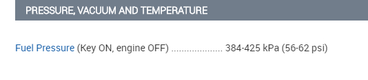

I would suggest monitoring fuel pressure when you shut it off and I suspect you will see it bleed off once you shut it down. It will bleed down normally but I would think it would take a while. Leaking injectors will cause it to drop pretty quickly.
I attached the info about this and the fuel pressure spec to see if it is low.
Let me know if you have questions. Thanks
