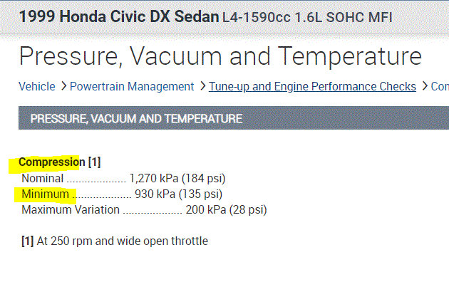

I noticed it has been a few days since we made contact with you. Have you made any progress? As far as the oil in the spark plug wells, that could have damaged the wires, but shouldn't have caused a no start.
As aforementioned, it could be a head gasket. Is it possible for you to record the engine cranking so I can hear it? Hopefully, if there is low compression in a couple of the cylinders, I'll be able to recognize it.
Next, most times when a vehicle fails to start, it is related to an ignition issue (no spark to plugs) or a fuel-related issue. See if it starts for a couple of seconds using starting fluid and then stalls. If it does, then we know it's fuel-related. If it doesn't, then we need to check for spark at the plugs.
Here are three links you may find helpful. One explains the most common causes of a crank no start condition, one is how to check spark, and the other deals with checking fuel pressure.
If you suspect it is a head gasket, we will need to check engine compression to confirm. Here is a link that explains how it's done:
I attached the compression specs below for this vehicle. Again, not always, but most times, I can tell if there is a timing or compression issue just by hearing it crank. So if possible, upload a video of it cranking for me to hear.
See Pic below.
