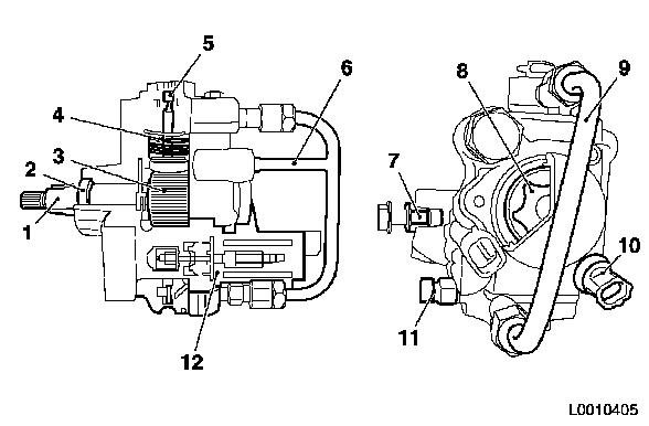

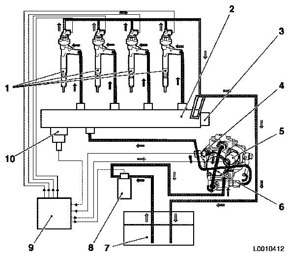

It has to have a fuel pump, the older diesels will have two pumps a lift pump to pull the fuel out of the tank and push it to the injection pump that feeds the injectors. On some vehicles these are individual pumps on others they are combined into the same unit.
On your Astra you have a common rail direct injection fuel system, these use a variation of this system but at much higher injector pressures. Yours has the low pressure feed pump and the high pressure pump combined in one unit.
You mentioned that you had not changed the fuel filter but then when you did it ran good for a while, that is what leads me to the pump issue. It is also possible that the filter is plugged again. In the first image is a breakdown of the fuel system on that engine. The filter (8) is a suction side filter. If it was plugged you would get no or very little flow. There is also a pressure regulator (3) and a pressure sensor (10). The second image is the actual pump, it is driven off the timing belt, item 8 is the low pressure suction pump and 4 shows one of the high pressure pistons (it has 2)
A scan tool should show the pressure the pump is or is not delivering. However your idea of starting with a filter is a good one.
