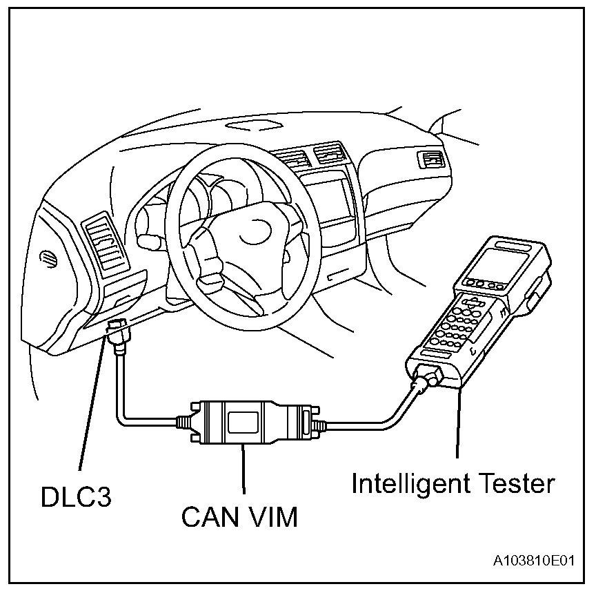

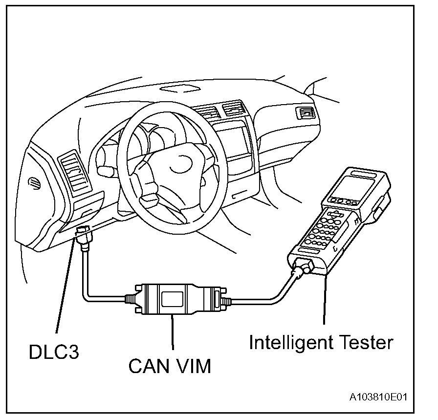

ON-VEHICLE INSPECTION
1. CHECK FUEL PUMP OPERATION AND FOR FUEL LEAKS
pic 1
a. Connect the intelligent tester to the DLC3.
1. Turn the engine switch on (IG).
NOTE: Do not start the engine.
2. Push the intelligent tester main switch ON.
3. Select the following menus: DIAGNOSIS / ENHANCED OBD II / ACTIVE TEST / FUEL PUMP/SPD.
b. Check the fuel pump operation.
1. Check for pressure in the fuel inlet tube from the fuel line. Check that the sound of fuel flowing in the fuel tank can be heard.
If there is no sound, check the integration relay, fuel pump, ECM and wiring connector.
c. Check for fuel leaks.
1. Check that there are no fuel leaks after performing maintenance anywhere on the system.
If there is a fuel leak, repair or replace parts as necessary.

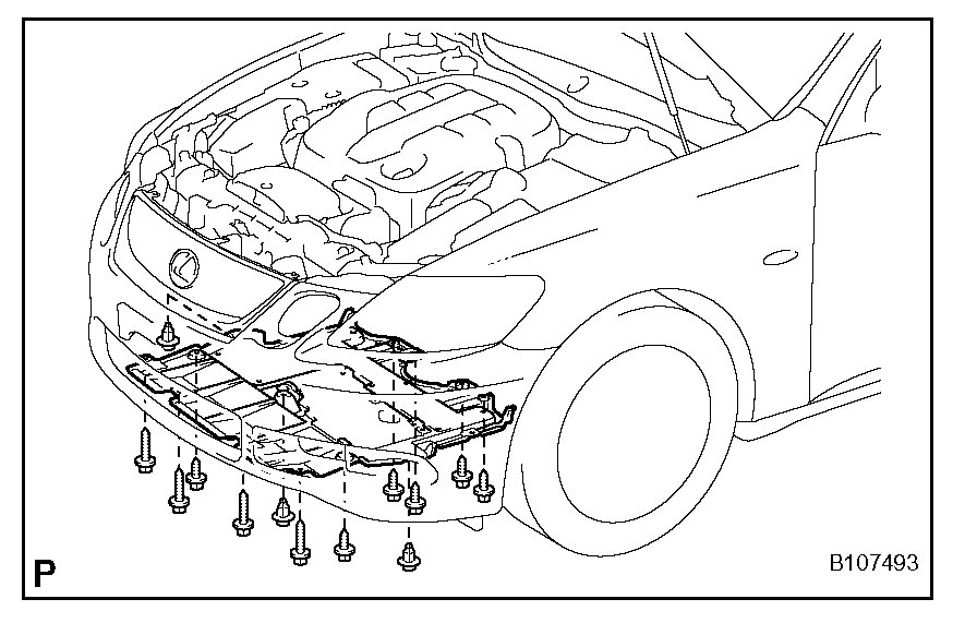

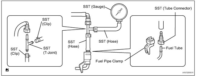

2. CHECK FUEL PRESSURE (LOW PRESSURE SIDE)
a. Check that the battery positive voltage is above 12 V.
b. Discharge the fuel system pressure.
c. Disconnect the cable from the negative (-) battery terminal.
CAUTION: Wait at least 90 seconds after disconnecting the cable from the negative (-) battery terminal to prevent airbag and seat belt pretensioner activation.

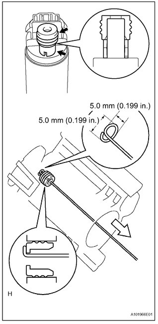

d. Pinch and pull the fuel pump main tube.
CAUTION:
- Always read the precautions before disconnecting the fuel tube connector (quick type).
- The fuel tube may spray fuel as a result of pressure that remains in the tube. Do not allow fuel to be sprayed in the engine compartment.
pic 2

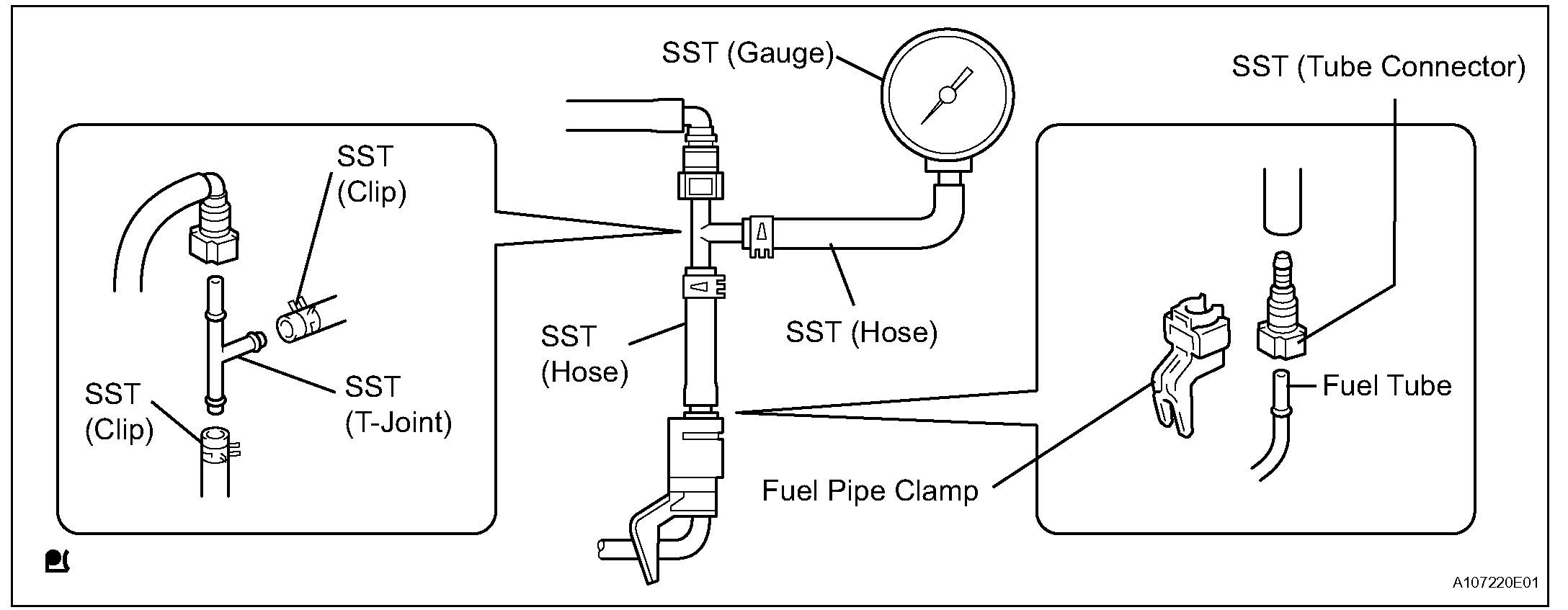

e. Install SST (pressure gauge) as shown in the illustration.
SST 09268-41048 (90467-13001, 95336-08070, 09268-41500), 09268-45014 (09268-41200, 09268-41220, 09268-41250)
f. Wipe off any gasoline.
g. Reconnect the cable to the negative (-) battery terminal.
h. Operate the fuel pump.

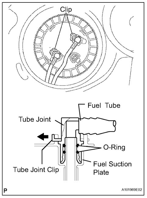

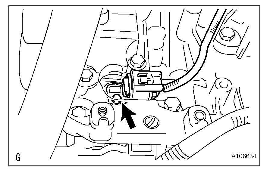

3. CHECK FUEL PRESSURE (HIGH PRESSURE SIDE)
pic 3
b. Start and warm up the engine.
c. Run the engine at idle.
d. Select the following menus: DIAGNOSIS / ENHANCED OBD II / DATA LIST / FUEL PRESS.
e. Check the high pressure side fuel pressure.
Fuel pressure:
3.5 to 4.5 MPa (35.7 to 45.9 kgf/sq.cm, 508 to 653 psi)
If the pressure is not as specified, check the fuel pump, high pressure side fuel pump, fuel pressure sensor and wirings.

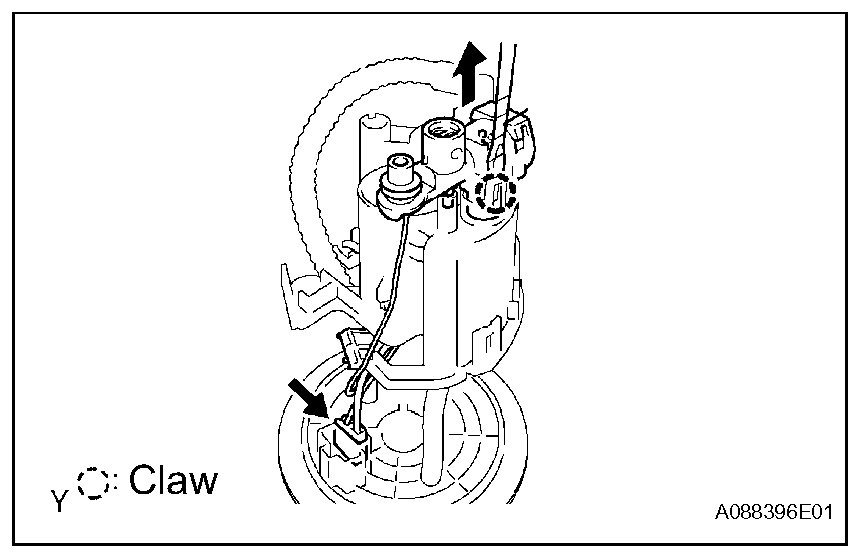

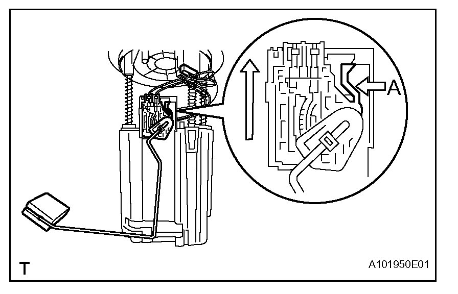

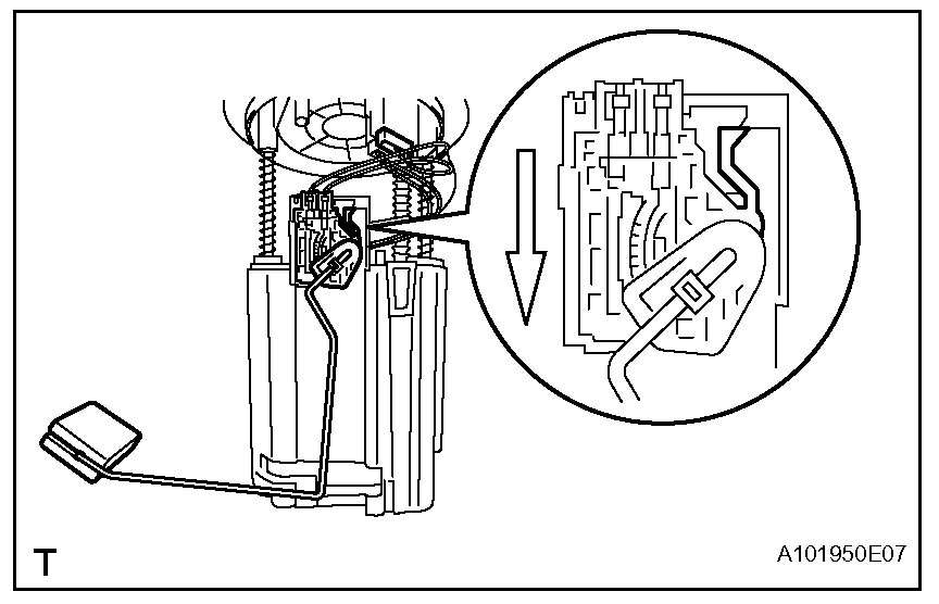

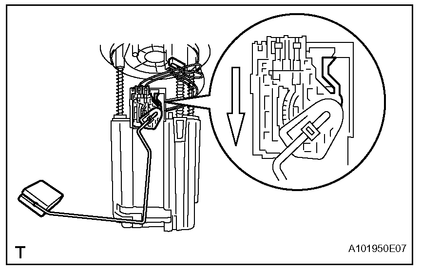

1. REMOVE FUEL SENDER GAUGE ASSEMBLY
pic 4
a. Disconnect the fuel sender gauge connector.
b. Press down on the sender gauge claw labeled A.
Then slide the sender gauge upward.

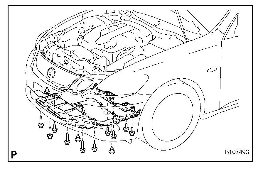

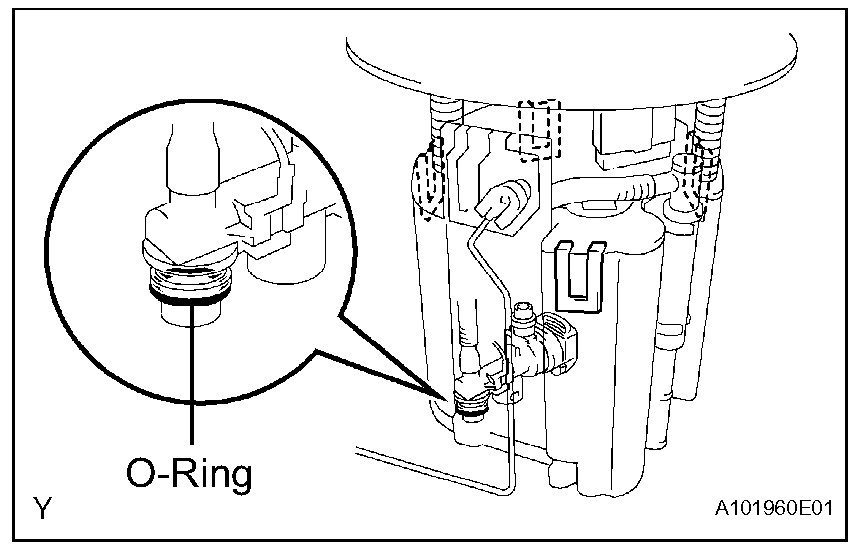

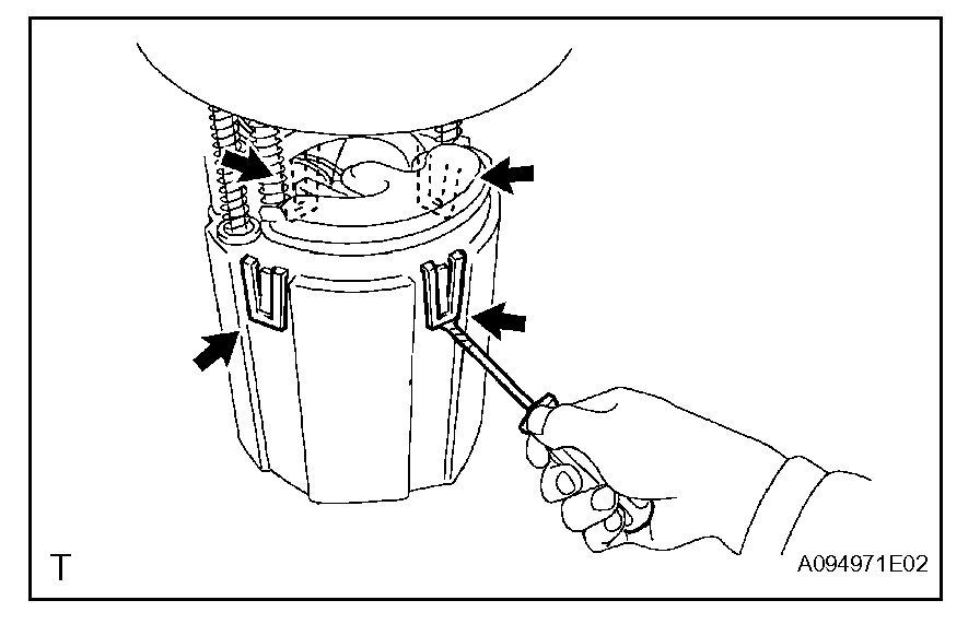

2. REMOVE SUB TANK SUB-ASSEMBLY
pic 5
a. Using a screwdriver, detach the 4 claws from the claw holes and remove the sub-tank.
HINT: Tape the screwdriver tip before use.

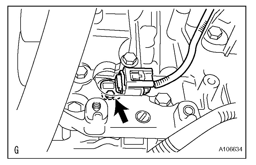

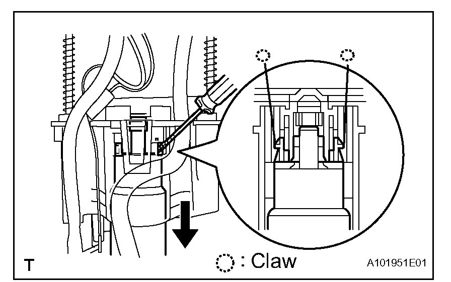

3. REMOVE FUEL PUMP ASSEMBLY
a. Disconnect the fuel pump connector.
pic 6
b. Detach the 2 claws from the claw holes and remove the fuel pump.
c. Remove the fuel pump filter seal from the fuel pump.
d. Remove the fuel pump spacer from the fuel pump.

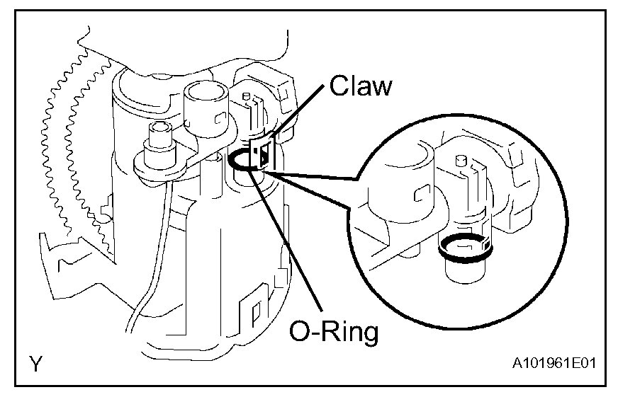

4. REMOVE FUEL RELIEF VALVE ASSEMBLY
pic 7
a. Disconnect the fuel pump connector from the fuel filter.
pic 8
b. Using a screwdriver, detach the claw and remove the relief valve.

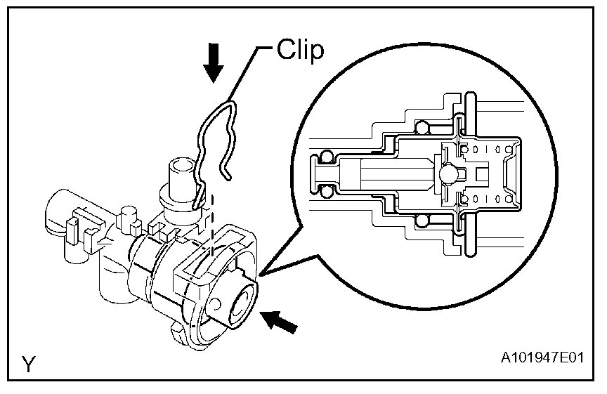

5. REMOVE FUEL PRESSURE REGULATOR ASSEMBLY
pic 9

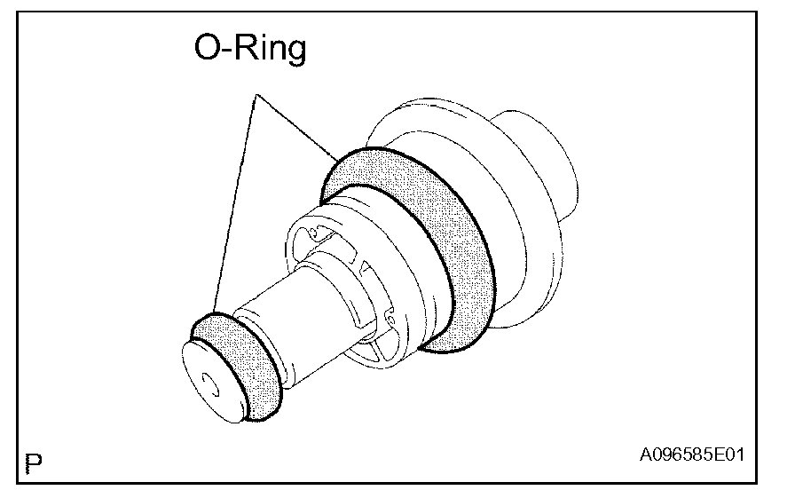

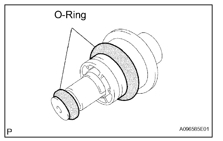

a. Remove the clip and fuel pressure regulator from the relief valve.
pic 10
b. Remove the 2 O-rings from the fuel pressure regulator.

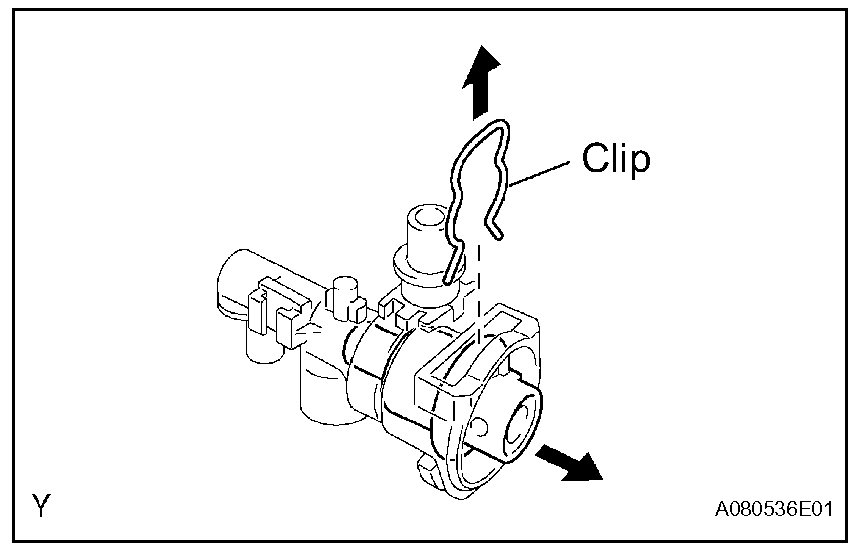

REASSEMBLY
1. INSTALL FUEL PRESSURE REGULATOR ASSEMBLY
pic 11
a. Apply a light coat of gasoline to 2 new O-rings, and install it to the fuel pressure regulator.
b. Install the fuel pressure regulator to the fuel relief valve.
pic 12
c. Install the clip to the relief valve.

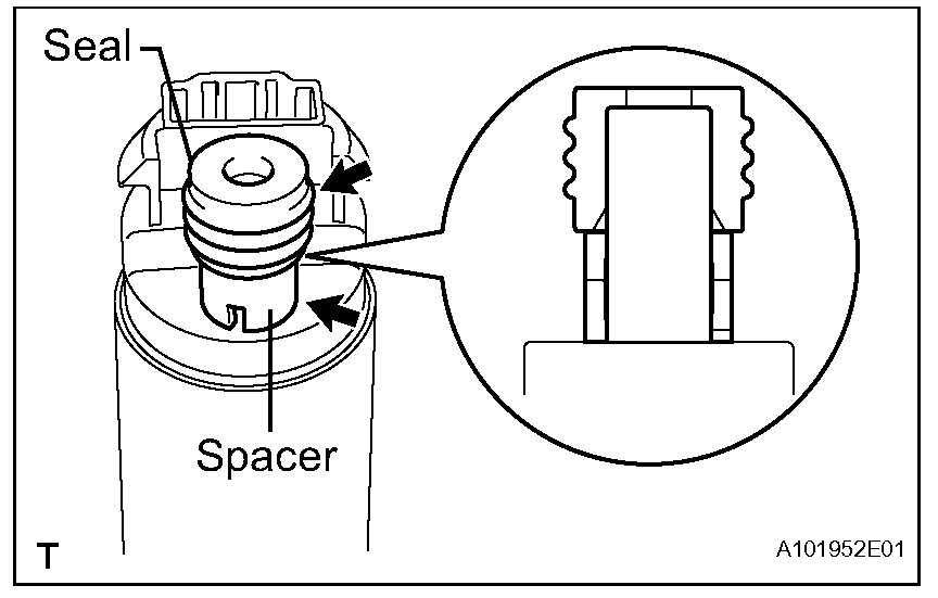

3. INSTALL FUEL PUMP ASSEMBLY
pic 14
a. Install the fuel pump spacer to the fuel pump.
b. Apply a light coat of gasoline to a new seal, and install it to the fuel pump.

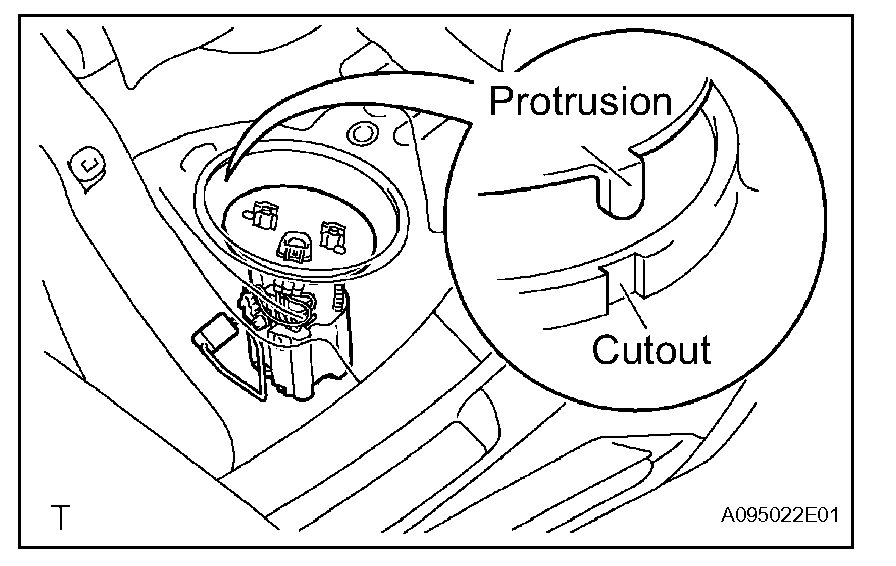

c. Align the protrusion of the fuel suction tube and the cutout of the fuel tank.

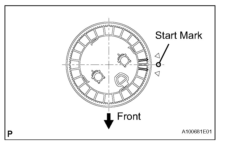

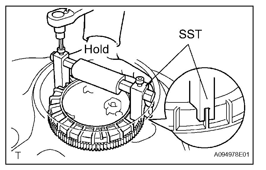

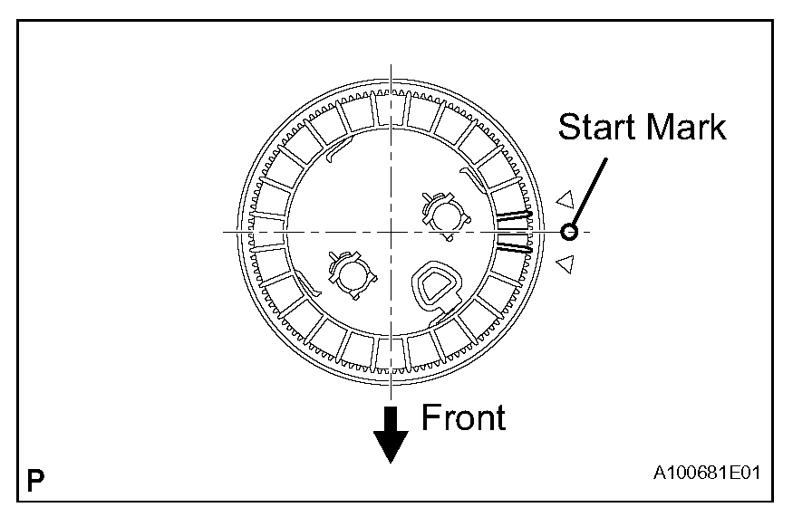

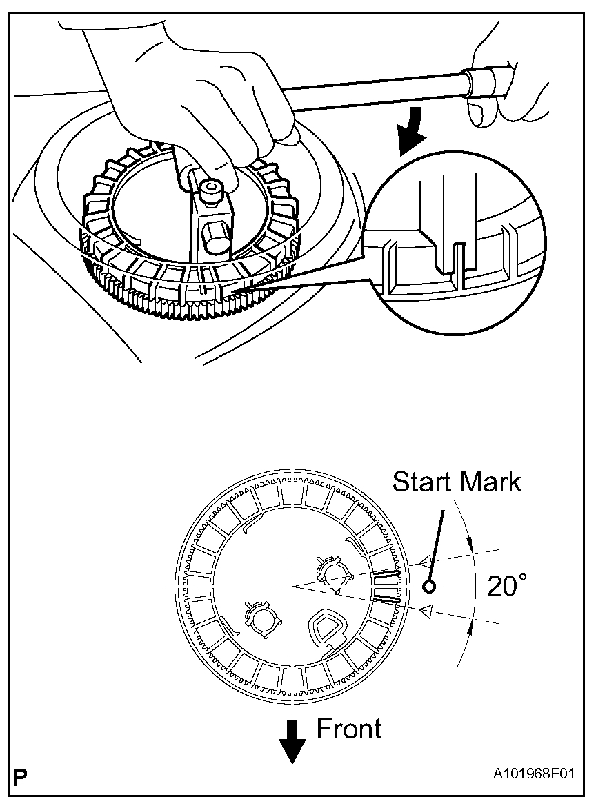

d. While holding the fuel suction tube by hand, align the starting marks of a new fuel pump gauge retainer and the fuel tank. Install the fuel pump retainer to the fuel tank.
pic 19

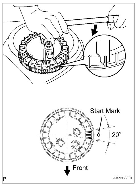

e. Using a 6 mm socket, set SST to the fuel pump gauge retainer.
SST 09808-14020
HINT: Fit the tips of SST on the ribs of the retainer.
NOTE: Use SST. Do not use any other tools such as a screwdriver.
pic 20
f. Hold SST with one hand and use SST to tighten the fuel pump gauge retainer 2 turns so that the starting mark on the retainer is within the indicated range in the illustration.
pic 21

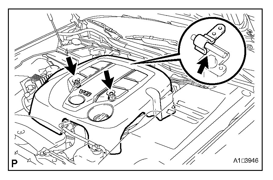

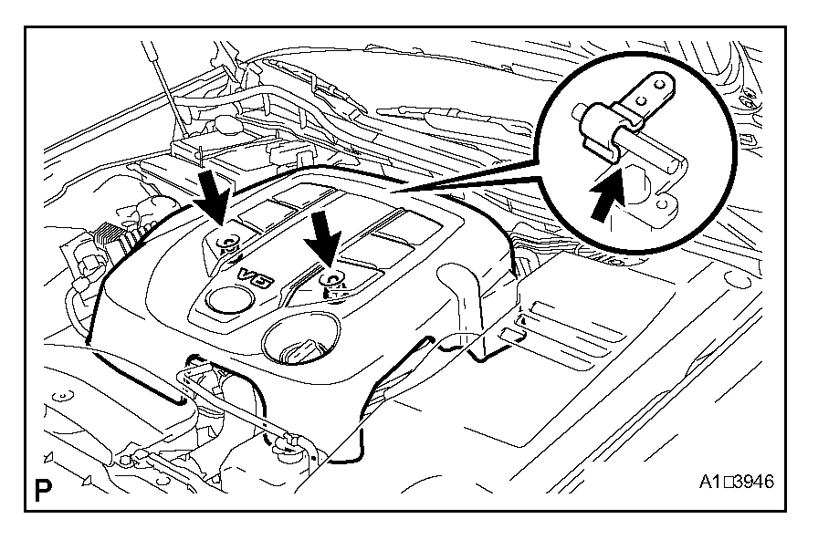

6. REMOVE V-BANK COVER
a. Remove the 2 nuts and V-bank cover.
