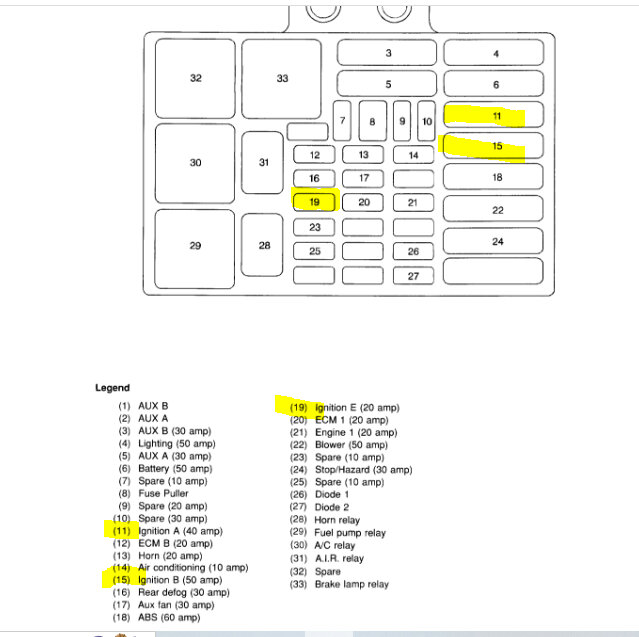

I bought a new fuse box because my fuses would burn out as soon as I turned the ignition. I bought new fuses, but it continued to do the same thing. So, I bought a new fuse junction box. I replaced it and now the fuses don't burn out but now 3 fuses in row from left to right starting with 10A IGN do not light up with my tester and the car will not turn on. So, I figured changing the crank shaft censor would be the problem, so I replaced that and it still not turning on. I also checked the driver side fuses and there are 3 rows that are not lighting up on my tester as well.

I attached a pic below of the under-hood fuse/junction box. There are three ign fuses, but none have a 10-amp fuse. Could you copy my pic and highlight or circle the fuses in question?
Let me know. This way I can work backward to see where power to the problem area is coming from.

See pic below.
