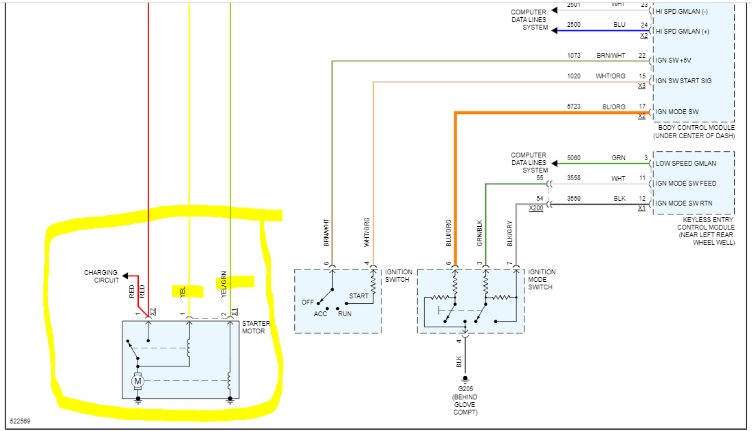

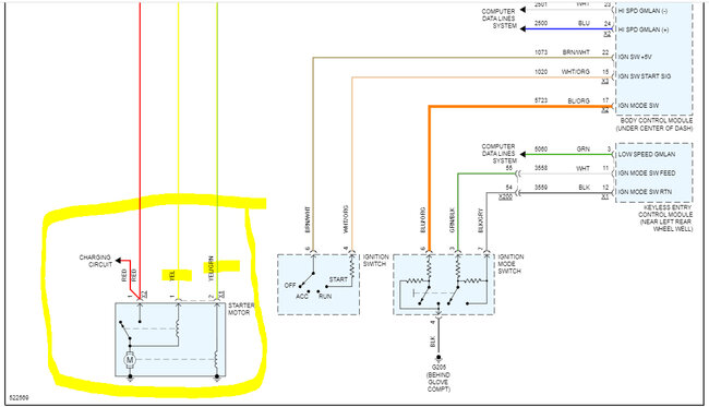

My coolant reservoir was cracked and after I replaced it my car wouldn't start again. So, I bought a new starter motor, new alternator with belt, and a new battery with new ground wires but when I go to start the car nothing happens.
Oct 23, 2022 at 2:31 PM
  • 110,244 POSTS

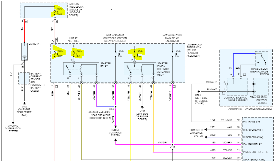

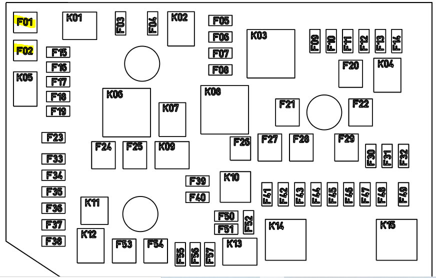

When you turn the key to the start position, do you hear a click or anything? I attached the wiring schematic below for the starter circuit, so you have a reference. I need you to check the fuses I highlighted.
Let me know what you find.
Oct 23, 2022 at 3:03 PM
KYNANSTEARNS
My fuse box is set up differently. I don't know what I'm looking at with the pictures you sent. I can send you pics and videos to help and show you what my display reads.
Oct 23, 2022 at 10:35 PM
  • 110,244 POSTS
Absolutely, that would be helpful. I'm not sure why the fuse box is different. Are you checking the one in the engine compartment?
