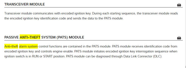

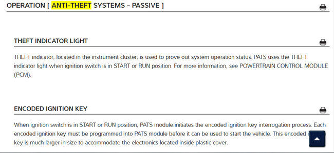

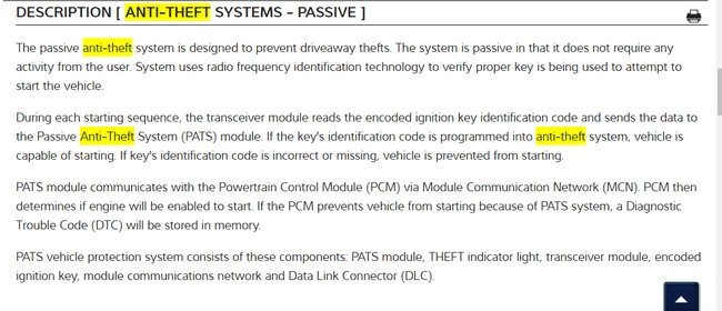

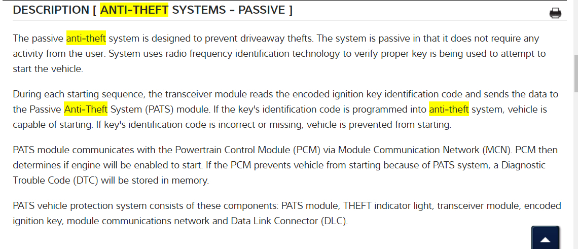

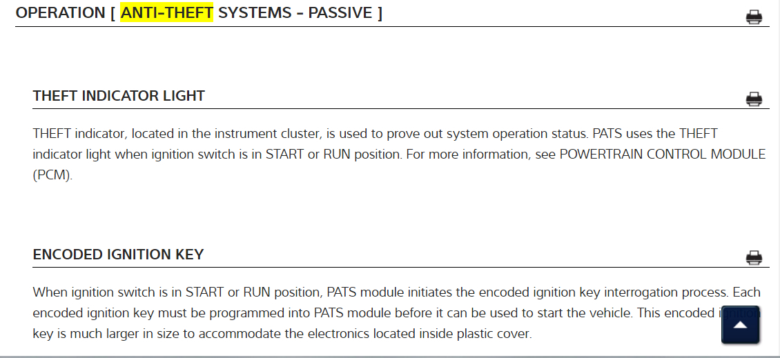

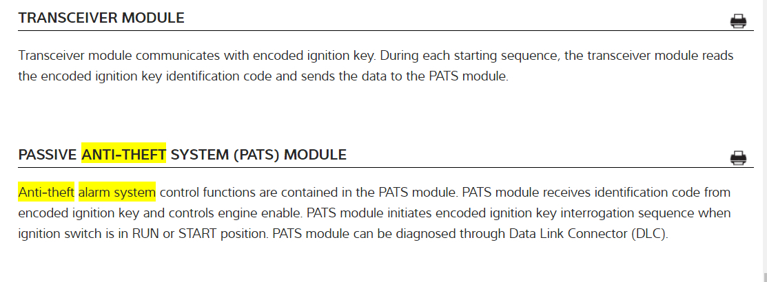

CHEN1989

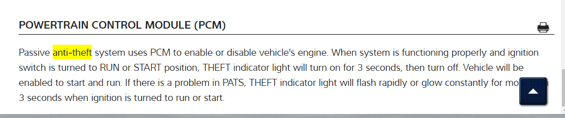

I had the steering column replaced and i re keyed it. I assumed the battery was dead after the steering column was replaced, so i tried charging the battery. when i put the key the windshield wipers the windows and the radio works but no dash lights and it wont turn over. When i turn it to the off position the radio and windshield wipers and even the headlights will stay on without the key in the ignition. Should i replace the battery? Or and ignition switch or a fuse?
Apr 21, 2019 at 7:31 AM
SCGRANTURISMO
  • 4,897 POSTS
The reason that your vehicle will not start is because of it's Passive Anti Theft System (PATS). You will have to have your new ignition key programmed to the PATS module by either the Ford dealership or a locksmith. These are the only two that have the ability to do this. It is done that way as a safety precaution so that people can't steal your vehicle.
Your vehicle uses a chipped key and there is a transponder ring around the ignition lock cylinder that acts like a radio receiver. There is a transponder chip in the key that acts like a radio station. If the code from the key dose not match the one programmed into the PATS module it will not send the start signal to your vehicle's Power-train Control Module (PCM). The PCM controls your vehicle's engine, allowing it to start and run. I have included a description from the Ford Motor Company on PATS operation in the diagrams down below.

There is a PCM relay I want you to check, also is the security light flashing when you try and start it? Here is a wiring diagram to help you see the system and what should have power. Please check all fuses. If okay I would suspect the crankshaft angle sensor. Here are some guide to help us get the problem fixed.
