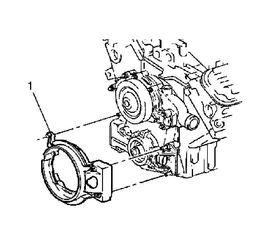

I changed the alternator and the ignition modulator and still will not turn over. There is not also a strong smell of gas when you try to start the car.
Dec 9, 2018 at 5:37 AM
  • 110,248 POSTS
Since you are smelling fuel, I have a feeling you lost spark. First, check to see if there is spark to the plugs.
If there is no spark and you have a live data scanner, check to see if there is an RPM signal when the engine is cranking. If none, suspect the sensor.
If you determine the sensor is the problem, here are directions specific to your vehicle for replacement. The relearn process will follow the directions. Note: The attached pictures correlate with these directions.
CRANKSHAFT POSITION (CKP) SENSOR REPLACEMENT
REMOVAL PROCEDURE
1. Disconnect the negative battery cable.
2. Raise and support the vehicle. Refer to Vehicle Lifting.
3. Remove the right splash shield cover.
4. Remove the crankshaft balancer.
See pic 1
5. Disconnect the crankshaft position (CKP) sensor electrical connector.
6. Remove the CKP sensor shield (1).

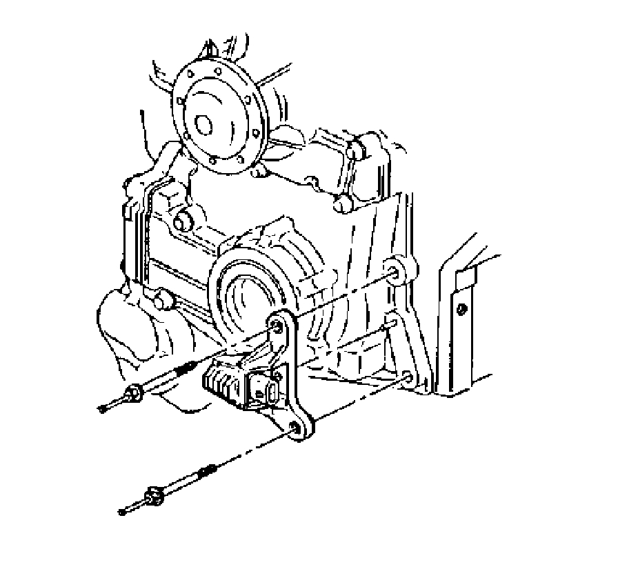

7. Remove the CKP sensor bolts.
See pic 2
8. Remove the CKP sensor.
