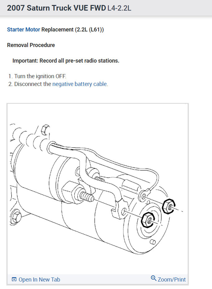

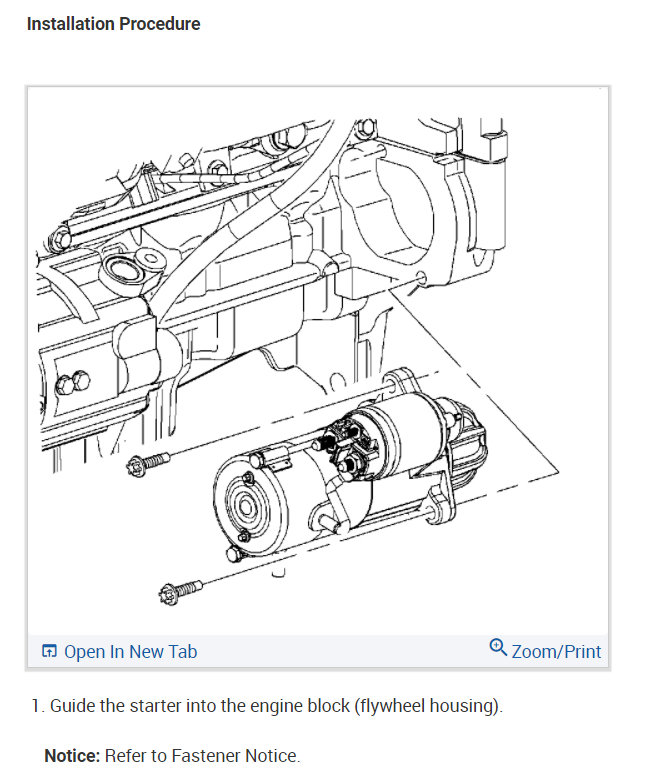

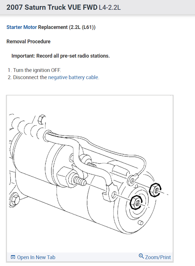

LEONSBE
i thought my battery was bad because it barely turned over then clicked and then nothing. so i put a brand new battery in yesterday and the same thing happened all lights are bright but just wont turn over.
Feb 9, 2021 at 2:35 AM (Merged)
  • 55,748 POSTS
It sounds like the starter motor has gone bad. I would go over this guide to be sure and if so get a AC Delco unit. Check for power at the trigger wire.
Here is a guide to help you step by step with instructions in the diagrams below to show you how on your car:

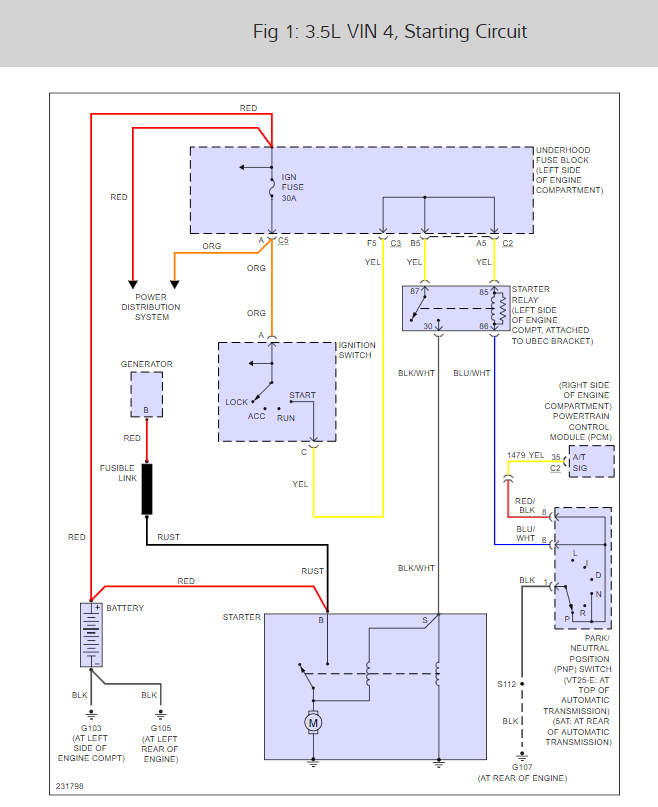

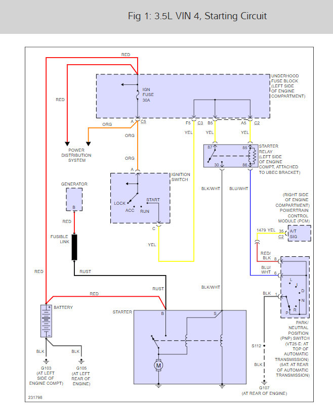

MIKEFRESH911
I first thought it was alternator and replaced it but it was not the problem. A wire from starter to alternator burnt so replace wire but after doing so battery will not charge car and jumping it only revs it. It wont turn over.
  • 55,748 POSTS
There is a starter relay that needs to be checked. Here is a guide to help and the location of the relay as well as the starter wiring diagrams so you can see how the system works:
Starter relay - left side of engine compartment, attached to UBEC bracket.
This guide can help as well:
Check out the diagrams (below). Please run some tests and get back to us.
