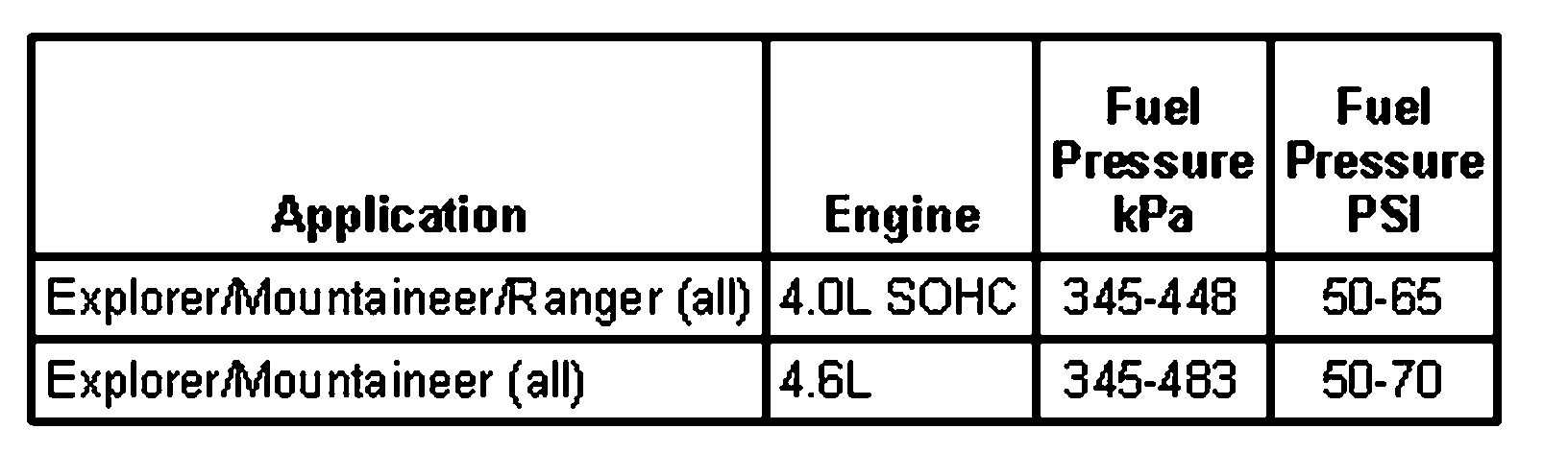

Pic 1 below shows the manufacturer's specifications for fuel pressure.

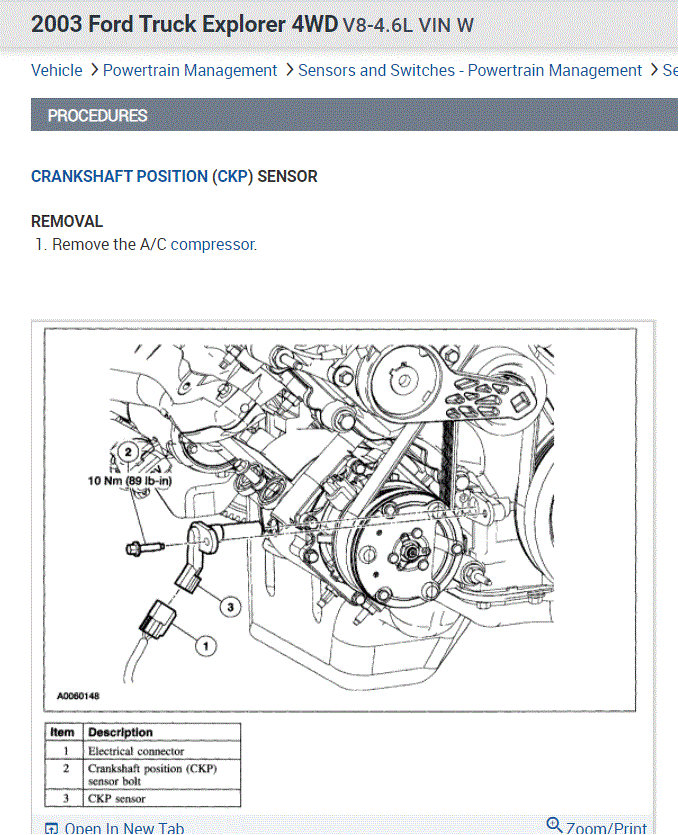

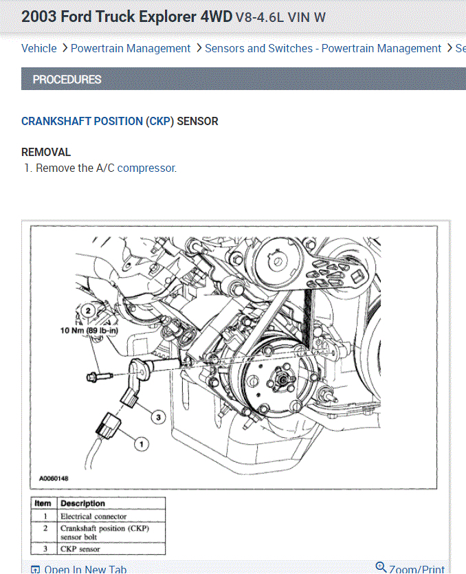

If you find there is no spark, I suspect it could be a bad or faulty crankshaft position sensor. Take a look through this link. It explains common symptoms of a faulty crankshaft position sensor.
If you have no spark and that link mirrors what you experience, here is a link that shows in general how one is replaced:

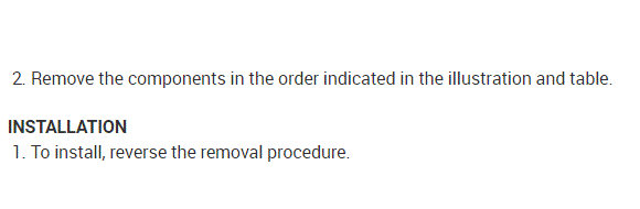

If you find the sensor is bad, I attached the directions and pics below specific to your vehicle for sensor replacement. See pics 2 and 3.
