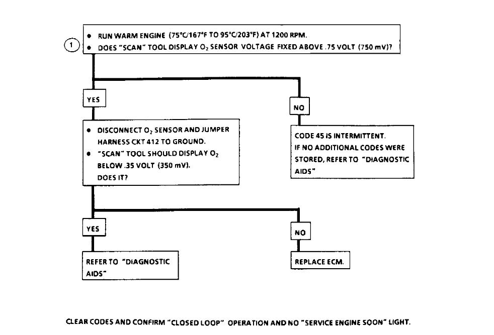

Today I unplugged the vacuum line from the MAP sensor and now the car will run but sputters while driving. If I close off the hose for the Map sensor the car dies but if I allow it to have a small vacuum leak there it will run. Idles pretty good that way and revs OK in park but sputters some going down the road. Gives me a code 45 for high MAP sensor signal voltage which makes sense because the voltage decreases from 5 volts as vacuum is applied. If I unplug the electrical connector from the MAP it dies. This problem makes no sense to me. But sense it's running now I suspect the crank sensor and ignition circuits are OK. The way I discovered this was I took the throttle body off and cleaned it some, when I re-installed it I forgot to plug the MAP sensor vacuum line back in, the car started better and idles and runs.

Check for a vacuum leak, when you unplug the vacuum you put the car into open loop and it runs rich. The code 45 would come on because you have unplugged the sensor. Check the wires on top of the tbi unit for making good contact. I stil think you should get the ignition module checked as well. Clear the computer then see what happens and see ifyou get any codes instead of blindly guessing this or that which you have done enough of already.

I'm sending a flow chartfor code 45 onhow to diagnose it as it cold be the ecm. Ckt 412 means to unhook the O2 connection as it leads back to ecm. However also check resistance of crank sensor and cam sensor. Also if you can have your ignition module checked as this supplies voltage for tbi. And check ground at engine block and battery to body.

I have replaced the ECM with one from a salvage yard. This has fixed the issue.
