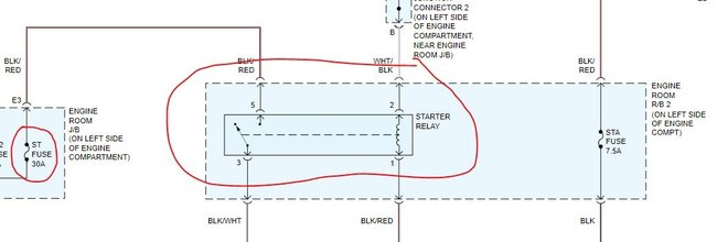

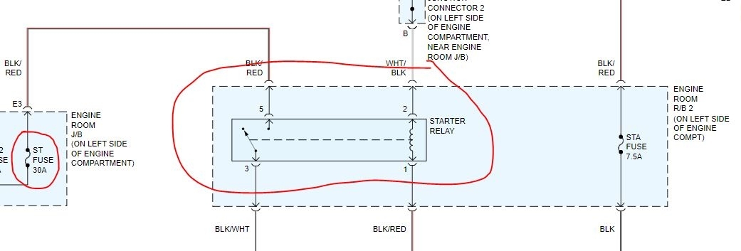

First, see if it will start when you shift to neutral. If that does nothing, I need you to check the fuse indicated in pic 1 as well as the starter relay.
Here are a few links to help:
Now if you don't find any issues with the fuse or relay, I need you to check if power is making its way to the starter. Here is a link explaining how that is done:

I have checked all fuses , got my battery checked, turnkey on anti theft system light goes off but battery light is on now. I have been trying to find the starter relay and can’t.

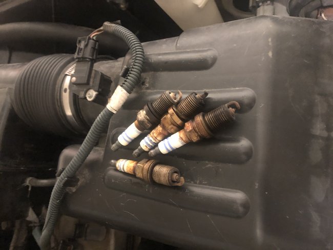

Okay, I’m going to remove them today. I removed them yesterday to replace them and some of them have oil on them and two of them were split.
Oct 22, 2019 at 1:39 AM
  • 110,240 POSTS
Welcome back:
Let me know what you find. Also, if it still doesn't crank with them removed, see if you can turn the engine by hand at the crank pulley. If you have a socket and breaker bar, it should be easy to turn with the plugs removed.
